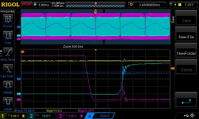

On an other note can I add my 2c on the recent discussion on mosfet switching speeds that seems to conclude "faster is better"?
There is an effect called dV/dT switch on. This happens when the drain sees a fast change in voltage. The Gate:Drain capacitance also sees this voltage change and so it causes a voltage rise on the gate, sufficient to cause the mosfet to conduct to some degree.
dV/dT switch-on is caused by the gate being driven too fast.
I have seen this in my two inverters (the prototype and a commercial board obtained from aliexpress)
It is not due to too small or too long deadtime. One reason I built the prototype was to see the effects of deadtime on dV/dT and there is none.
I could vary the DT from 0.5us to 2us continuously via a trim pot while seeing gate voltage and DC bus current on the oscilloscope. There was no reduction of this problem with changes to DT.
Why care about this anyway? The full bridge design means that when a mosfet is off we want it to really be off. The dV/dT switch-on means cross conduction will occur.
When under large loads, I wonder how on earth our inverters survive when they are shorting the DC bus 20,000 a second, albeit for 20ns or so at a time.

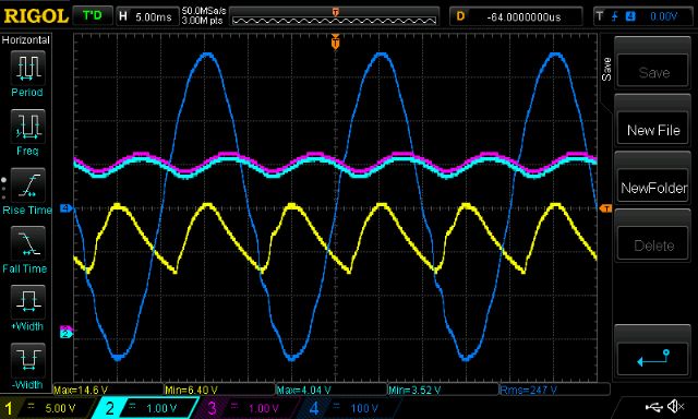

here is my Vfb setup. This probably will not be suitable for your situation.
Do you have an oscilloscope?
I really recommend using one when playing with home brew inverters.
If you do not have one, I suggest the Rigol DS1054Z which can be hacked to 100Mz and run all optional add-ins. I can help with hacking (or check out EEVBLOG)
Cost is $570+GST. Geez they've gone up a bit since when I got mine.
I took a 9V unregulated plugpack out of it's plastic case.
This gives me a ready made 240V AC -> 9V DC sub system.
The diode bridge uses 1N5391 diodes and a 10uF cap.
Then I divide this nominal 9V output with 470R and 270R resistors
with the 270R connected to ground and divided output at the join of 270R and 470R
resistors.
V div is 270/(470+270) * 9V = 3.3 Nominal at 240V AC
I intended this to be connected to an Arduino ADC input which can take 0 - 5V so 3.3V is nice with plenty of headroom if I let the inverter run a bit high.
The EG8010 needs 3.0V so you would use a trim pot to give 3V.
The divided 3.3V is then fed into a low pass RC filter, 75K resistor and 33nF cap
This smooths things a fair bit.
Right at the Arduino ADC input pins I have another LP filter with 100R and 0.1uf.
This still permits a little AC ripple.
(why two filters? I want to investigate the effect of noise etc on Vfb and the PID loop control behavior with the prototype Adrduino controlled inverter. I have a long pair of wires conveying Vfb past the FET bridge picking up masses of EMI. This is by design.I want to see how much filtering is needed. And how much EMI mucks up the control loop...)
Warpspeed suggests 1N4148 diodes and I agree these will be fine for the purpose.
https://www.jaycar.com.au/1n4148-1n914-signal-diode-pk-5/p/ZR1100 cost $0.60 for 5
Thanks Madness for the supurb document linked above. That is a keeper.
above shows (Yellow) the "9V" output with huge ripple due to too small 10uF cap
Pink is after the 75K, 33nF LP filter
Light Blue is after the 100R 0.1uF final filter
I use 2 filters for my particular needs in testing EMI noise effects upon the control loop.
Finally for those interested in dV/dT turn-on I show this:
Yellow is DC bus current
Dark blue is AC output
Pink is low side HF gate drive
Light Blue is high side HF gate drive.
Note how the low side gate easily gets to 4V which is well within the gate threshold voltage of the IRF3808 mosfets I am using.
When this happens there is a small peak in DC bus current.
This is dV/dT turn-on.
I'm not sure about how much of this is interesting to you all. Please tell me to STFU if it's too much.

The problem with having a 10uF capacitor after the rectifier is that it will respond quickly to sudden voltage increases, but not so quickly to sudden voltage decreases.
If you reduce the capacitance, or load down the output, the ripple value increases.
Cascading filters just adds to the overall delay.
The best "technical" solution to all this is to just run a straight rectifier with light resistive loading.
At every zero crossing, the output waveform from the rectifier goes right down to zero.
Then follow that with a very sharp cut off low pass filter that has a good flat frequency response up to several Hz, then drops like a rock to have very high attenuation at the 100 Hz ripple frequency, and above.
You will get dead smooth dc out, but any disturbance in amplitude will give a pretty rapid step change in the dc output level, both increasing AND decreasing.
This will have the fastest response with the least amount of ripple and noise on the output.

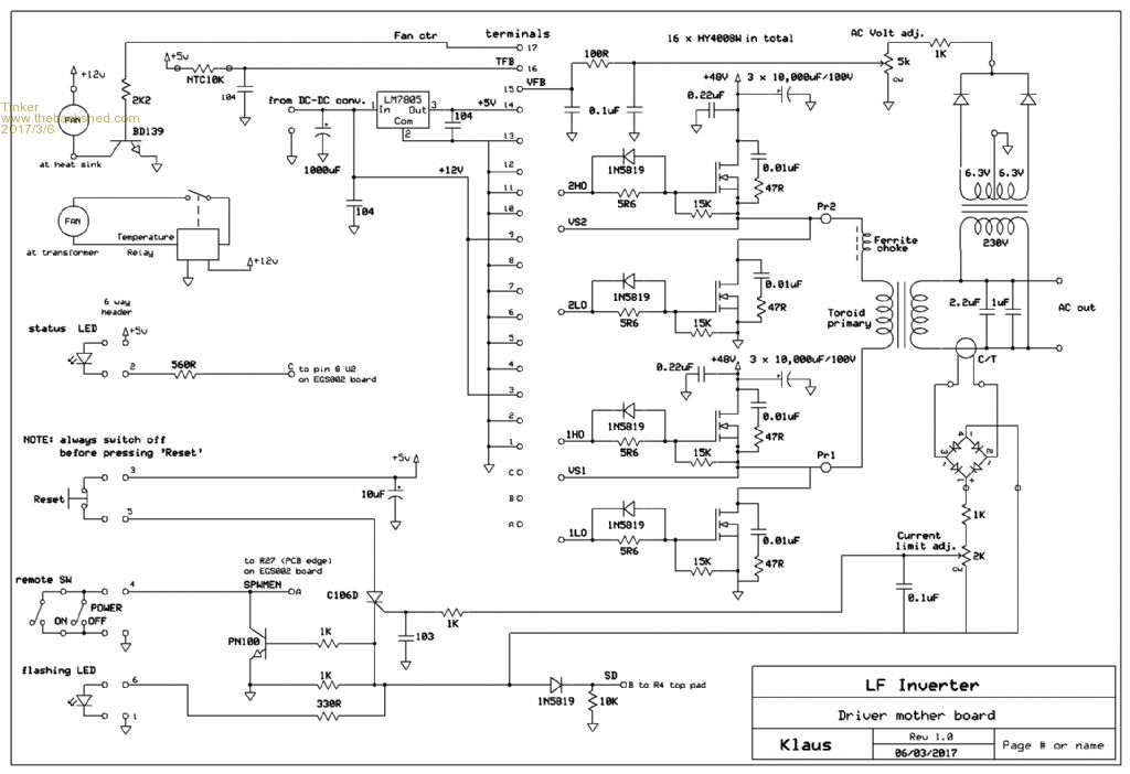

Posted: 12:13am 06 Mar 2017
Great guys, keep that thread going, 30 pages already & counting .
I made some more adjustments to the inverter control with regard to the VFB voltage source that is being discussed at present.
Here is the latest updated schematic:
You'll notice I used a center tapped secondary transformer to get the VHF voltage.
This give me a nice 100Hz ripple that goes down to 0.1V and with a peak of 3.1V.
The diodes are UF4004 BTW.
Now, while I could not manage to kill a Mosfet all day while experimenting with this I wonder if its *really* necessary to add lo pass filters.
The ripple has a 20KHZ 'ringing' very short spike on it, about 1Vpp. Would not a notch filter be more suitable to get rid of that - if it needs to be got rid of in the first place.
I'll continue trying to get it to misbehave.

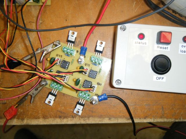

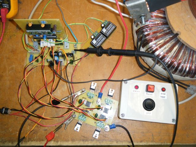

Here is a pic of my new test rig, it works so well I will recommend it for newbi inverter builders:
Notice I made a box that mimics the inverter control switches, very handy.
A close up pic:
It can easily accommodate TO220 Mosfets by splaying the outside legs a little.
Once I have a batch of chips that passed my soak test - I'm using 65V DC which is about 10V higher than my battery bank - Load testing will commence. Very gently this time .

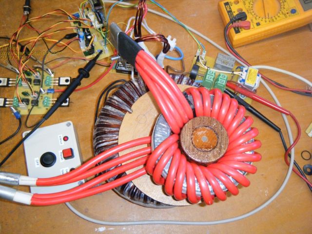

Lastly, my ring ferrite primary choke. Wound 4 in hand of 20mm sq cable. It makes no noise at all while doing my no load experiments.
