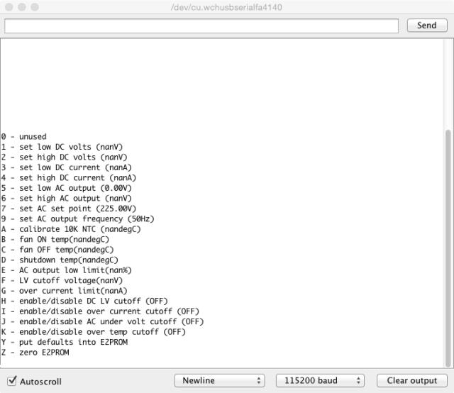

Tinyt:
Your circuit is looking great.
Here is some progress in the code.
It is not ready for testing by others. The calibration values have no effect, etc.
But I want to show where I'm heading.
I have E2PROM read & store working, as well as the i2c LCD.
Expect significant changes as I work through this.
Interestingly, I have dispensed with the low pass filter applied to
the AC output.
I wonder if we need a potentiometer to set the AC output voltage.
Why not just use a number, stored internally to set the output voltage?
We can change that easily via the serial console.
Speaking of which:
Here is video of the LCD display, showing dummy data for DC volts, DC current, DC watts and temperature. It shows the calculated output AC voltage and above that
the AC setpoint. The Fluke DMM is there to keep it honest.
Notice the nice waveform.
here
and the code, for a good laugh is
2018-11-15_205654_uno_inverter_wg_sine_i2c_1.ino.zip Edited by poida 2018-11-16
That is a good idea, set point is really just a number. Saves one pot and 1 pin for other purpose.
Poida, what is the difference between "Low AC ouput" and "AC output low limit", and also "Low DC volts" and "LV cutoff voltage"?
Posted: 01:22pm 15 Nov 2018
Could you elaborate what you physically mean by "serial console"?
Having built several of these EG8010 based inverters and two running my house I'm always interested if they can be improved. And your and wiseguy's 2 sine wave method does show its possible.
Presently my inverters have an on/off switch and a reset button on top for controls. Did you mean the nano version should have an external USB port so it could be pre set even if its works are housed fully enclosed inside the inverter?
You see, I'm looking at this from the practical user side, not the breadboard version.
