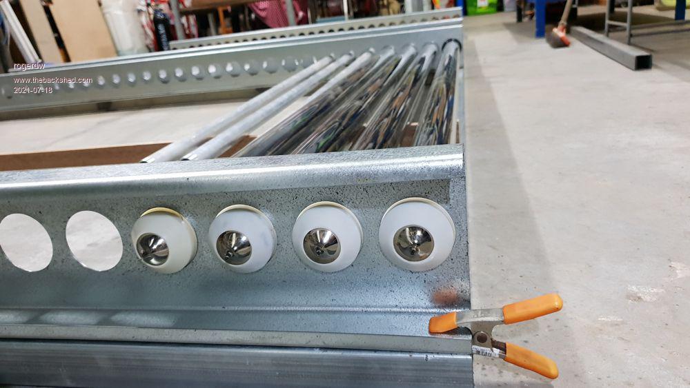

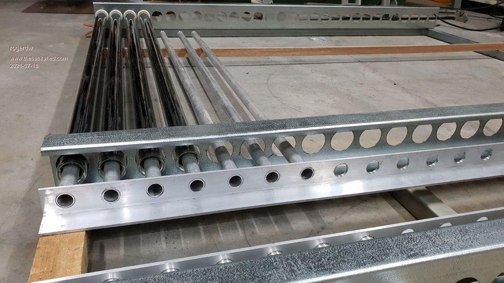

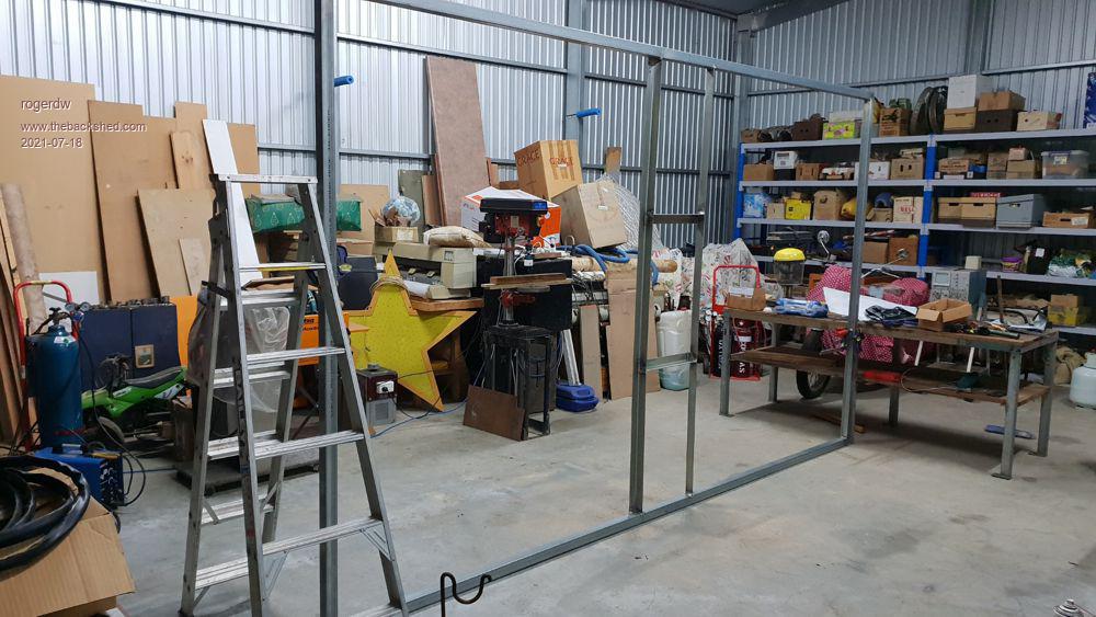

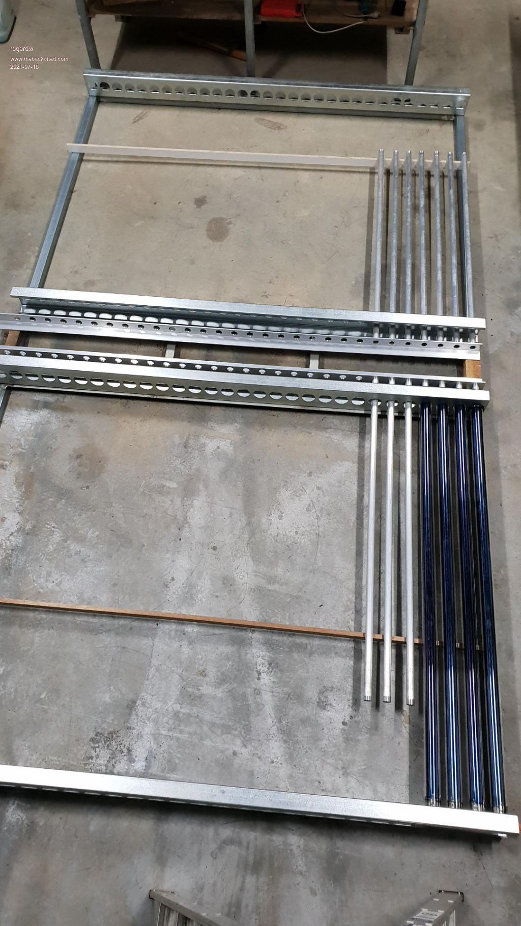

I finished welding up the base frame  ...  it's pretty big  ...  and if I stand on my tippy toes I can just touch the top  ...  though not as heavy as I first thought it was going to be.
I reckon I should be able to drag it up on the roof if I lay a protective mat over the gutter first  ...  and have someone down below to help lift.
I tried a dry assembly to see if everything fits where it's supposed to and thankfully no surprises so far.
Will drill all the assembly holes and weld a few captive nuts in place so it can be reassembled easily on the roof  ...  then start chasing the sheet metal that I'll need.

Here's some photos to show the progress.
Cheers,  Roger

That is a truly amazing piece of fabrication work there Roger.

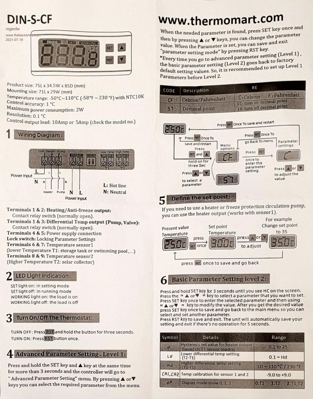

Did your Chinese differential temperature controller ever arrive ?

Wow!
That puts things in Perspective as to the size of this setup.... and your Shed! Mancave jealousy there for sure!
I agree with Tony, that's a great and substantial bit of Fabricobbling and very professional looking as well. Wish I had some Skills and was clever.
Looks like it's going to kick out a lot more heat than the calculations suggest.
I can see this ending up in self sufficiency type magazines and websites.  Make sure you comb your hair and polish your shoes when they come round for the interviews!
Won't be hard picking your home on google earth that's for sure.
I was up the back yesterday looking at that Gal channel. The stuff I have is the same profile and looks similar Gauge but the holes are much larger and further apart so I doubt would have been any help. Probably more a frustration of the near miss.
Very impressive work Roger! I wouldn't worry about how the welds look too much, people are going to be far too blown away with the look and size of the thing to even notice or be worried about a detail like that. Might be a lot of work but I am certain the satisfaction and independence you and the family get out of it will be worth it 100X over. Being passive it will also save you endless work in the future with the wood cutting.
Your son will probably be doing projects on it at school and he or you going up there and talking about it.  I got asked to do that a few times with the veg oil thing and this is way more interesting and up to date.

Thanks Tony, it's certainly turned out big  ...  and I am happy with the way it's going, apart from being all too slow.

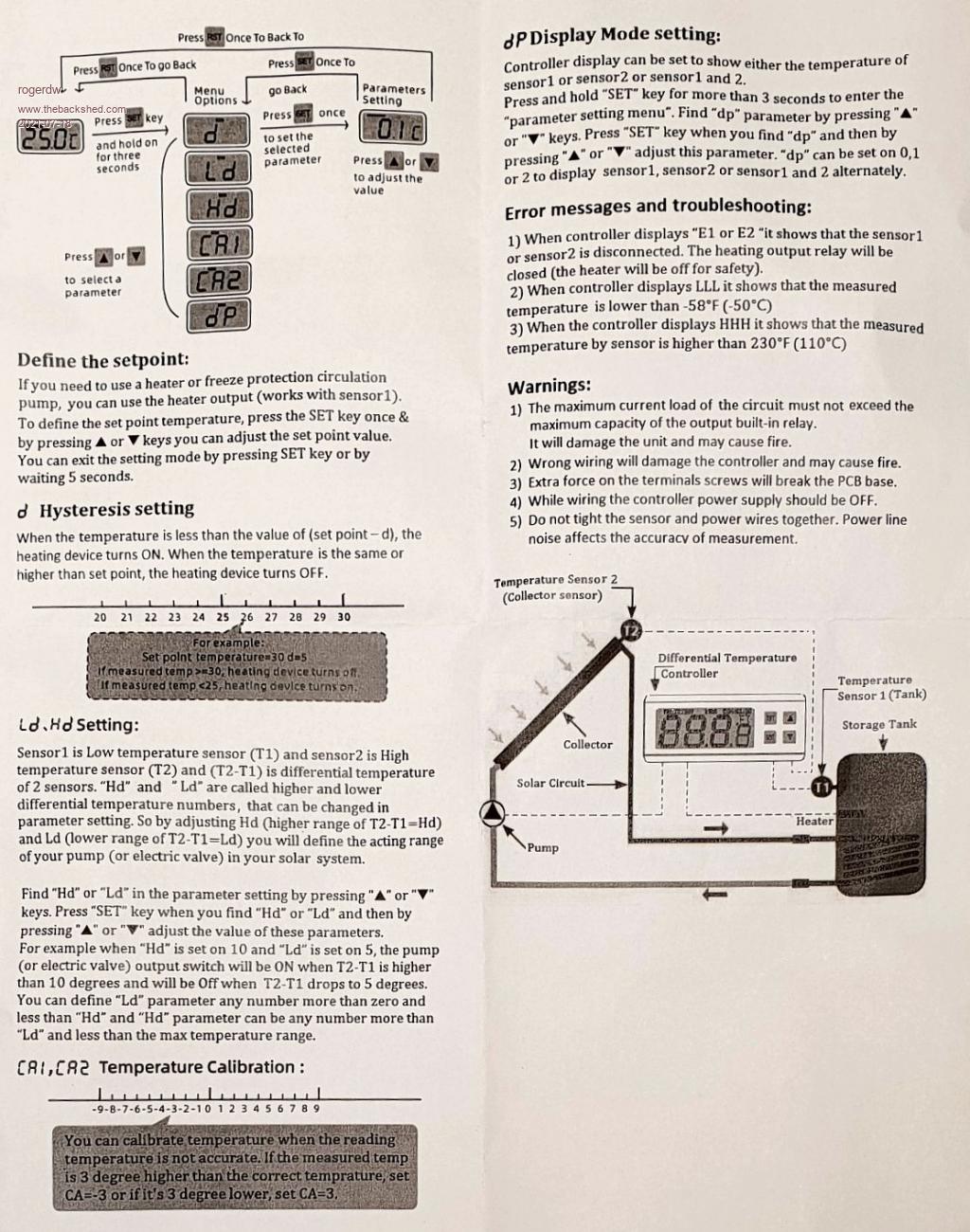

The controller turned up during the week, but I really haven't been able to work out yet how to make use of it. Have to decypher the instructions somehow.

Haha, thanks Dave. I do keep thinking I may have overdone it a tad  ...  but if I'm gunna build something, it has to have a good chance of performing well.
  Quote   and your Shed! Mancave jealousy there for sure!
Thank you. Very pleased to have found this place with sheds already attached  ...  big house but even bigger sheds  ...  and wife loves the place.
I need to learn to throw stuff away though, or sell it  ...  would give me twice as much room to work in.
  Quote  I agree with Tony, that's a great and substantial bit of Fabricobbling and very professional looking as well. Wish I had some Skills and was clever.
Thanks mate, I've been a bit surprised myself at how it's turning out  ...  very happy. And don't cut yourself short, I've seen enough of your youtube videos to know you have some pretty decent skills yourself  ...  between coming up with ideas and then proving or disproving them  ...  and then improving on the good ones.
My biggest problem, as we've discussed before  ...  is I have to have every little detail worked out in my head before I lift a spanner  ...  otherwise I won't risk starting a project. Means I do a lot of thinking and very little of anything else.
  Quote  I can see this ending up in self sufficiency type magazines and websites.  Make sure you comb your hair and polish your shoes when they come round for the interviews!
Haha, my cynical self doubts they'd even be interested, but maybe there would be some interest. Hope it works then  ...  or I'll look really silly.
  Quote  I was up the back yesterday looking at that Gal channel. The stuff I have is the same profile and looks similar Gauge but the holes are much larger and further apart so I doubt would have been any help. Probably more a frustration of the near miss.
I did wonder how close it might be, but was bound to be something that would make it unsuitable. Luckily I shouldn't have to do that part again  ...  and I can't see myself making another one in a hurry.
It certainly didn't need to be that heavy a gauge  ...  but I couldn't find anything lighter weight to substitute.
The other thing is the aluminium tubing  ...  mine has 2mm thick walls, where .5 or 1mm would be plenty stong enough  ...  but finding something cheap there has been difficult.
  Quote  I wouldn't worry about how the welds look too much, people are going to be far too blown away with the look and size of the thing to even notice or be worried about a detail like that. Might be a lot of work but I am certain the satisfaction and independence you and the family get out of it will be worth it 100X over. Being passive it will also save you endless work in the future with the wood cutting.
Yeah, just thankful I have an angle grinder to tidy up some of the worst ones.
And you're right about the long term value  ...  there's no reason this couldn't run for 50 years. May need a new fan motor one day  ...  but nothing to wear out  ...  just free heat whenever the sun is out. Perhaps the electronics  ...  that'd probably be the weakest link.

I believe that controller will make a VERY big difference to your results.

Yes it should, if I can ever work out how to apply it. It seems to work backwards for what I need.
What I would like to do is have it off until one sensor (inside the tubes) reaches say 40 degrees  ...  then turn on the fan.
As long as the second sensor can reach (quickly) and then stay above say 25 degrees  ...  then the fan can stay on  ...  but as soon as it drops below that  ...  the fan should go off.
I'm feeling a bit thick  ...  does it look like this can do that, or do I need to add some extra logic?
Cheers,  Roger
