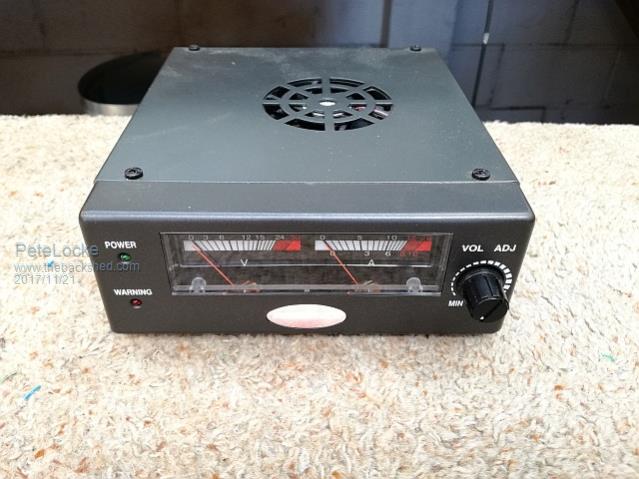

I bought some time ago a 30v 10a supply

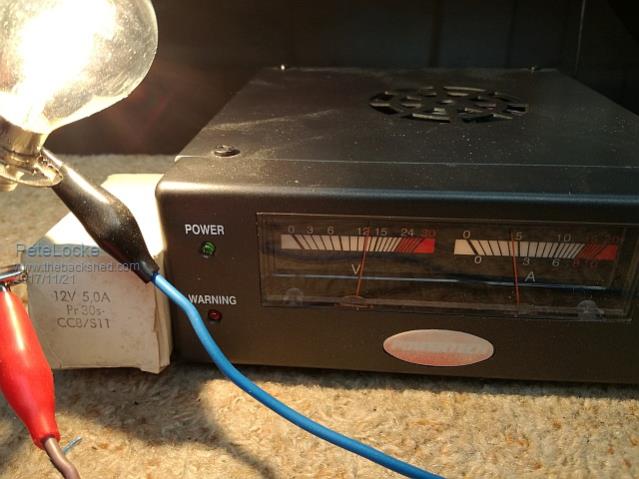

Think it was off TradeMe or something similar. No current regulation. But that's only an issue to sort out "Back Shed" style. My Brother used to work for an outfit that had a contract, amongst other things, of changing out the light house lamps around the South Island. Nothing wrong with the bulbs, but as a preventative maintenance thing they were changed out. Guess were all the 'old' ones ended up . Bulbs...oops...Lamps are one of THE most useful limiters/fault indicators ever created. Wouldn't be a week go by when I don't have one in place of a fuse looking for a fault that would otherwise see you back to the board to put in another one. Wiggle the wires in the suspect area, the light glows letting you know you're close .
Almost close enough to agree with the re badged amp meter in the supply
