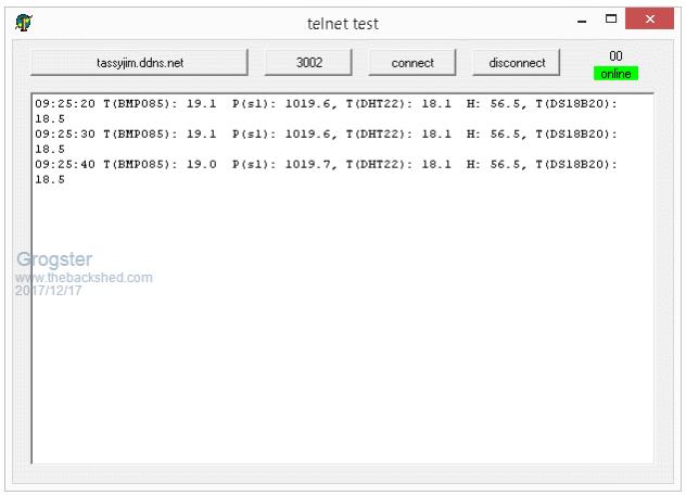

here we go, give this a try:
2017-12-16_233249_test_17_telnet_client.zip
this is a very simple telnet client (dumb terminal, no VT100 emulation), just for testing out the code. if you click on 'connect' it will connect to tassyjim's micromite, or you can enter an alternative host and port.
note: this is not derived from GFXterm, it is just a few delphi components thrown together. the file "unit1.pas" contains most of the relevant code, do have a look. if/when it works ok, i can transplant the mechanics into GFXterm.
rob :-)

Posted: 01:48pm 16 Dec 2017
That worked flawlessly rob. Nice work.

Posted: 09:00pm 16 Dec 2017
  robert.rozee said  if/when it works ok, i can transplant the mechanics into GFXterm.
Works fine here.
Tested it on both my internal IP range 192.168.xxx.xxx to a few devices that are all internally on port 23.
Also tried to connect to them by using my public IP & the forwarded ports, to loop out then back into my router & that worked fine too.
When you are at the stage to test in with in the main prog, you're welcome to give it a go on the MM+ that has an SD card in it if you want to test an over internet download of one of my logs.
Phil.
Edit:- You'd just need to change to 4 in the port# to a 1.Edited by Phil23 2017-12-18
Posts: 10056
Posted: 10:29pm 16 Dec 2017
Works for me.
TT still refuses the connection with timed-out messages. I'm not too worried about that though, as there are alternatives to TT.

Posts: 2552
Posted: 03:44am 17 Dec 2017
it looks like telnet can be as simple or as complicated as one wishes. i suspect that teraterm is adding in extra complication at some level, and the other end is then failing to handshake on some request.
all i've implemented in the above test code is a dumb "Network Virtual Terminal", i don't even generate or process any telnet commands. the enter key is translated to CR+LF, everything else is passed straight through.
grogster: could it be that your install of teraterm is trying to negotiate a username/password login?
rob :-)
