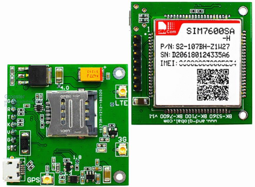

Scratching my head all day today, I could not work out why I could talk to this thing with a PC COM port, but NOT the MM no matter what I did....
I finally managed to work out that this cased-up version has a FULL COM port, in that ALL the pins are used. So if you are missing DTR, CTS, RI, DSR and DCD, then the modem won't talk. It took hours of scratching my head before I twigged that might be the case. It works when directly connected to the PC, as the PC's COM port will have all those handshaking lines and will take care of all that in the background for me I expect. When I put it back on the PC COM port and sent it a text message, that one along with about three others that never arrived before were all sent to the PC. That will be cos the DTR line is being used as a minimum. I tried to hot-wire a permanant DTR line to the module, but that did not work, so it obviously wants the other pins too. If you look at the image of the guts of this unit I posted further up this page, you will clearly see that ALL eight lines to the DB9 are routed via some kind of 232-TTL level shifter.....
I have purchased another module to play with, more suited for embedding in products.
Link to new module I will play with next.
This one is based on the newer SIM7600, and is the SA variant for Australia, New Zealand and South America. Should work in NZ and Australia right out of the box. Supports 3G, 4G(LTE) and GPS as well. U.FL connectors for all three types. So, this one supports more modern networks, is only 40mm square, and has a simple three-wire serial connection on it. Whatever needs to be hard-wired for the handshaking will be done on the PCB with this one I expect.
The experimentation continues......

Normally to ignore hardware handshaking and assert control you would connect (for a DB9 RS232 connector) 3 pins together on one link and 2 pins on antoehr link:
Pin 1 DCD to Pin 6 DSR and to Pin 4 DTR;
Pin 7 RTS to Pin 8 CTS.
Pin 2 is RXD and Pin 3 is TXD, Pin 5 is GND and Pin 9 is RI.
Usually enables data to flow so you can just send and receive on the data lines.
What chip is U1 on the bottom of the PCB. All of the serial port pins appear to go there. There might also be an issue with the voltage levels for RS232 vs Serial TTL.
It looks like you might be able to easily bypass that chip and just connect serial TTL from the MM to the other side of that chips connections.
