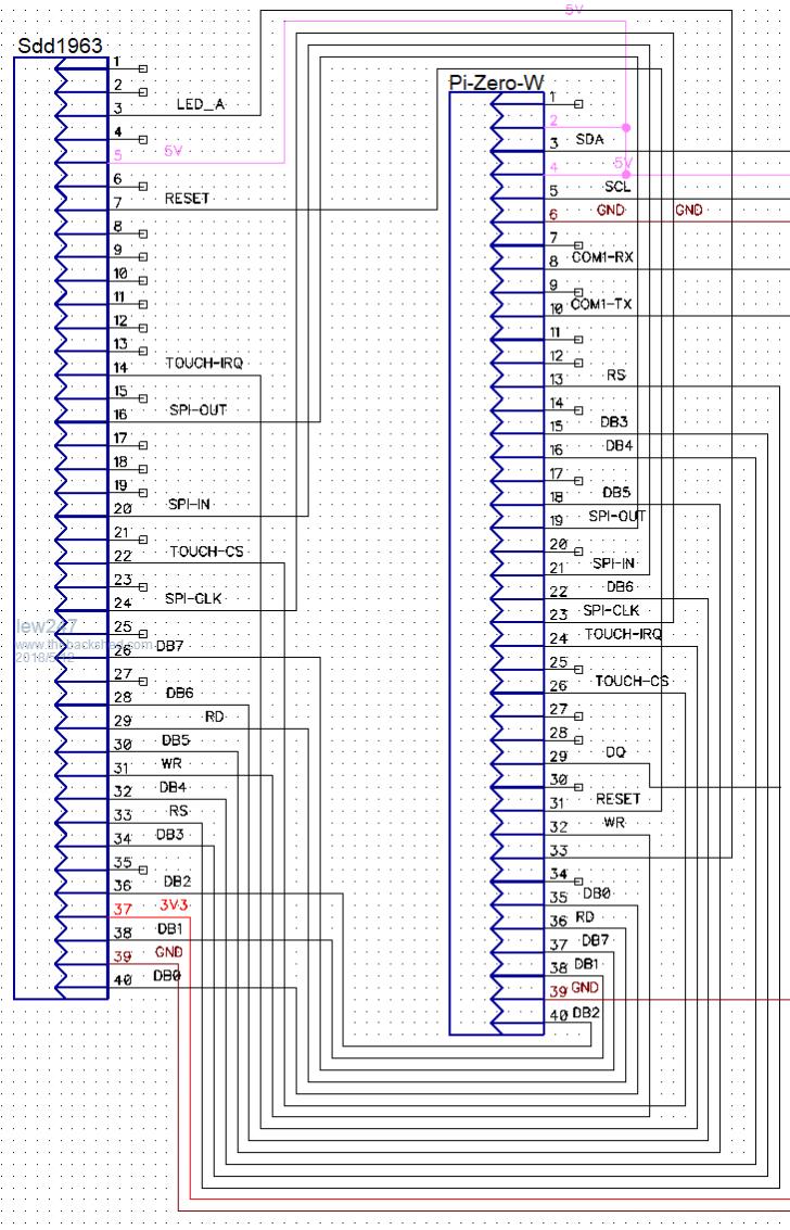

I've just got a Pi Zero W and I'm trying to make a board to plug it onto the back of my SDD1963
I know Grogster designed a board for this, but I want it for one specific purpose with just a couple of bits attached in specific places and while his board is amazing, it won't serve my purpose
Would anyone mind checking my circuit and tell me if I've made any mistakes please?

Hi Lewis,
I have just made a similar thing with veroboard.
I don't think you will need the LED-A connection as you will strap the SSD1963 for PWM mode.
The CS pin 11 on the SSD1963 should be tied to GND so it permanently selected.
Can't see anything else.
I connected power to the Pi and used its 5v to power a separate 3.3v regulator for the 3.3v to the LCD as mine is a 5" which powers the the backlight from its 3.3v supply and I though this may be too much for the Pi regulator.
I think with the 7" most power to the LCD would come via the 5v supply and the 3.3v current would be minimal and could be supplied by the Pi regulator, so what you have might be OK.
Someone who knows more about the 7" power usage might chime in.
Will you be having the SSD1963 and the pi mounted on opposite sides of the board?
Gerry

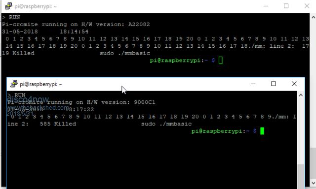

A screen shot of an error I am am getting when mmbasic drops back to linux. Just putting it here so Peter can see it. Have PMed him with how I manage to achieve it but can't put a picture in the PM.

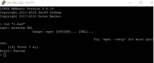

For some reason with the latest version, anytime I'm using the system command and the code for the pi is wrong and throws an error the pi completely locks up and has to be rebooted
lew247
Joined: 23/12/2015
Posts: 1709
Posted: 06:04pm 09 Jun 2018
This is what I mean, I know what I did wrong
but I cannot do anything with the Picromite or Pi itself until I reboot the Pi
Posts: 11961
Posted: 06:09pm 09 Jun 2018
Please PM me with your code (including the key) and I'll have a look
