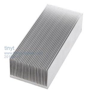

I was able to buy from ebay four 150x69x37mm heatsinks. Free but slow shipping, but I am not in a hurry.
I hope it is adequate. Dense fins - efficient heat dissipator and dust catcher. I don't know how thick the base is, I still have to figure out how to bolt it edge-wise thru the PCB. I might still want to experiment on the flimsy angle bar sinks to find out how much load it can tolerate.

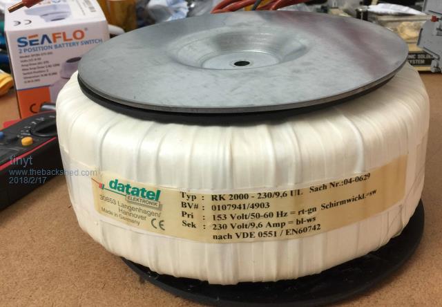

The 2.2 KVA toroid I ordered from ebay came.
It might be light for others but it is already too heavy for me. I guess I need to take idle power measurements, turns/volt, etc. before I hack it. If the secondary is wound first, I will attempt to split the winding in two to get double 115 vac sections without unwinding it to save on labor. I hope my arthritic fingers can still do the unwinding and re-winding.Edited by tinyt 2018-02-18

Mounting the heat sinks is easy, just drill and tap them with M3. even the 12 FET version easily supports the heatsink, I just put a perspex sheet on tap to stabilize it and it is solid.

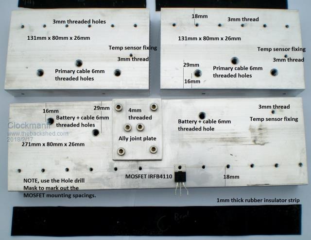

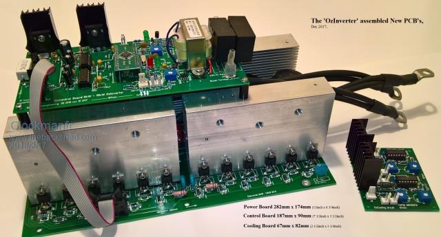

You have probably seen these before.
This is the most used method for heatsink mounting and compactness, but sufficient clearance distances and spacing for ease of construction and longevity.
The heat sink gives rigidity to the double copper thickness, and double sided PCB Power board as its nearly A4 size.

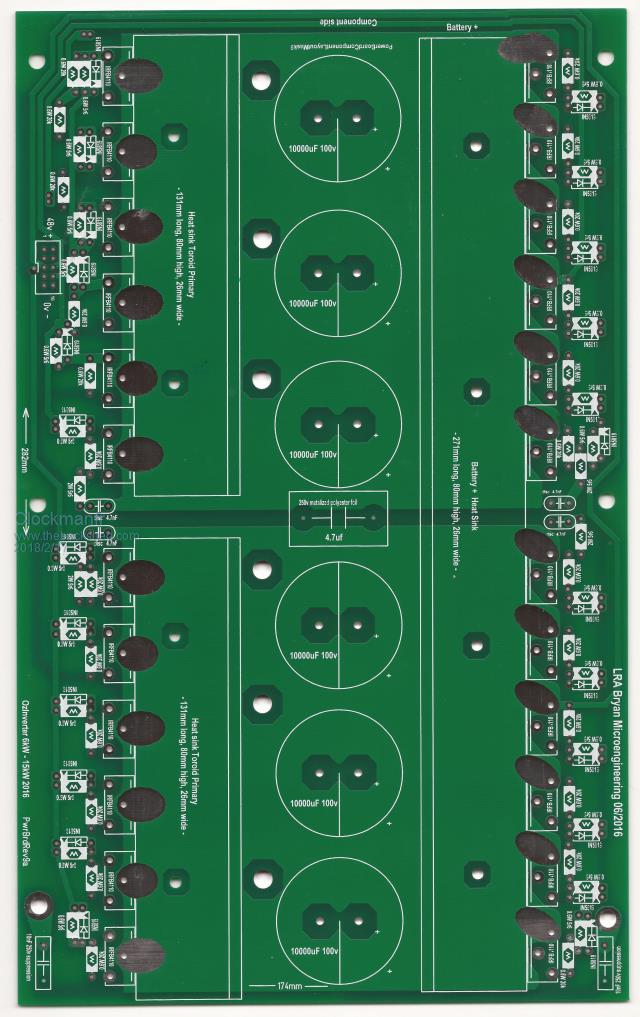

tinyt
Joined: 12/11/2017
Posts: 564
Posted: 11:41pm 16 Feb 2018
Thanks Madness and Clockmanfr.

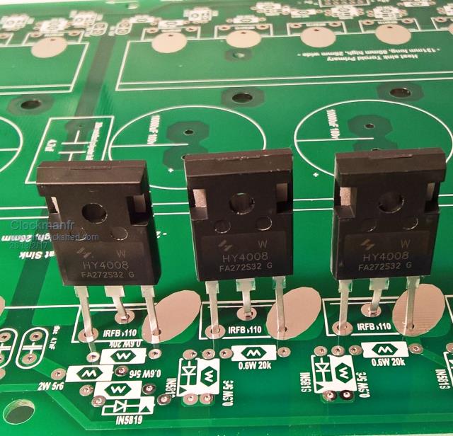

Those pictures are great and clarified a lot of things for me. I assume that the tapped holes (4 for the long heatsink, and 2 for each shorter heatsink) for PCB mounting are on the fin at the edge of the heatsink. The fins of the heatsink in the picture look to be thicker and can be tapped to take the screw threads, but the ones I ordered look very thin. I don't know how many threads it will hold. Maybe I have to carefully drill and tap thru several fins to make a solid mounting. Also I thought that the heatsink particularly the long one has no insulator at the mounting surface and just relied on the soldermask. Thanks for telling me to use perspex (acrylic sheet?) or rubber strip.
One question. The 3 legs of the mosfets are in-line when received, but the picture shows the outer legs to be bent forward/outward. Is it to allow more copper to surround the source and drain legs of the mosfets?Edited by tinyt 2018-02-18

The 3P package of the HY4008 MOSFETs is designed to have the pins in a straight line, clockmans boards are designed for TO220 package MOSFETs as shown in the heatsink photos. You can bend the legs of HY4008's to make them fit but if you designing your own PCB you are much better off having the legs all in a straight line. They will then drop straight in and keep the legs as short as possible as they are designed to be used.
I was referring to using perspex on top of the heatsinks to keep them in a fixed position, rubber is suitable.

Got it on the Perspex. Clockmanfr's 'exploded' picture shows the black rubber strip placed near the heatsink mating surface for the PCB. So, two different things I think.
On the mosfets, even the 16 HY4008 oztules gerber shows them spread out. But per your advice, I will layout the PCB with them in a straight line. Thanks.

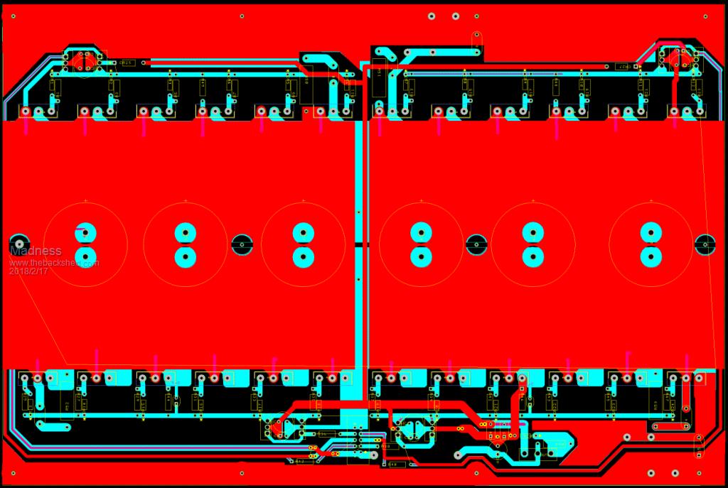

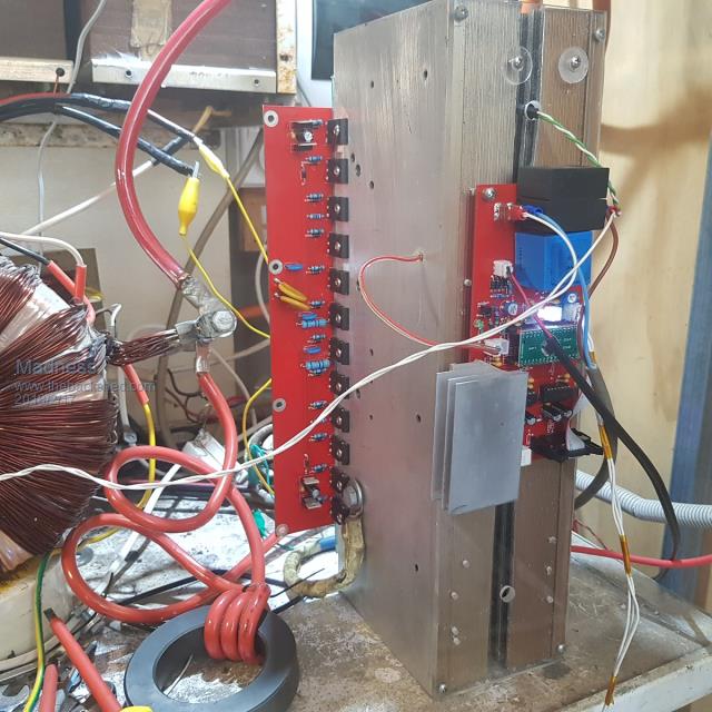

Here is one of my PCBs you can see the perspex on top of the heatsink and MOSFETs.
The bottom image is an earlier version, I have now increased the area not covered by the solder mask. So there is now a larger triangular area of solder around each leg to spread out the current. I have run this design at 8KW for 30 minutes with no problem. The PCB is 300 X 300 MM so that will give an idea of the size of the heatsinks, they probably don't need to be that big but what you see is the largest size that fits in the case.

Hi Madness,
Those heatsinks are huge. Without seeing your picture, I would normally bolt the heatsink to the PCB and mount the PCB/heatsink assembly by the mounting holes of the PCB. But your picture shows a different way. Attach the PCB to the heatsinks via the mosfets and their legs, no need for bolt holes on the PCB. That is how I interpret the picture. If the perspex is thick enough and made wider, and mounting holes are drilled at their corners then the entire assembly can be mounted to the cabinet via the perspex mounting holes. The screws to attach the perspex to the heatsink can be flat head nylon screws to isolate the heatsinks from the metal cabinet. Maybe metal flat heat screws will also work if their heads are covered with kapton or vinyl tapes. I like it.
Your toroid shows multiple strands for the primary (x in hand - is that how you call it?). That is also how I will do it on my toroid as my tiny hands will not be able to work the huge cables I usually see. So, it is OK to use no gap toroid for the series inductor?
Looks like you have discrete complementary transistors/mosfets for the gate drive of each group of HY4008. Will they be needed for a group of 5? Sorry for all the questions.
Thanks for the picture.Edited by tinyt 2018-02-18
Madness
Joined: 08/10/2011
Posts: 2498
Posted: 05:53am 17 Feb 2018
That toroid is something I threw together for testing only, welding cable with the only the inner silcon insulation is very soft and flexible, it is much easier to wind.
I am not with you regarding the perspex, I mount the PCB via the holes in the PCB, then all the connections need to be made, that would be impossible with a full width perspex and also leave the control board exposed.Edited by Madness 2018-02-18

The FET's legs are like the ones shown for the 4110's but the Power board will also take the larger FET's like the 4008 without any modifications. Just slightly bend the legs so the FET sits up flat against the heatsink.
See photo, 4008 FET just dry positioned for illustration purposes.
Originally I examined the available FET packages and allowed for several FET sizes.
For me its all about designing a PCB Power Board that will take a variety of differing size and type of components without the reliance on one particular size or brand.
In the very beginning of this OzInverter project we did not want to be subject to specialised specific components.
Yes, drill through a few of the heatsink fins and tap for the thread, I tap about 20mm in depth as a minimum. But watch the swarf from the drilling as it needs to be thoroughly removed, or else there could be a disaster if the bits of aluminium later drop on to the board.!

Hi Madness,

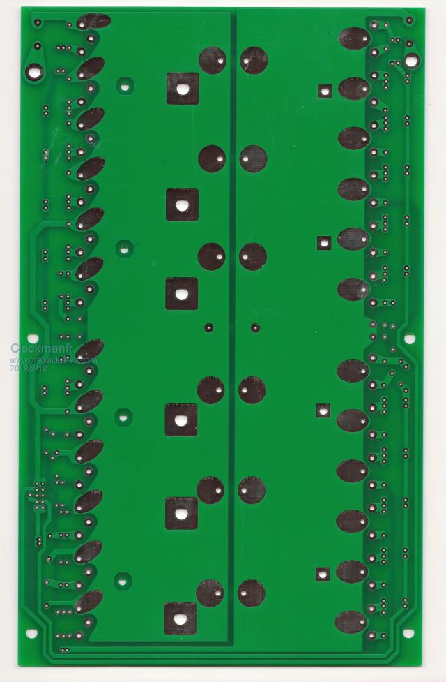

In your gerber picture, are the PCB mounting holes for the heat sink the four black holes that are in line with the large capacitors, or closer to the mosfets but only cannot be seen in the picture.
Hi Clockmanfr,
Now I understand. I agree the more universal the design is, the better. Are the oval solder mask to allow more solder and higher current flow for the source leg of the mosfets? Thanks for the reminder to remove debris and deburr after machining operation on the aluminum.

There are no heatsink mounting holes in my PCB they are not needed.
Yes the oval shape of the solder pads allows a little more solder to be added around the FET legs to spreading the loading onto the copper pinch areas.
Here is a photo of the underside of the OzInverter board, as you can see Ovals on those load pinch points.
Also in the Photo the 4 holes for the 48v + battery positive heat sink allow direct connection between the heatsink and the main copper on the under side, as in this photo.
I trust this helps?
