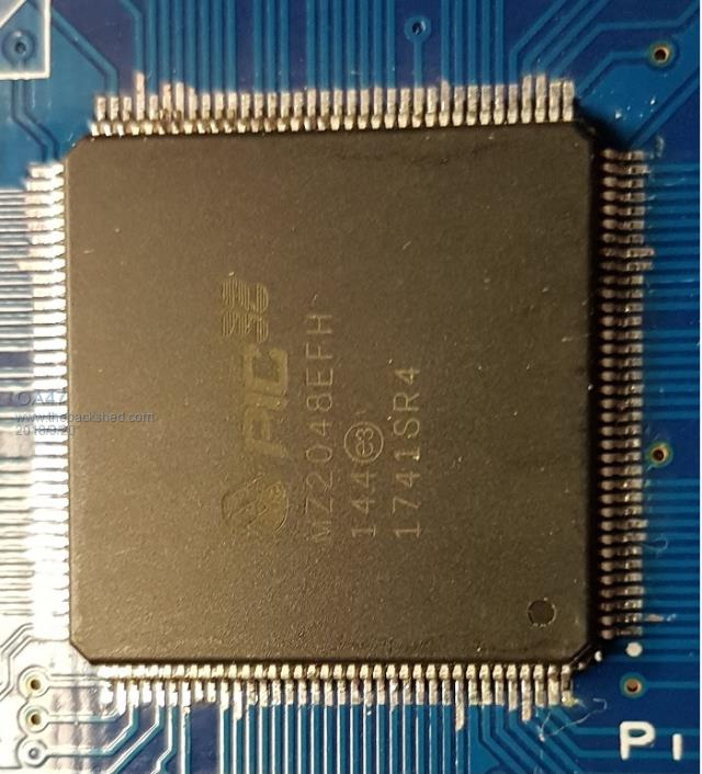

Sorry for asking this silly question - but I take it you are connecting the PickKit3 the correct way round? Pin 1 is nearer the I/O headers at the 'bottom' of the PCB - this needs to line up with the arrow (highlighting Pin 1) on the PickKit3.
Your photo above makes it look like there is minimal solder on the PIC pins. Have you tested continuity to the PIC Pin 'shoulders' rather than the PIC pads?
Run a wet iron on pins 37 and 38 (top right two pins in above photo).
Do you have a PIC16F1454/5 yet? I am now very curious if this method of programming fails too (i.e. via the excellent Pic32Prog)

Posts: 2991
Posted: 10:48pm 19 Mar 2018
Looking at your photos on Page 2 of this thread, Pins 37 & 38 appear to be shorted. It may just be a trick of the light reflecting, however, take a look under magnifier if you have one at hand.
From experience, the TQFP/LQFP PICs can easily suffer from 'bent' corner pins. This is mainly due to the PIC being dropped (even a very small distance) and it landing on a 'corner'.
That said, your photo above shows all pins nicely placed (albeit appearing with little solder on some of the pins).
EDIT: NO - some pins appear shorted on the EFH - look at the left edge; 11/12 pins up from bottom; and also 6/7 pins in from left on the top row
EDIT2 - This may just be light reflections - difficult to tell. However, from this angle, the pins look extremely close.
Can you take a close-up 'side-on' photo of all four sides?
Edited by WhiteWizzard 2018-03-21
OA47
Joined: 11/04/2012
Posts: 1051
Posted: 10:53pm 19 Mar 2018
@ WW I am connecting the PicKit3 pin1 to pin1.
All of the continuity testing was done to the chip leads not the pads.
Pin 37 and 38 are the programing pins and they are connected.
I haven't chased up followed up on the PIC16F1454's yet.

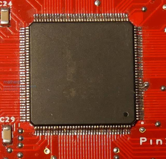

Posts: 11956
Posted: 11:33pm 19 Mar 2018
From the picture you seem very short of solder on most pins. You will see connectivity when your probe is on the pin as it pushes it onto the PCB but it may then spring up after you remove the probe. Here is my scruffy but working version
FWIW, and I know WW swears by it, but I think flood soldering and then using wick to remove most is inviting this sort of issue. Don't know what technique you use.

Joined: 11/04/2012
Posts: 1051
Posted: 01:41am 20 Mar 2018
@Matherp This second attempt I did use WW's flood method unlike the first. I will re-do the pins with solder and see if that helps.
