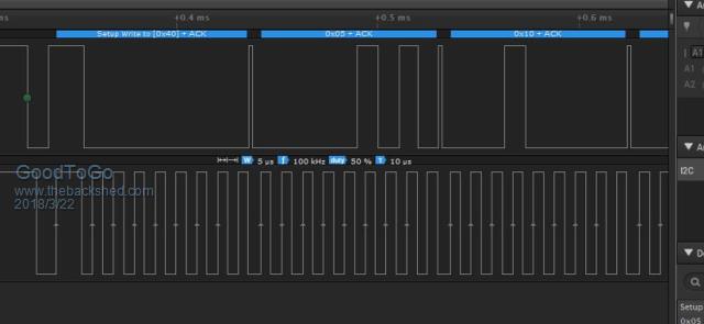

And a bit more I have a SD1306 lcd and an INA219 on the I2C pins
This works as expected
I2C open 100,100
Dim d(5)
For I = 8 To &H77
I2C Read I, 1, 1, d()
If MM.I2C = 0 Then Print "Address is ";"&H";Hex$(I):F=1
Pause 5
Next I
If F=0 Then Print "No I2C device found"
Result
Address is &H3C
Address is &H40
This does not work
Dim d(5)
For I = 8 To &H77
r = I2CPort(2, 18, 17, I, 1, d())
If r = 1 Then Print "Address is ";"&H";Hex$(I):F=1
Pause 5
Next I
Result
No I2C device found
So not sure whats going here

Give me a day or two. I am setting up a test jig to try and discover what is happening.

OK, this is embarrassing. Somewhere along the line the speed of the I2CPort CFunction got set at 100Hz instead of 100KHz. I don't know when it happened - perhaps it has been that way since the start.
Anyway, below is the correct CFunction running at 100KHz. I'm hoping that this explains why the INA219 did not respond correctly. I have tested this on other I2C devices and it works with them.
Thanks for the offer GoodToGo. I might take you up on that if we still have trouble.
Geoff

Thanks Geoff it works spot on now.

Top stuff Geoff! Works a treat.
