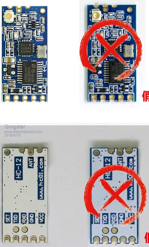

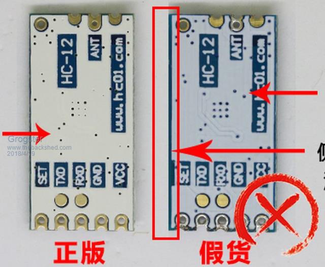

For this thread's reference, here are the photos that Dave is talking about from the HC12 website:
Apart from the slight silkscreen misalignment on the fakes, they are also easily spotted as fakes by the two extra holes on the PCB, indicated by the arrow. If you have those holes on your HC12's, they are fake ones, so it would seem.
I will now check all the ones I have in stock, and if I find ones without those holes that appear to be genuine, I will then test THOSE - but I fully expect them to be spot on frequency wise, being the genuine article.
Certainly something to be VERY aware of now we know fake HC12's are being sold.
EDIT: The 'Holes' I mention are actually on both. The arrow seems to be indicating the thin silkscreen on the fakes, which shows them up. The genuine ones have a thicker whiter silkscreen. The ones I have certainly seem to be the fake ones based on what I am seeing. Luckily, I have only built about six units with the new 'Fake' HC12's, so I will have to f-ing pull them to bit again, and remove the modules and obtain and install some genuine ones. *sigh* However, looking on the bright side(of life!), I had only built 6 units, not 60 or 600 - that would be an absolute nightmare.Edited by Grogster 2018-04-20

Well, I have checked my stock, and found seven HC-12's which all qualify as being fakes. I have binned the lot.
I bought them as a lot of 15 from AliExpress, but back in November last year, so I can't open any kind of dispute about them now(too much time has passed).
The only thing is, I am trying to remember where I used the other 8 from that batch.....
EDIT: From what I have been able to establish at this stage, after a bit of cross-referencing with the PICAXE thread Dave linked us to, THE GENUINE MODULES HAVE AN OSCILLATOR MARKED AS T300.
THE FAKES HAVE AN OSCILLATOR MARKED AS 30.000MHZ.
Fakes also seem to be about half the price of the genuine ones - US$2.50 or so each, with genuine ones being around US$5 each, so that can be used as a guide.
I was not aware of HC12 fakes existing, so always went for the cheapest ones I could find. Now I know different, I will be more selective in whom I buy them from - but that does not necessarily mean you won't be sold fake ones anyway.

One of the things that is visually different between the real and clones, is that the genuine ones have a thick white silkscreen on the bottom. You can't see the bottom tracks because of this. The fake ones have a more see-through milky looking silkscreen on the bottom.
The clones seem to actually work OK from what I have found, but cos they are off frequency, you can't use clones and genuine ones on the same link or network, as they won't talk to each other on the same channel because of that.
