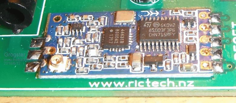

In my case, I use a little slice of the band at 458.6MHz, which is allowed up to 500mW, so I can run the module at 100mW to get the best range - your local regulations may well be different. However, with that setup, with a small helical on the transmitting node, and a whip on an F-to-U.FL lead on the receiving end inside the house, I was able to get about 400 meters or so. Not bad for a small helical and an inside receiving antenna.
I have another setup where the receiving antenna is outside on the roof, and with the same frequency and power I can get about 600m or so reliable comms still using the tiny little helical.

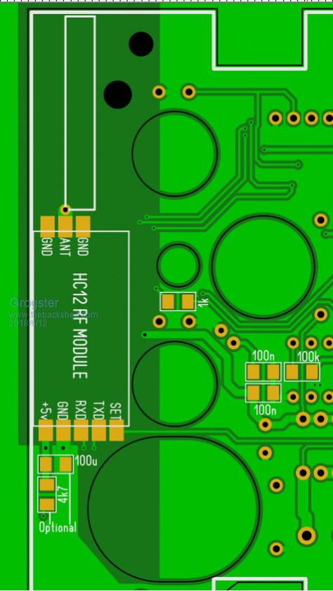

The helical is mounted in-line with the module, and away from anything metallic. Here is an image of how I have one setup on one of my PCB's that gives the range I have just mentioned:
It is VITAL that there is no ground-plane or any other copper tracks anywhere near the helical, especially at the open end of the helical. You probably already know that. Despite this crampt-ish looking layout, I get 500m easy with 100mW to a roof-mounted receiving antenna. The antennas I am using on this PCB, are 27mm helicals from this seller. These are 433MHz antennas, so I cut about 1.5 turns off the end of them to re-tune them up to around 458MHz where I need them.
I have seen people mount the helical back against the rear of the module. This will work OK for short-range and makes it nice and compact, but that will affect the range as you have the metallic PCB and it's components right beside the helical, which will affect it's performance quite badly. However, if you only need a short distance....

Posts: 10056
Posted: 09:01am 12 Jun 2018
Yes, I just solder the module to the pads. They never move after that.
It is also quite easy to remove them if you ever need to.
