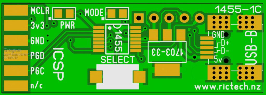

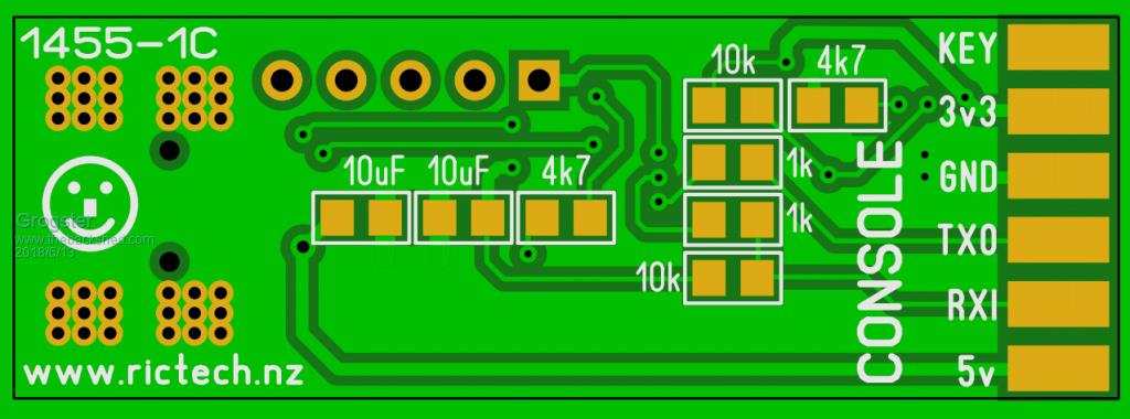

I like the way you think, CG. As soon as I read your first post on this, it made me think, and I have rustled up a preliminary 1C:
This uses a 6x2(assuming you can get such a thing), and has standard ICSP on one side, and console on the other. Console side has 3v3, 5v and ground connections so you can tap into the USB 5v, or the 1703 regulator's 3v3 output.
EDIT: Of course you can get 6x2's..... Edited by Grogster 2018-06-13

Posted: 07:44am 12 Jun 2018
+1 for the 1C version, especially the pin arrangement.
If I had one of these I would block off the GND pin socket hole next to the 3v3 pin on the Console side of the board. Then for any boards / devices that I wanted to be able to use this with I would remove the corresponding pin on the 2 x 6 male connector - presto, you can only plug it in one way and you still have all signals and voltages available. Brilliant!!

Posted: 03:55pm 12 Jun 2018
  erbp said   +1 for the 1C version, especially the pin arrangement.
Great idea. In my experience, a corner pin is easiest. perhaps the one labeled 3.3 could be moved down one position. Corner pin labeled 'key' in that case.
Posts: 10056
Posted: 09:30pm 12 Jun 2018
Cutting the pin of the male header on the PCB is easy(or install a 5p header there), but does anyone know where you can get the little filler things that you can put in the female header thing, to block that pin hole?

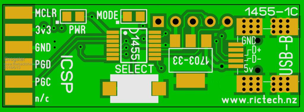

Here is the new version:
This PCB is 43.6mm x 15.0mm in size - small.

Posted: 06:32am 13 Jun 2018
After a bit more thought I have one more suggestion on this topic. I would very much like to see the 3v3 connection on the ICSP side of the connector controlled via a jumper. This was also previously suggested by CircuitGizmos. I would be happy with just a 2 way header so that the 3v3 can be connected if the header pins are shorted, or left disconnect when they are not (the earlier suggestion was for a 3-way header so that you could select 3v3 or 5v or no connection - I don't need that level of complexity but others may).
This would allow easy disconnection of power to the device from this module if the device is using its own external power supply (like a 5" LCD backpack which may overtax the 3v3 regulator on the debugger/programmer module) or supplying 3v3 to the device under test if that is required. It just adds another level of flexibility making this module even more useful.

Posts: 10056
Posted: 09:35pm 13 Jun 2018
On projects that don't want the 3v3, how about just not install that pin on the board so the 3v3 from the female header would never be connected to the PCB? Exactly the same idea as the KEY pin, but for the 3v3 pin. The key pin would still prevent you from putting the thing on the PCB the wrong way around. Thoughts?
erbp
Joined: 03/05/2016
Posts: 195
Posted: 11:29pm 13 Jun 2018
I guess I could live that that as a solution, however my preference would be for the option to power / not-power the device under test to be available, but if it's not something others want then ok.
However I believe there is a wiring issue with the 1C board. The ground end of the power LED series resistor is no longer connected to ground! Check the left end of the 4K7 resistor just above the word CONSOLE in the lower image above. It connects to a small area of "ground plane" copper, but that no longer has a connection to ground as it was severed by the 3v3 track relocation when you moved the 3v3 pin down one position.

Posts: 10056
Posted: 01:09am 14 Jun 2018
@ erbp - I will look into this. Yes, the LED has no ground reference in the above photos. That has been corrected.
@ Rob - SOIC is too big to fit in the current layout, however, I will have a play with the layout and move things around a little and see if that can be made to work - you were right last time. (the E28) The SIL switch is a neat idea. I will play with the layout. No idea on case. I was never planning to case it.
