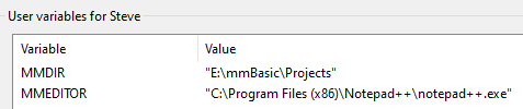

NPHighview
Joined: 02/09/2020
Posts: 222
Posted: 07:50pm 15 Sep 2020
Earlier postings in this thread discuss setting environment variables.  I'm seeing some weird behavior in mmBasic for DOS, and wonder if I'm alone.
I've set up the external editor to use Notepad++ (just can't unlearn ctrl-c & ctrl-v - sorry!), and the file location to be on my SD card receptacle, E:.  mmBasic is able to see files in that location (when I do a 'files' command within mmBasic) and load files from that location with no further qualification ('load "life.bas")
System variables are set up to use double quote marks (for Notepad++, which is in the "...Program files..." subdirectory, requiring quotes, and for safety's sake, for my SD card:
However, when I do a 'System "set"' command inside mmBasic, this is what I get:
which is missing the right-hand quote.  And when I quit Notepad++ after editing a Basic program, I get this: for MMDIR:
I've also tried putting double double quotes at the end of the string (""), and removing quotes from the string, and removing quotes but putting a backslash at the end of the string - all to no avail.
Is this a bug or a feature?
Thanks!
- Steve
Edited 2020-09-16 07:46 by NPHighview
Posts: 3368
Posted: 11:32pm 15 Sep 2020
I don't know what is going on here but I do not think that it is a MMBasic issue (environment variables with quotes work for me).

NPHighview
Joined: 02/09/2020
Posts: 222
Posted: 11:40pm 15 Sep 2020
Thanks, Geoff -
I'll poke around and see if I can narrow the focus a bit more.  I'm running mmBasic 5.05.03 on Windows 10 64-bit Pro, Bootcamp, on a MacBook, so there's plenty of opportunity for funny business.
By the way, this whole ecosystem is marvelous.  Thanks so much!  Reminds me (very pleasantly) of programming on HP-9845 desktop computers in the late 1970's / early 1980's, but with the opportunity to talk one-on-one with the creator!
- Steve
NPHighview
Joined: 02/09/2020
Posts: 222
Posted: 07:20pm 16 Sep 2020
Geoff - I installed mmBasic for DOS on an entirely different computer (a Dell laptop running Windows 10, native), and instead of using the Settings to establish the environment variables, I wrote a small batch file to do so on the way in to mmBasic:
SET MMDIR=E:\mmBasic\projects
SET MMEDITOR="C:\Program Files (x86)\Notepad++\Notepad++.exe"
"C:\Program Files\mmBasic\mmBasic.exe"
cls
Note the lack of quote marks around MMDIR.
mmBasic comes right up, and shows the contents of the subdirectory on the SD card in E: but when I load mc_pi.bas, shell out to the external editor, make a tiny change, save, and return, I still get this:
> load "mc_pi.bas"
> wedit
Error : Expected a string
and the file listing in mmBasic doesn't show the change I had made.
Just to be sure that the problem isn't with Notepad++, I changed the batch file to invoke Microsoft's Notepad:
SET MMEDITOR="Notepad.exe"
cls
mmBasic still shells out successfully to Notepad, has the program loaded, but when I save & exit, I get the same "Error : Expected a string" message, and the file in mmBasic's memory is unaltered.
To be trebly sure, I downloaded & installed the Atom IDE, which is pretty huge.  I saw the "Error : Expected a string" message come up in mmBasic as it was shelling out, not upon the return from the external editor.
So, this has eliminated:
* The host PC
* The external editing environment
* The setting of environment variables through "Settings" vs. command line
What's still in common:
* Windows 10 Pro 64-bit
* mmBasic version 5.05.03
* The "Error : Expected a string" message, regardless of external editor
Your thoughts?
