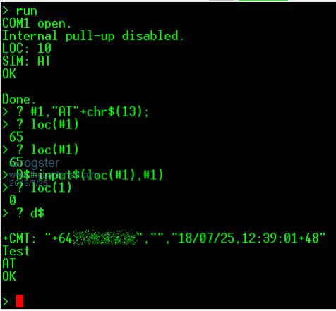

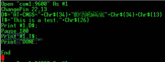

Posts: 10056
Posted: 07:09am 25 Jul 2018
Well, bugger me......
...and my test code:
This module seems to be VERY touchy to any kind of external pull-up. Even the internally supplied one by the MM upsets it! Having disabled the internal pull-up, everything is working! It even forwarded a text message I sent earlier in the day. (cell-phone number scrambled for privacy)
Now, where did I put that good quality Scotch.....
EDIT: The MM internal pull-up is not a resistive pull-up, correct? I seem to recall reading that this weak pull-up is actually formed out of a FET junction or something. If Geoff or Peter reads this, perhaps they can just clarify that at a technical level for me.
EDIT: Oh, I am so happy.....
Edited by Grogster 2018-07-26
Posts: 3368
Posted: 07:48am 25 Jul 2018
I think that you are right about "weak pull-up is actually formed out of a FET junction or something". Microchip don't provide a lot of detail besides saying that it is a constant current source of about 50uA.

Posts: 10056
Posted: 07:58am 25 Jul 2018
Thank the God of your choice, that you wrote the ChangePin Cfunction. Without it, I would still be stuck!

Azure
Joined: 09/11/2017
Posts: 446
Posted: 08:58am 25 Jul 2018
Congratulations, I'm glad you got it sorted.
I agree with the sensitive part. It is obviously enough to upset it forming some sort of resistive divider. It is down to the level shifter IC.
You are correct re the PIC, it is done using semiconductor technology. Resistors are too hard to fab in silicon compared to a weak semiconductor low current source.
