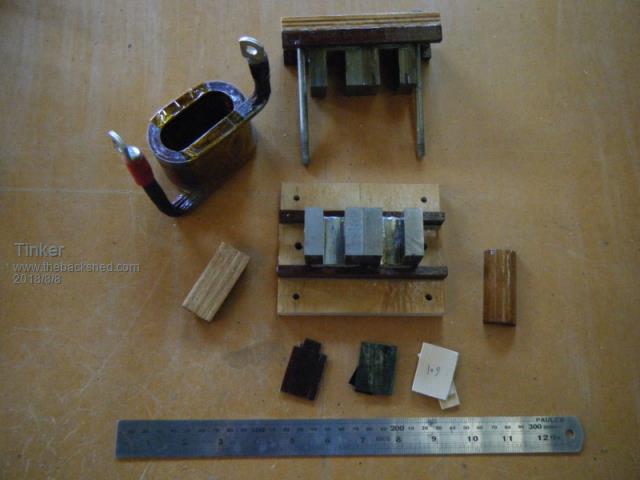

Now the test results for those who might make an E core from the two smaller Aerosharp choke C cores.
The picture shows this was built the same way as the large one described above.
The coil shown has 9 turns only of 45mm sq. I will try later if more turns (possibly 13) could fit if cross section is sacrificed.
The two half dowel sections shown were used to wedge the rounded ends of the coil in place. The coil must be locket firmly in place but, for experimenting, epoxying it in solid would make it no longer possible to change the gap spacers or to disassemble the lot.
For this test I only made 3 different spacers and I could not test the 'no gap' part as my test coil was just too wide for that.
Small E core made from 2 sets of small Aerosharp C cores.
Core cross section 26x35mm = 910mm sq
Available coil area 15 x 56mm
0.9mm gap: 1687.5A/t
1.5mm gap: 2625A/t
1.9mm gap: 3000A/t
I think I mentioned elsewhere that the the 9 turn coil I have for this, with a 2mm gap, only yielded 43.5uH.
With more turns and a thinner gap this size core might be suitable for a smaller inverter, perhaps in the <5KW range.

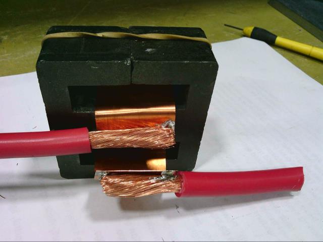

  Tinker said   Interesting idea, that sheet copper winding. It would need to be quite long, 2.5m+ when I look at the new coil former I made today. Then there is the challenge of how to connect to the start of the winding...
The start is not a problem, and neither is joining lengths together, if you do it at the side of the winding where it bulges outwards to get around to the other slot.
I do a lot of foil windings, and here is a demo of a silly one turn winding with crazy thick wire. Subsequent turns just go over the bump at the inner start of the winding.
The sides can stick out a fair way without being a problem.

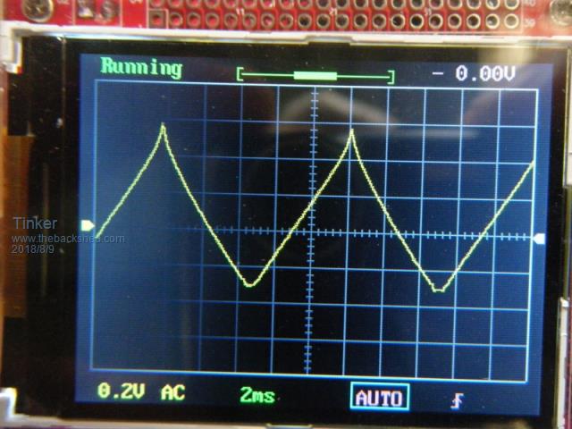

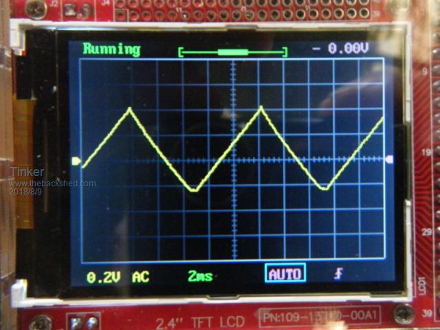

I see warpspeed has his engineer hat on again so I hasten to provide the numbers.
Firstly I must admit that I had forgotten about half turns are doable with E cores .
So my test coil actually has 125.5 turns since the wire ends emerge from opposite sides of the coil.
The gap for the tests, pictured below, was 1.5mm
I used two large (33,000uF/40V caps in parallel. They have a 23.6A ripple rating each.
The first picture shows just before saturation occurred, the voltage to the caps was 39.5V.
Rise time for the trace was 5mS.
My Hall sensor gives 40mV per Amp so the 600mV shown correspond to 15 Amps with the 125.5 turn coil.
The second picture shows after saturation has occurred, the voltage at the caps was 47.3V.
If you would like to do that test differently just let me know.

Inductance in microhenries = 39.5v x 5,000uS divided by 15 amps peak = 13,167uH
Now our test winding has 125.5 turns, and inductance is proportional to turns squared.
So if we divide 13,167uH by 125.5 = 104.9uH and if we again divide by 125.5, we get 0.83598 microhenries for one theoretical turn.
We also know that it saturates at 15 amps x 125.5 turns = 1882.5 ampere turns.
From that we can now work out what we could have for ANY number of turns on that core, with that gap, as it now is.
If we have already decided that 18.5 turns will both fit physically, and carry the required current without overheating, we can work out what 18.5 turns can do.
One turn will give us 0.836 microhenries.
We multiply that by turns squared. 0.836 x 18.5 x 18.5 = 286 microhenries.
Saturation occurs at 1882.5 ampere turns, so if we divide that by 18.5 we get 101.75 amps.
We have more inductance than we probably need, but its going to saturate a bit early.
So we rinse and repeat. Perhaps increasing the air gap from 1.5mm to 2mm and go through the whole procedure again, starting from the beginning.

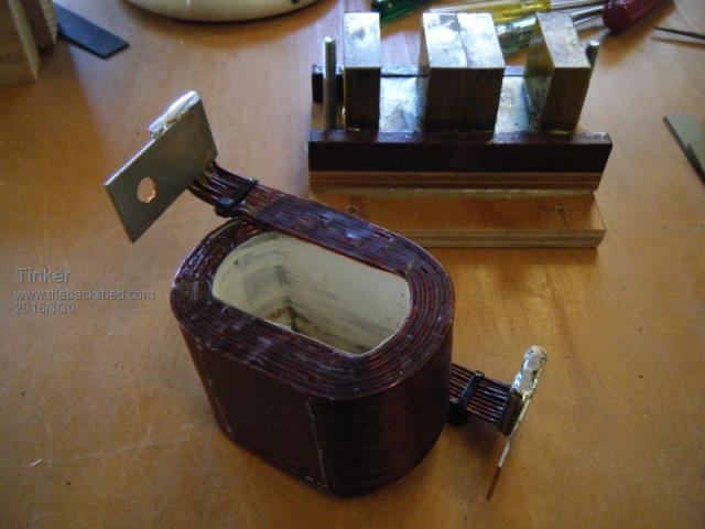

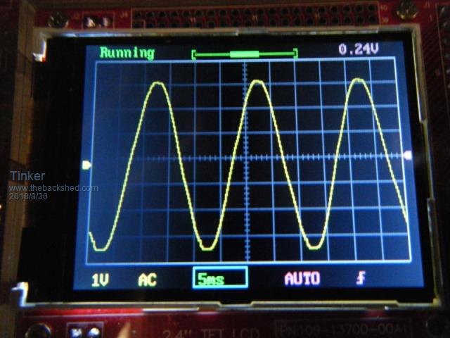

Posted: 10:45am 30 Aug 2018
So this is the latest of my choke creations, 1.6kg of copper, 18 1/2 turns of 45mm sq wire.
I ended up using a 2.4mm gap to get the peak saturation near my planned 200A range.
Saturation is at 196.7A peak, giving it 3639.5 ampere turn.
The inductance by warp's method calculated at 193 uH, my LC meter shower about 20uH less. I suppose this is because of it using a different frequency for the reading.
Tested it in the inverter today after first subjecting it to 125A AC from my stick welder to see if it got warm - no chance.
With a 2.5KW load (fridge & fan heater) the sine wave was as good as I hoped, better than any I had before. Perhaps tuning the secondary capacitor helped there too.

Great effort Klaus, that waveform looks perfect.
And I bet the idling current is pretty reasonable too.

That shielded wire you mention got me thinking, my big double stack inverter uses a shielded wire and I can't remember that one doing the restart thing when it is powering things.
It did do it a few times when it was just idling of the battery while the house was powered from the other, single toroid, inverter and I overloaded that one with the chop saw testing. The single toroid inverter does *not* have a shielded wire to the switch.
While I had my double stack inverter apart to replace its choke I ran the house on the single stack inverter. Had a few temporary blackouts when the induction stove cut in, dropping its power level settled it down again and nothing blew up.
So I got another job now, shield the wires and the switch panel on top of the inverter (which is located above the toroid & choke).
1. I would not be game to remove that 10K resistor at pin 6 - it stops things going 'bang'.
2. I use the overtemp to control one fan, the other fan has its own independent temp sensor. That works so well I'd prefer to leave that alone. Always thought oztules method to use it for shut down was 'odd'.
3. My control board has a complete ground plane on both sides. Its also about as far as possible located away from the toroid & high current wires.
So I think we should start with the shielding of sensitive parts. My control board is small enough to even fit into a metal box if I have to. BTW, I have a spare one if you like to play with it - the gate connections are separate though, no ribbon cable.
I think there is a pic of it at my last (experimental) inverter build blog.
The other thing I will do is using the little digital oscilloscope to monitor the sine wave as I operate various items at my place.
For example, tonight I happened to be at the inverter while the microwave was defrosting something. That one *really* distorts the sine wave badly at the peak and at zero crossing. Then later, when the induction stove was running, the distortion was hardly noticeable but the AC voltage shot up by 5V when the power (500W) cycled on and dropped back when off.
It ran fine though with the microwave, no performance loss, just horrible sine wave.
