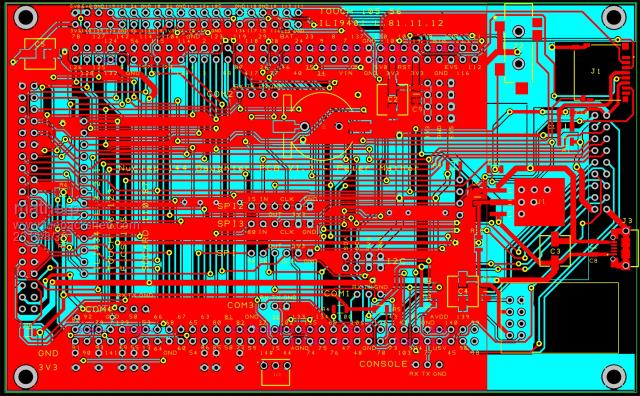

I've added an optional crystal on the bottom and a header for the console. This allows the Nucleo to be used without the ST-LINK connected (or even attached)
2018-08-30_214919_stm32h7V1.3.zip
I've ordered 5 from JLCPCB. USD27 for 137x85 PCBs INCLUDING DHL shipping
Their website is also excellent. The gerbers can be visualised online as soon as you have uploaded them before you complete the order process.

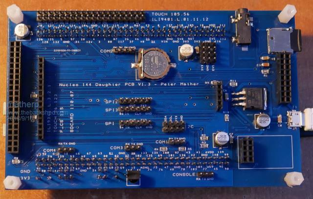

Just a couple of notes on building the backpack:-
- make sure you mount the micro USB before the adjacent capacitors as it is impossible to get at the USB pins with the caps in place (yes, I DID put the capacitors in first and, YES, I did have to take them off to mount the USB connector - 😢😢)
- if you want to use a pi 4" ILI9481 lcd that Peter has included drivers for, with this v1.2 board, you will need to make an adaptor - I did one from veroboard and can provide the connections if anyone wants (it's wortwhile - it's a nice display and not a bad price)
- watch you soldering on the Nucleo CN11 and 12 connectors - I found the solder didn't run in properly on a couple of pins.
Other than that, my system is up and alive - just waiting on a camera and time to test the other interface modules.
Thanks Peter, great design!

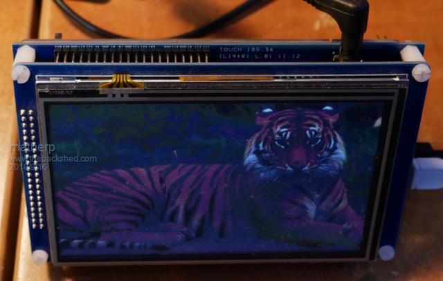

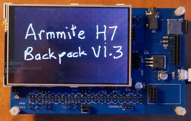

This version allows a 5" SSD1963 display to be mounted with supports. It also includes a Pi compatible header supporting any of the Pi "HATS", an IR receiver, and optional pullups on 8 of the I/O pins for things like DS18B20 as well as the V1.2 connections (ESP8266, OV7670 camera, SSD1963, ILI9341, 4*Com, 3*SPI, I2C, SDcard, Battery for RTC, Audio jack).
In addition it includes a console port and an optional 8MHz oscillator allowing the Nucleo to be used with the STlink removed if required.
The version pictured has a silkscreen error (touch connections for the Pi header should be 112,56 ), also the spacing of the 3.3V pins under COM4 should be 0.1" under the ground pins but are actually 0.125" but the gerbers are correct.
