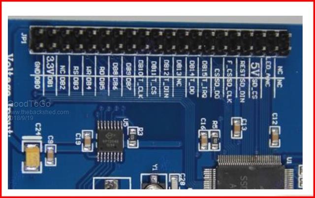

I think the SSD1963 connector orientation might be wrong if the connector is mounted on the other side of the board.
Have a good look at Pin 1 as an example, especially compared to the Pi connector. With the board flipped, (ie. SSD1963 side up) is the connector on the left or right side? (Landscape more) Where is pin 1 on the display? Does it match up with pin 1 of the connector? Once you have the orientation correct, then you can wire it up.
I suspect looking at your picture as is, that Pin 1 of the SSD1963 connector is actually in the Top left position, instead of top right.
This would make all connections to the SSD1963 incorrect.

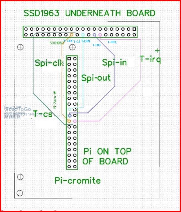

Lew, use your multimeter to make sure you have continuity from T_CS to pin 26 on the Picromite. The circuit as you have drawn it looks OK.

Here is the SSD1963 connector.
And here is my modified version of your PCB layout:-
From your pin numbering, SSD1963 Pin 16 (T-DO) has to connect to Picromite Pin 21 (SPI-IN) NOT Pin 19 (SPI-OUT).
Likewise SSD1963 Pin 20 (T-DIN) has to connect to Picromite Pin 19 (SPI-OUT) NOT Pin 21 (SPI-IN).
At the moment your Touch (DIN/DOUT) SPI connections to the Picromite are reversed. Swap them around.
Also note that your labelling of T-CS and SPI-CLK were swapped as well.
Long story short:-
Your SSD1963 pin 24 (T-CLK) Connects to Picromite Pin 23
Your SSD1963 pin 22 (T-CS) Connects to Picromite Pin 26
Your SSD1963 pin 20 (T-DIN) Connects to Picromite Pin 19
Your SSD1963 pin 16 (T-DO) Connects to Picromite Pin 21
Your SSD1963 pin 14 (T-IRQ) Connects to Picromite Pin 24
(I say 'Your SSD1963' because I think Pin 1 on the SSD1963 is actually the 'GND' pin in the top left corner? Anyone?)

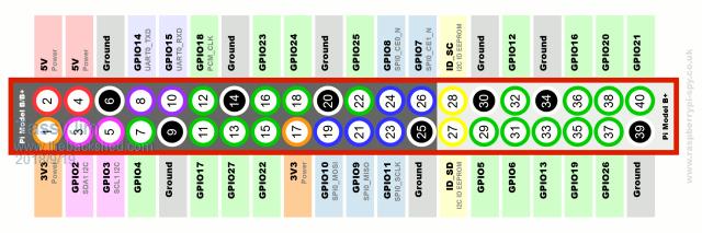

I think he has the PiZero upside down. need to be flipped left to right.
This should be the pins looking from above.
Easily tested by using jumpers.

Sorry
TO make it clearer
and EVERYTHING works perfectly other than when I try and calibrate the touch
The top 2 calibration points work, once I touch the 3rd one I get "Hardware Failure" message
I'm 98% the pins are correct - ?

I found the problem eventually after checking about 10 times and 9 times I missed it
T_DIN and T_DOUT were swapped
so annoyed with myself
