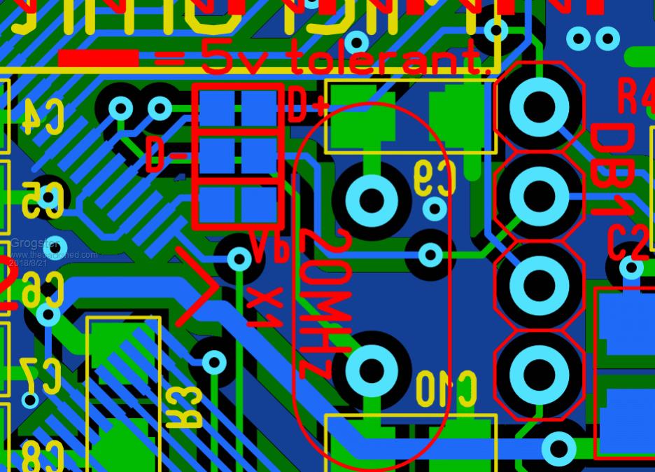

  TassyJim said   Half way there.
I was thinking of three pairs of pads that can be bridged with a solder blob to reinstate the "old" connections.
Not for me. The only time I use the USB is for testing other peoples problems.
Not quite following this reasoning.
If its a 'problem' with an 'old' E64, then the USB connection exists already.
If its a problem with this 'new' design then simply plug in a new daughter-board and you then have USB Comms connection to resolve the 'problem'.
One thing I have potentially just realised: If D+/D- are 'removed' to the USB socket then OPTION CONSOLE OFF would prevent comms tbetween the PIC1455 and the new E64; so IF you haven't set a OPTION KEYBOARD (and physically connected one), then you are potentially 'locked-out' of the MM+. It would need a firmware reload to recover (which you could now do) but you'd loose any program at the time of OPTION CONSOLE OFF was typed.
So possibly the pads that TassyJim refers to would help 'rescue' the scenario above in extreme cases where you needed the code intact (rather than lost via a Firmware update).
Hope I have got the above explained correctly!
Edited by WhiteWizzard 2018-08-22

Posts: 10056
Posted: 07:04am 21 Aug 2018
@ Paul - no room for that. It would look kinda odd/ugly anyway.
@ WW - Same thing could potentially happen with the E28 module or the latest E100 board too. Best to simply leave the console enabled at all times. Recovery would be by reflashing the firmware, as you point out. I will make the old USB pads a bit bigger and leave them on the new layout. They might prove useful at some point to someone - who knows.

Posted: 07:09am 21 Aug 2018
Jim, nicely thought of before it was too late to do something about it or take into consideration.
Grogster, if you can wriggle 2 more 0.1" pins next to (0.1" away) the D+/D- you have going to the daughter board and route the chip USB pins to those then you could add a 2 pin header and if needed put in 2 jumper blocks between those and the daughter board connections (with the daughter board removed while using the USB port for data). Would allow for no daughter board operation or emergency recovery without having to reflash firmware.
Something like this (excuse the bad drawing)
Edited by Azure 2018-08-22
Posts: 10056
Posted: 07:11am 21 Aug 2018
Nice idea, Azure, but no room(crystal is in the way). Board is pretty tight now.
EDIT: I will have a look and see though, as that is a very nice idea.Edited by Grogster 2018-08-22
Azure
Joined: 09/11/2017
Posts: 446
Posted: 07:13am 21 Aug 2018
I have seen what you can do... there is mils' in there to spare
It could be on the inside of the daughter board connector as I drew, since the header with socket of the daughter board would clear it.Edited by Azure 2018-08-22
Posts: 2991
Posted: 07:15am 21 Aug 2018
@Azure,
Nice thinking, but I believe you would need Vusb jumper too. This then 'feels' like too many jumpers to set for a 'novice user' i.e. looks 'scary'.

Azure
Joined: 09/11/2017
Posts: 446
Posted: 07:17am 21 Aug 2018
Thinking out loud here, but can't VUSB be always connected, it would be if you were running just a USB power cable with no data wouldn't it?
Posts: 10056
Posted: 07:21am 21 Aug 2018
Interesting idea, Azure. Your thoughts WW?
Posts: 2991
Posted: 07:23am 21 Aug 2018
  Azure said   Thinking out loud here, but can't VUSB be always connected, it would be if you were running just a USB power cable with no data wouldn't it?
I was wondering that too - just purely to minimise quantity of 'jumpers'. In theory it will work; just not sure at the moment as to what are the disadvantages (if any).

Posts: 2991
Posted: 07:26am 21 Aug 2018
Another thought:
What if you reverse things a bit and have D+ and D- always connected and only Jumper Vusb??
Posts: 6621
Posted: 07:31am 21 Aug 2018
  WhiteWizzard said   Another thought:
That would have two USB connections in parallel. I wouldn't like to see that.
Posts: 2991
Posted: 07:35am 21 Aug 2018
But wouldn't the Vusb act like a 'Chip-Select' for the MM PIC and hence the D+ and D- be ignored?

Posts: 11962
  Quote  Think Geoff or Peter need to confirm any disadvantages in Vusb being tied high all the time!
Slows down processing slightly as MMBasic only checks for USB input if VUSB high
Posts: 10056
Neither would I.
This is what I have so far:
I have not yet routed Vbus, and it's gonna be tight. I would love to be able to omit that one, and connect it permanently. We just need to know if that is OK to do or not.
Posts: 2991
Posted: 07:37am 21 Aug 2018
  matherp said  Slows down processing slightly as MMBasic only checks for USB input if VUSB high
Thanks Peter. Is it significant to worry about, or do you think tying Vusb high will have a negligible affect only?
Posts: 11962
Posted: 07:46am 21 Aug 2018
  Quote  Is it significant to worry about
Yes - no reason to give away performance
