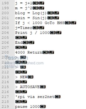

At the end of the transfer I receive "Error: Invalid character: 1"
I have added a USB-TTL adaptor to the Pi and connected it to COM1.
That way I can use ser2net to connect to mmbasic in terminal mode over TCPIP.
Easier for me than running a serial cable.
I have found a problem with AUTOSAVE.
AUTOSAVE is ended with ctrl-Z but that kicks you right out of MMBasic.
Is there an alternative used to end AUTOSAVE?

I will try to work out how to ignore the error message.
My usual upload method is AUTOSAVE from 'load' in MMChat.
I have added a setting to use ctrl-C for PiCromite files and that seems to work.
I have another 'problem'
The PI starts sending double CRs which results in double spacing.
I still haven't worked out what triggers it.

I tried using AUTO instead of AUTOSAVE but that came up with 'Error: Unknown command'
If you are using MMBasic via a serial port, exiting out of MMBasic can be hard to recover from. Perhaps a 'Confirm exit' would be useful to catch the accidental ctrl-Z
Edited by TassyJim 2018-11-17

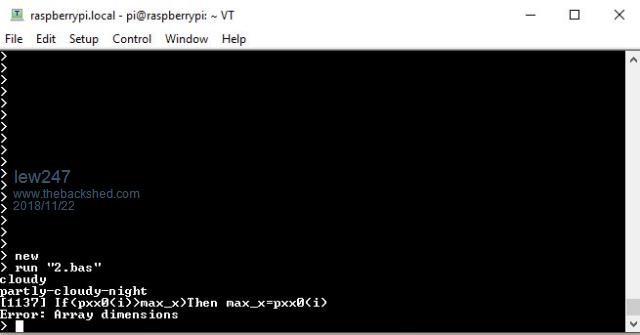

Matherp
I installed the latest version of Picromite tonight but I'm getting a weird error
I don't have that line of code in my program
I had no issues with the previous version I was using, although it was probably 2 - 3 versions ago, I didn't upgrade when you included the code for graphs at first
Any ideas?
I've sent you the full code by message as it contains my logins for the various weather stationsEdited by lew247 2018-11-23

That line is in the code you sent me in the subroutine "getlimits". Geoff has tightened up array checking in the latest version of MMBasic and I implemented the changes in the Pi-cromite.Edited by matherp 2018-11-23

Posts: 4386
Posted: 01:38pm 22 Nov 2018
Two thoughts
1. pxx0 appears to be used as an array but declared not as an array
2. i has not been set.
I suppose i may default to zero but that is terrible coding even if so.
JohnEdited by JohnS 2018-11-23

  JohnS said   Two thoughts
While it may be "terrible coding" I have no idea how you declare something as an array
Posts: 11966
Posted: 06:09pm 22 Nov 2018
  Quote  1. pxx0 appears to be used as an array but declared not as an array
This is the "bug" that Geoff fixed. Previously simple variables could be used with an index without a bug being generated.
If pxx0 etc are simple variables then just get rid of the index brackets from the subroutine

Thanks Peter
I've got it working again now
