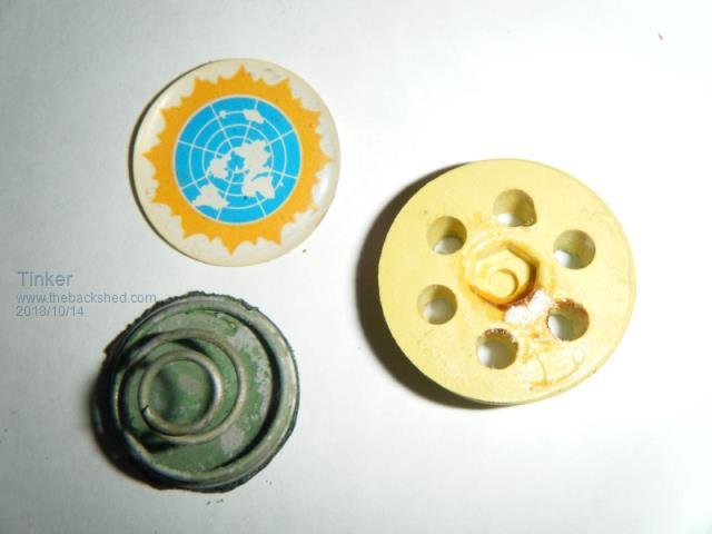

In case you do not know, the purpose of that "hump" in the middle of the cell is it contains a spring loaded relief valve. The little decal on top pops up a little when the innards get too hot and create pressure.
Under the decal is a screw plug which tensions the spring under it. The valve is just a rubber disk.

I often wondered if those cells were completely sealed.
Venting anything is really bad news, once its vented its GONE, and losing a little bit of something repeatedly isn't likely to add to the life of the cells.

if you overcharge a loose cell till it damages it will likely burst rather than vent, I think it is a safety feature to stop clamped cells exploding under extreme pressures.
Posted: 02:39am 14 Oct 2018
Very likely, although they have been known to inflate into the shape of a football if not rigidly clamped to prevent swelling. That pressure relief valve in the hump must be set pretty high.

Just in case anybody likes to see that cell valve, here is a picture:
The plug on the right can be screwed in to tension the spring located beneath it.
The valve disk (under the spring) is an alu disk with a rubber layer on the sealing surface.
