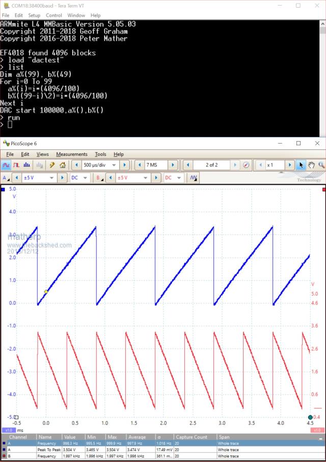

New functionality
2018-12-12_052634_ArmmiteL4.zip
This allows you to create any arbitrary waveform using the L4's inbuilt DACs
The syntax is:
DAC START frequency, DAC1array%() [,DAC2array%()]
DAC1array%() and optional DAC2array%() should contain numbers in the range 0-4095 to suit the 12-bit DACs. The software automatically and separately uses the number of items in each of the arrays to drive the DACs.
The frequency is the rate at which the DACs change value. So in the example code above there are 100 items in the array a%() which are displayed at a frequency of 100,000 Hz giving a sawtooth with a frequency of 100,000/100 = 1000Hz. There are 50 items in the array b%() which are displayed at a frequency of 100,000 Hz giving a reverse sawtooth with a frequency of 100,000/500 = 2000Hz.
The output runs in the background and is stopped using the command
DAC CLOSE
NB: for the moment I have settled on double precision floating point
Edited by matherp 2018-12-13

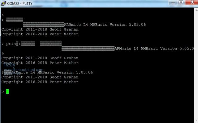

I got the L4 NUCLEO-L452RE-P board--512MB ($15.96 from Digikey). I connected as a usb drive and pasted in the bin file--I think the latest one, dated 2019-01-28.
Connected with puTTY at 38400, hit enter, and got a ">" prompt. So far so good.
I started to type and it froze. I once got as far as PRINT MM.VER and a response of 5.05.06. Reconnecting repeatedly always quickly produced freezes.
Pressing the reset button gave me this:
Am I doing something wrong or is this board not (yet) compatible?
Posts: 11968
Posted: 10:30pm 29 Jan 2019
  Quote  Am I doing something wrong or is this board not (yet) compatible?
Certainly not compatible. The code reads the CHIP ID and uses it to configure RAM and FLASH usage. I don't know what the chip ID of the 452 is and haven't configured for it. Send me a PM with your email address and I'll send you a version of the code with a diagnostic to read the CHIP ID, then I can (hopefully) do some level of auto-configure.
