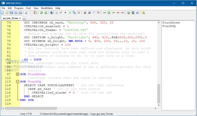

There is one that would be nice in MMEdit from a post by KeepIS. Function folding as an option, where only the first line of a function is shown with a + or - as the first character on the line to expand or contract the function (or sub).
E.G.
+ Function Max(a,b)
Bill
Posts: 6621
Posted: 07:33am 07 Jan 2019
  Turbo46 said   There is one that would be nice in MMEdit from a post by KeepIS. Function folding as an option, where only the first line of a function is shown with a + or - as the first character on the line to expand or contract the function (or sub).
E.G.
+ Function Max(a,b)
Bill
Folding is unlikely until I port MMEdit to a more powerful language.
I have pushed things as far as I can go.
I can do it with a better compiler:
No timeframe
Edited by TassyJim 2019-01-08
circuit
Joined: 10/01/2016
Posts: 309
Posted: 09:20am 07 Jan 2019
That looks like a VERY worthwhile and valuable addition to MMedit. Much encouragement to translate "No timeframe" into "as soon as I possibly can..."
Really looking forward to the next edition!
