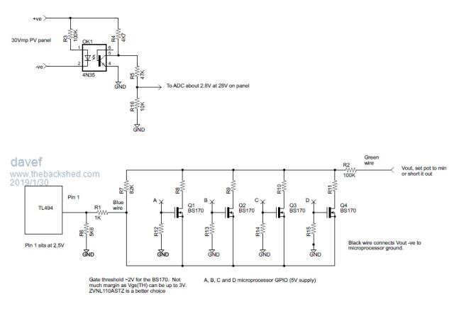

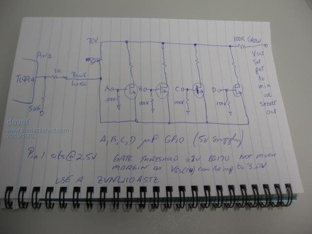

BTW, I modified the Vout setting by using 4 small signal 100V JFETS and 4 resistors. The JETS are driven from a microprocessor with GPIO at 5V.

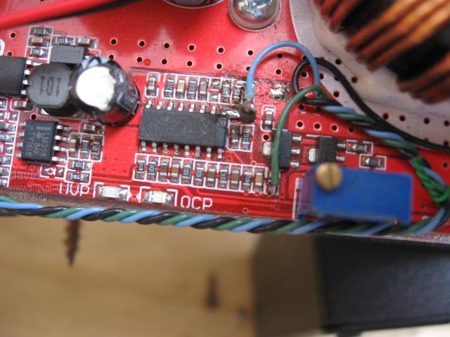

davef
Joined: 14/05/2006
Posts: 499
Posted: 07:02pm 29 Jan 2019
Black wire goes to Vout -ve
Blue wire to one end of a 1K resistor which is attached to pin 1 TL494
Green wire as shown (SMD pad closest to bottom edge of PCB) remove the chip resistor
When integrating this SMPS power supply into a system note that there is a BIG FET that switches Vout -ve from Vin -ve. It is either for limiting input current or reverse polarity protection.
I plan to use a optocoupler to measure the panel voltage, so as not to upset any system grounding. At the moment I am ignoring the above SMPS behaviour.
Now, you will need the schematic of the switching unit and then I will post the code. Edited by davef 2019-01-31

  davef said  I plan to use a optocoupler to measure the panel voltage, so as not to upset any system grounding
Like use a VFC to drive the LED in the optocoupler and use a microcontroller on the other side to read the freq?
I am a bit hesitant of this idea as the transistors in cheap optocouplers have a low switching freq. that will affect the scale you can read

A 4N35 will give me a reasonable indication of panel voltage. The problems with them is poor linearity, unit to unit variation and possibly temperature variation.
The PWM controller I am testing with also has separate Vin and Vout negatives, which I think is pretty common.
I sample for 10ms every second so hopefully opto switching speed is irrelevant.

Optocoupler ... typically a LED coupled to a phototransistor. The more current through the LED the lower the collector voltage at the output. So, as well as non-linearity you have to account for this "inversion".
For example with 30VDC through a 10K resistor gives about 3mA of LED current. With a 4K7 collector load resistor you get about 10V on the output. I pot this down with a voltage divider to get about 3V, which is then fed off to the ADC in the microprocessor. This is when you get into curve-fitting to come up with a formulae.
Solar PWM controller info just throw it into Mr. Google. The design info will harder to find.

Here's a picture of the JFET switches to adjust Vout in 5 discrete steps.
I will draw up a suggested opto-coupler circuit for sampling the PV voltage later.
I divided the 70Volt to 33Volt into 5 equal power steps, about 33, 43, 53, 61 and 70Volts. I can't say what the unmarked resistor values are until I build this version.
The 100K in the green lead is to reduce Vout down to roughly half the value and to limit the current if you accidentally connect the GREEN wire to ground! This will also reduce the voltage on the JFET drains.
Black wire connects Vout -ve to microprocessor groundEdited by davef 2019-01-31

Here's a better schematic.
