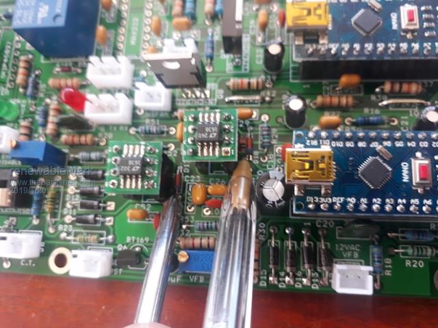

Tinyt, on the build notes item 14 had bat46 for d17,d18. On the silkscreen it has 4148, which one is meant to go there?

Poor memory, forgot to update the silkscreen, use bat46. It has a lower forward voltage drop than the 1N4148.

Thanks Tinyt, all fixed, I initially assembled from the silkscreen, then noticed I hadn't used the bat 46's.

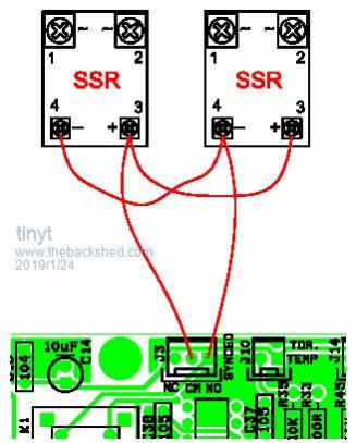

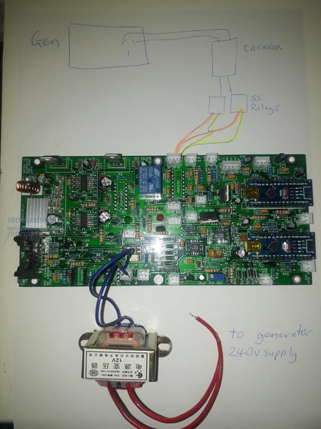

Just checking I am understanding the proposed gen sync connections.
Is this drawing correct?
And are these relays fit for the purpose here
And with the breaker is this OK?
Cheers Caveman Mark
Off grid eastern Melb
tinyt
Joined: 12/11/2017
Posts: 564
Posted: 07:25am 23 Jan 2019
The transformer connection looks OK to me.
J3 only provides mechanical switching signals coming from the on board relay K1. The solid state relays you picked require 3-32vdc to turn it on. So, as connected they will not turn on. If you want them turned on by the code (if the code supports K1 turn on), you will need to modify the PCB slightly. This is bottom side of the PCB.
Here is the connection of the solid state relays (input). This will apply +12vdc to the SSRs when the on board relay K1 is turned on. This is top side of the PCB.
I am not familiar with what you want to happen when the code turns on relay K1. I have not checked the code. Maybe poida can help on this one.Edited by tinyt 2019-01-25

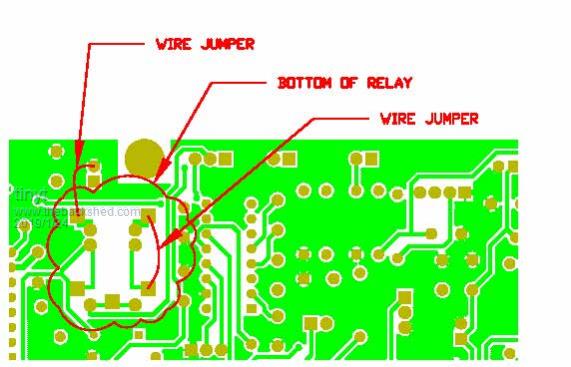

Oops, I made a mistake on the mod drawing, I forgot to mirror the gerber for the bottom view of the pcb.
It should look like this:
Sorry.

The mains sync function:
once the inverter output is in phase with the "mains/generator" sync input, D4 on Nano1 will go high, driving the relay K1 to close a normally open terminal to it's common terminal.
One use of this might be to add the inverter output to a generator's output.
The way I see it working is the generator is already running, with a load on it, taking it's output voltage down a bit. The inverter fires up and syncs, then we can parallel the inverter with the generator. The voltage will now come up a bit thanks to the added current from the inverter.
How to wire it:
First need to make sure of the phase of the "mains" or generator sync input. The inverter will sync up and we need to see if we guessed the phase wiring of the 240V-12V transformer correctly. I posted before how to find out safely.
It will be 180 deg out or less than 2 degrees out. We need to have it less than 2 deg
Assuming we have the inverter and the 240V source for the 240V-12V transformer, we can now consider connecting the inverter output to the generator.
I would connect neutral of both generator and inverter together.
I would connect the inverter active to the generator active via a contact breaker and then a SSR or normal relay.
(I still don't believe it will work..)
This idea of sync to another source is just experimental.
Please be careful out there.

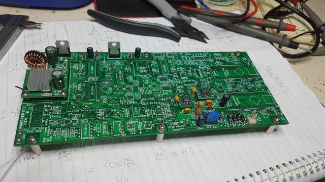

I have at last made a start on a board.
First get power supply going, then passives around nano1 and the 2 Vfb opamps,
put the opamps on to the 0.1" breakout boards you thoughtfully supplied me.
Maybe tomorrow I apply power, first without opamps and nano1, then fit those 3 items and see if it lives.
I need to get to Jaycar for 15K and other resistors tho.

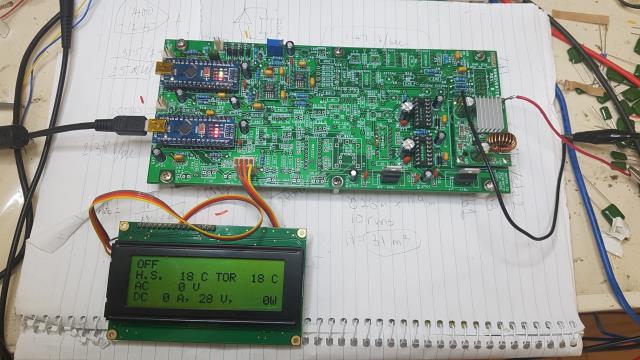

Posted: 02:31am 10 Feb 2019
it lives!, Igor, it lives!
bare minimum:
5V and 12V regs
inverter "RUN" green LED
nano 5v supply, ADC Vref
the two AC Vfb opamps
the two IR 21844 sockets and charge pump, decoupling caps
I2C
A few 2 pin connectors
The pic shows calibrated DC V supply at 28V from the bench PS.
Later I run it in anger..

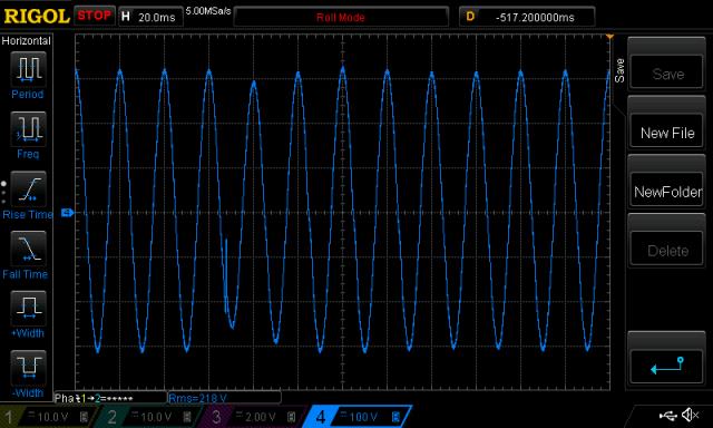

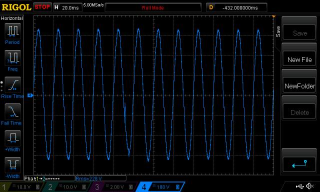

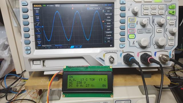

And I have it running the test inverter now.
It was a fiddle getting Vfb right. My Vfb transformer is a 9V, not
a 12V as specified.
I attach the most recent code.
I changed the AC output setpoint, to a smaller value to reflect
my 9V transformer.
When anyone here builds one of these boards, we will need to talk about how
to get a reasonable setting for R31, Vfb adjustment trimpot.
There is ample scope to try running the inverter with Vfb trimpot set to output 300V and that will blow stuff up. It is best to have it set to about 180V and when running, adjust it up to the desired output voltage.
The first attempt was without the shutdown transistor network in place.
This permitted the gate drive ICs to float their shutdown pins.
Naturally, the inverter was unhappy.
But after putting Q1-4 and the resistors in place, it runs really well.
The Gate drive output is disabled upon power up to the DC-DC converter.
Also they are disabled until you switch the board ON. This is perfect.
No spurious gate drive during DC supply ON or OFF.
The output waveform, zero load, 27.4V DC supply.
Here is the transient response when I switch 150W incandescent light on.
(my standard test load for the bench setup)
This is very good transient response to my mind. It is very similar to
my previous 2 prototype boards.
Here it is with the same transient test, on the same inverter, but using
a EGS002 to drive it. How they get it to respond so fast, I have no idea.
I can change from the nanoverter to an EGS002 in about 60 seconds.

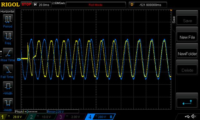

I have mains sync working too.
It's nice to see the LED light up and hear the relay click
when sync is obtained.
Blue is AC output from nanoverter
Yellow is external mains as applied to J2.
It only needed 11 cycles to shift the output nearly 180 degrees.
My external mains isolation transformer is not 12V it's 30V.
And so I applied 30V to the 680R + 1N4007 + TLP523 opto.
What was that smell? No harm done. I added a 1K in series to
reduce the current. All good.
