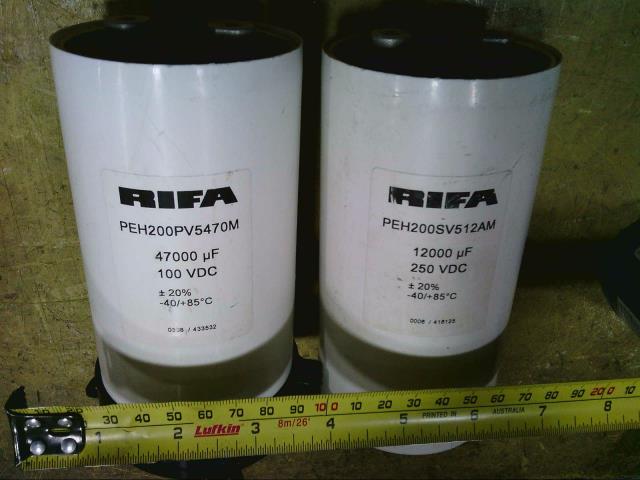

Some really large high ripple current caps for 48v, need to be four times the size as for 100vdc, at a similar power level. That is the disadvantage of using lower voltages at very high power levels.

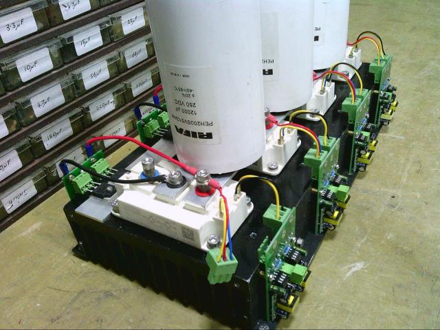

Probably the best low ESR high ripple current capacitors would be the Evox Rifa type.
These are horribly expensive new, but turn up occasionally on e-bay. They always have a white can and heavy screw terminals.
I am using three 12,000uF 250v capacitors at 100v and 5Kw. These each have a ripple current rating of 18 amps.
A 48v inverter might require three (or four) 47,000uF 100v capacitors with 30 amp ripple rating for the same 5Kw power level and energy storage.
These go for typically around $70 each on e-bay secondhand, probably about a third of the price new.
https://content.kemet.com/datasheets/KEM_A4034_PEH200.pdfEdited by Warpspeed 2019-03-10

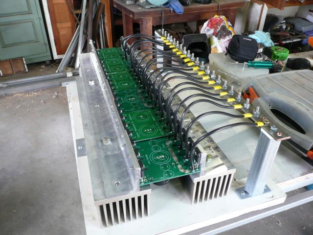

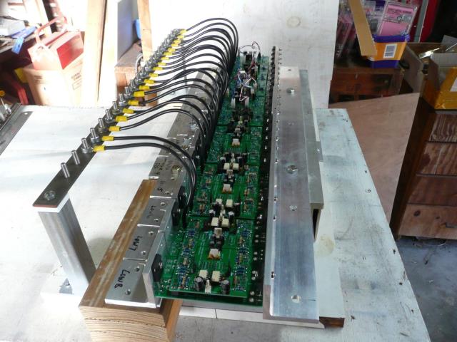

The layout need not be involved, as functionally all four inverters do exactly the same thing. four identical circuit boards might be possible, with the smaller ones just a cut down version of the larger ??
The caps I specified would be about right for a 5Kw inverter operating straight from solar panels without any battery. The inverter will present a huge pulsing load on the capacitor bank, and the current from the solar panels will be a constant steady flow. So we need bulk heavy duty energy storage at 100Hz to feed the inverter. And it must have adequate ripple current rating and very low ESR if its going to work.
If we are going to dispense with voltage feedback, the input capacitor bank slows down the rate of voltage rise/fall with sudden massive step load changes to a point where the input voltage correction scheme can very easily deal with it.
Its all a bit "brute force" but it really makes a very big difference to large sudden step load performance, if the capacitor bank is a really good one.
Light duty cheap aluminium electrolytics are likely just not up to the job.
They would probably be o/k if there is a large and very low impedance battery very close to the inverter, but I don't think is a good idea to skimp on the electrolytics in any inverter.
My original scheme was to be able to run without a battery, and I managed to achieve that with excellent results. But it may all be total overkill for others.
Always possible to just build it and see how it goes, and do a capacitor upgrade later on. All this surging current is mostly from the largest inverter, and that needs a lot of help. The smaller inverters are much lower power and need a lot less energy storage.
I decided on a really simple robust easy to repair physical layout, that has a lot going for it. But it uses more expensive exotic parts unfortunately. The capacitors bolt onto two massive aluminium busbars, which in turn bolt on top of four IGBT half bridge power blocks with minimal lead lengths.
Those in turn bolt down onto an isolated heatsink. That comprises the first and second inverter. The third and fourth inverters just use four individual TO247 mosfets, two in each half bridge. All eight of the small half bridge driver boards are identical.
Edited by Warpspeed 2019-03-11

Now something different, more mechanical.
I see you use just one common heat sink since you have isolated IGBT's for the switching job.
So, using HY4008's would it be ok to use one big heat sink for all the mosfets that have their drains at + battery voltage (using the heat sink as a conductor)?
For the HY4008's that have their drains connected to the primaries one would need a separate heat sink for each half bridge when using non isolated mosfet mounting?
The above would mainly apply for the first & second transformer so, one long positive rail heat sink and 4 off 1/4 size primary rail heat sink.
Transformer 3 & 4 'could' be similar but on a much smaller heat sink for the positive, etc.
mackoffgrid

Posted: 11:49am 11 Mar 2019
you mean like this
Andrew
