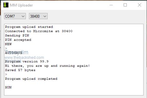

Here is the first draft.
Encoding and crunching have not been implemented yet.
The ZIP has a single exe file. Put it anywhere convenient but it does require write permission so not in Program Files etc. An inf file gets created remembering the window position and the last serial port used.
Getting your code into the uploader.
Create a shortcut on the desktop and Drag a file from Windows Explorer.
Or
With the program running,
Highlight code in your editor and drag onto the program's text window.
Copy the code into the clipboard and right-click in the program text window.
Provided you have a serial port selected, the upload will start immediately.
If there is no serial port, you will be prompted to select a port then press "Program" The "program" button is usually hidden.
If the first 5 characters of the file are "MMHEX" we have an encoded file and it is decoded before uploading.
If the first line is
'encode this
the code is encoded, not uploaded. You will get the ability to save the encoded file ready for distribution.
if the first line is
'crunch this
the code is crunched before encoding.
Crunching does not remove any 'echo ... lines
Otherwise, the code is uploaded
any line starting with
'echo
is sent to the text window and NOT uploaded
This lets you send messages to the user.
I will add TCPIP ports to the choices (probably)

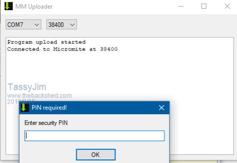

The PIN was more of a pain than I expected. It is very slow to respond (deliberately to stop brute force attacks)
I can change the PIN dialog to a 'password' type which hides the entered digits.
You only get one attempt at the PIN.
There is a bit of information there to help tech support.
  Quote   OPTION PIN 9999
'echo Program version 99.9
DO
FOR n = 1 TO 20
PRINT n
NEXT n
LOOP
'echo Hi there, you are up and running again!
The two 'echo lines are sent to the text window instead of the micromite.
I will speed up the upload using Rob's method eventually.
For now, I need some heavy destruction testing.

I have added the encode/decode function.
It can now crunch, either before encoding or when uploading.
setting the micromite clock is another option.
'encode this
or
'crunch this
the file is encoded, crunched in the second case.
The resulting file will be saved with a ".bae" extension if no extension was provided.
The first line is discarded.
Then if the next (or first if not encoding) line starts with
'onload
further options are possible.
settime set the micromite clock before uploading
setRTC will eventually set the RTC
norun prevents the RUN command being sent after the upload has finished.
crunch crunches before uploading. It makes no sense to crunch now if you crunched while encoding.
so
'onload settime norun crunch
will set the time upload a crunched file and NOT run after loading
The order of the options does not matter.
2019-02-17_163412_MMUploader.zip
I have included a sample encoded file test.bae in the ZIP
After an encoded file is uploaded, a copy of the decoded file is put onto the clipboard as a temporary debugging measure. This lets you compare before and after files.
This will be removed after I am confident that the encoding/decoding is working reliably.

  Quote  If I use 'encode and drag into the window, it creates the .bae file. If I drag the .bae file into the window, it asks again for a file name instead of downloading.
That was a bug. Now fixed.
  Quote  If I use 'crunch and drag into the window, the file is not crunched
That is correct. I changed it so crunch is a parameter of 'encode or 'onload, rather than a separate command.
This update has the above bug fixed and now, when you insert or remove a USB serial port, the port number is shown in the text window.
An end-user could start MMUploader before inserting the cable. Then he/she would know what the port number is.
It also handles BAS file that have the MMEdit header in them.
2019-02-21_135220_MMUploader.zip
I have been experimenting with the command option
'onload command
OPTION LCDPANEL ILI9341, RL, 4,5,6
OPTION TOUCH 7,2
GUI CALIBRATE
This configures a module I have, something that has to be done after firmware updates.
The extra blank lines were needed to give the micromite time to reboot when the display is configured.
GUI CALIBRATE has to be the last command because it take time while you do the calibration.
I intend to have one BAS file with all the different setups I have for the various devices. It is then a case of highlight the one I want and drop it into the uploader.
As it stands, MMUploader disconnects as soon as the RUN command is sent.
I am thinking of waiting a few seconds after RUN before disconnecting. That way any immediate messages from the micromite will be captured by MMUploader.
It might be useful as a way of confirming the program is running (or capturing any error messages).
JimEdited by TassyJim 2019-02-22
