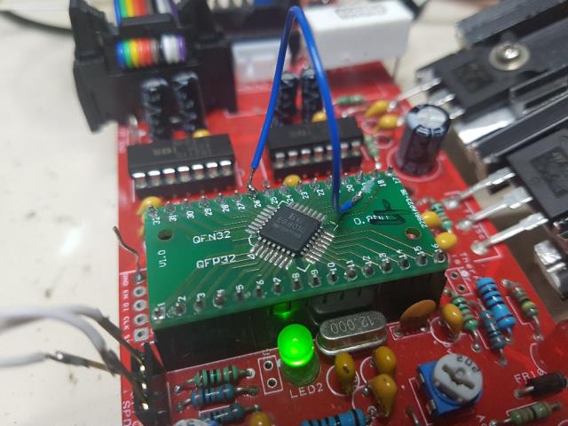

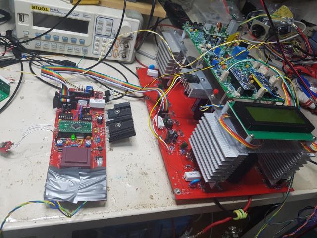

I think all we need to do is change the connections to pins 18,19
to have pin 18 low and 19 high, to make the EG8010 run at 60Hz.
The Mad control board has both 18 and 19 grounded,
to make it 50 Hz.
I suppose I need to cut the trace of pin 19, and pull it high to 5V
with a little extra wire, soldered onto pin 26.
Should be a nice and neat hack.
Hang on, I'm doing it now to prove it's no problem.

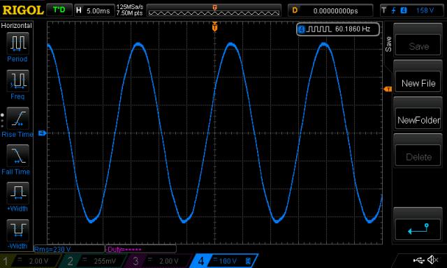

Notice the frequency readout top left.
the amazing hack:
running the Madness power board (using the same connector as the powerjack)
Edited by poida 2019-05-04

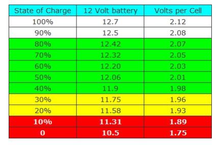

Posted: 12:42am 04 May 2019
46.5 would be great for me
if I went with 48 from what I've read that'll be 25% on the battery
but I'm really afraid of that voltage sag and no you probably did that for a good reasonEdited by BenandAmber 2019-05-05

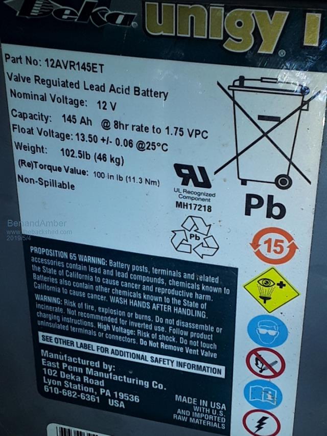

yahoo2
Joined: 05/04/2011
Posts: 1166
Posted: 02:52am 04 May 2019
lead acid rule of thumb starting point for AT REST volts.
so 46.5 is probably around 25% with newer batteries and a trickle power drain.
edit wow image upload hates green jpg sorry.Edited by yahoo2 2019-05-05
BenandAmber
Joined: 16/02/2019
Posts: 961
Posted: 08:42pm 04 May 2019
Thanks Yahoo2
I am very ignorant at these things
So i have to go off what I read on the internet
yeah I know that's kind of horrible
Or I can trust the greats that have a lifetime of experience that's been there and done that
I have been doing very well with the second thing there
Wow you have been on this form for years
Thanks again yahoo2 for your input and the graph Edited by BenandAmber 2019-05-06

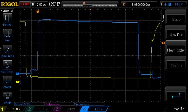

Further to running the Powerjack inverter from the Madness control board:
When running this at 52V, the idle current is 1.5A with the Madness control board.
I tested it using the PJ control board and the idle current is 0.38A
These 2 tests were using identical choke, toroid and capacitor, producing 230V AC.
0.38A for the PJ control board, 1.5A for Mad control board
Why?
I had a look at gate drive voltages, at the PJ power board screw terminals,
since they are so easy to gank into with short wires for the oscilloscope probes.
Here is the low and high side when running under the PJ control board.
Yellow is low side, Blue is high side.
Nice and clean control, no shoot through.
Well, not much anyway.
Notice the 2uS dead time.
There is some, but since the gate voltage does not rise high enough to conduct for very long, it's not a problem.

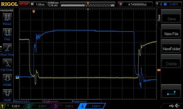

Here is the same signals, but this time running under Mad control board.
Lots of shoot through. Clear evidence of the oscillations induced by these high energy events too. This is using a 500nS dead time.
Increasing this to 2uS will NOT in my opinion alter the degree of shoot through.
This is because the shoot through is caused by dv/dt, not poor gate drive timing.
I do not recommend you run the PJ inverter with the Mad's control board. I think it's not a good matchup. At this stage I will not send the board to you now.

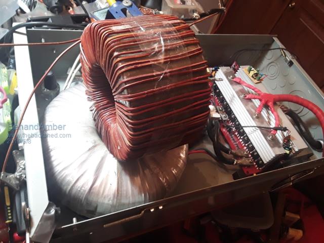

First layer on the power jack Transformer
I need to space the wires out a little bit and then on to epoxy
I'll be adding a little bit extra hardener and hopefully it'll be drying time to add the second layer
Just can't wait so excited get this power jack it up and runningEdited by BenandAmber 2019-05-09
/QUOTE]
A tip for you Ben, do *not* mess with the epoxy mix ratio - it needs to be exact as stated on the container (2:1, 3:1, 5:1 etc.)
Adding more hardener will prevent it from going off. But for some epoxy resins you can get different hardeners, like summer & winter types as the curing depends on ambient temperature. So, using winter hardener in summer will speed the curing time.
Do stick to the correct ratio for epoxy, I built a whole boat with that stuff and have a little experience with it .
In case you are confusing epoxy resin with polyester resin, with the latter you add a small amount (drops) of catalyst and there, adding more catalyst makes it go off faster.
BTW, polyester resin on enameled wire is something I would not recommend. Edited by Tinker 2019-05-09
