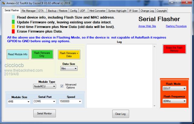

Hi all,
for Cyberlab :
Probably your module works only in DOUT mode and your incorrect parameter (-fm gave) simply push esptool with the default flash mode (that is DOUT in annex.bin).
You can simply use the utility, check "advanced options" and select DOUT.
Then you'll be able to flash the module including the data.

CYBERLAB
Joined: 08/08/2017
Location: Mexico
Posts: 26
Posted: 07:49pm 07 Apr 2019
hello ciccocb, yes it is working! thanks!Edited by CYBERLAB 2019-04-09

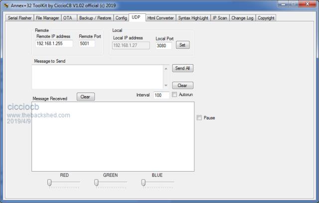

The only question I have is whether there's functionality for directly sending and receiving UDP packets and TCP streams. I am trying to build a terminal server, which would allow a Maximite, RunCPM, or Altair to be controlled remotely via a Telnet client. I'm a little unclear, even after looking at the documentation, about how the sockets system works.
Usually, I'd expect to see something like:
Connect(address,port,callback)
Listen(port,callback)
Send(message)
Received(sender, message) // signature of the callback method for received data.
But I can't find anything in the API that seems to deal with TCP or UDP packets.

Hi tomxp411,
Annex supports both UDP and TCP (http).
There is a little example in the documentation on how use the UDP here :
UDP event
In addition the AnnexToolkit contains a page dedicated to the development of the UDP:
For the TCP (http), there are several examples in the documentation on how use it.
You can find more information here :
URL Event
