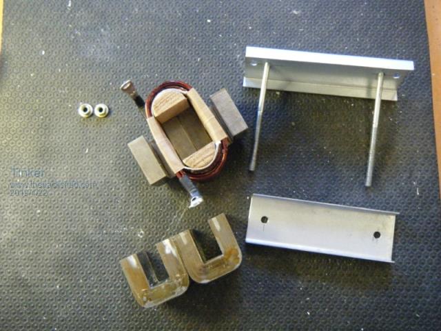

Today my new home made choke got connected and all is well now with my little inverter #5.
Here is how the choke looks:
All made from re cycled aerosharp chokes. The C cores from the smaller aero choke converted to an E core.
The wire (2.5mm dia.) from a big aero choke for the coil.
And the metal clamping brackets from the PCB mounting plate in the aero.
The specs: 17 turns of 10 sq mm wire. 0.85mm spacers between the pole faces.
Measured inductance was 0.2mH. My calculations show it would saturate at well over 100A peak so plenty of safety margin for that little inverter.

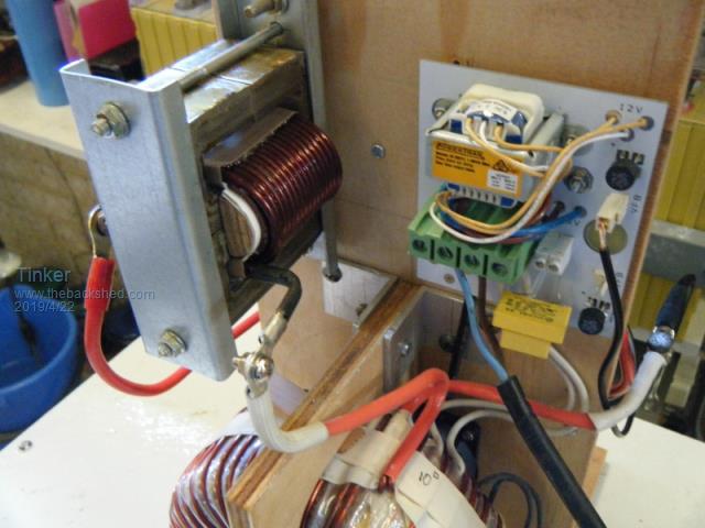

This is how its mounted now:

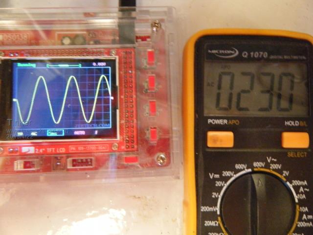

And it works very well, no more distortions. The next pic is the sine wave while powering a 600W load:
I must thank poida here for coming up with this marvelous sine wave generating idea, it looks heaps better than the sine wave from the EG8010 chip.

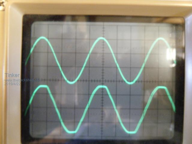

See both waves on the next pic. The top one is the poida sine wave, the bottom one the EG8010 sine wave.
As these two inverters were not synced the bottom wave moved across the screen surprisingly fast, hence the 'double' trace.
So there must be a bigger frequency difference between the nano inverter and the EG8010 version. I did look at the sine traces of the two EG8010 based inverters I have here, which are running independently, for comparison.
While both had the crappy sine wave, like the bottom one above, the out of sync drift was very slow, it took many minutes to be 180 degrees out.
The nano inverter was 180 degrees out in just a few seconds.
I do not have accurate frequency measurement here but my clamp meter does Hz and measured 50.1Hz at the nano inverter.
IMO, a choke like the one I made above is heaps better than any of the ferrite version I had experienced with.
This single nano inverter must have the active filter fitted. It will run without it but the wave form is not as good.
The nano inverter now has a better AC voltage regulation than my EG8010 based inverters.
