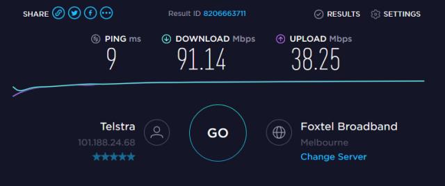

FTTC in Aus stands for "Fibre to the CURB"
I have FTTN "Fibre to the NODE" and I am on a 100MBS unlimitted plan and (when the kids are at school) off peak can get up to about 96MBs and slows to around 60MBs at peak.
I am with Telstra (Bigpond) and pay $89 for 100MBs unlimitted and home ph with most calls included.. Although I got a special price as they stuffed up my plan a couple of times so I got the speed upgrade for free (normally $30pm)
I just did a speedtest now as follows:

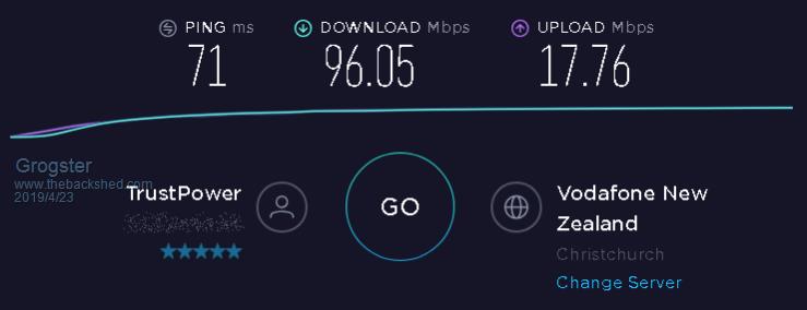

Mik - you should change that image, as your public IP address is on display. Unless you are behind a VPN or something, in which case.....
My speed test is:
The ping is a little high IMHO, but the speed seems fine - I never have any complaints as to speed. I have fibre right to the house, so no intermediate copper links. That seems like an odd way to do a FIBRE network....

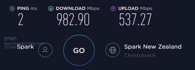

My 2 Cents worth. We are lucky we have GB fiber in NZ
