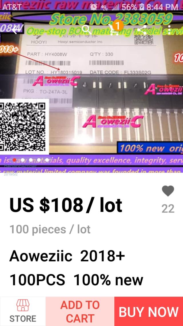

By the way, where do you get your HY4008 ?
RS, Digikey, nor Mouser have them.
Plus they're quite pricey from eBay china !
LadyN
Joined: 26/01/2019
Posts: 408
Posted: 08:49pm 01 May 2019
We source from AliExpress. Components could be suspect but we are in the prototype stage so no mission critical items yet.
My first 10Pcs HY4008P purchase cost $4.1 shipped

I bought a hundred of them off of AliExpress
this is where I bought mine I don't know if the guy sells fakes but the ones I got was not fake
someone put up this link and said that they were not fakes and was real so I jumped on it
I guess fakes is a real big problem
so you might want to check with someone else to make sure that you're ordering off somebody that is not selling fakes

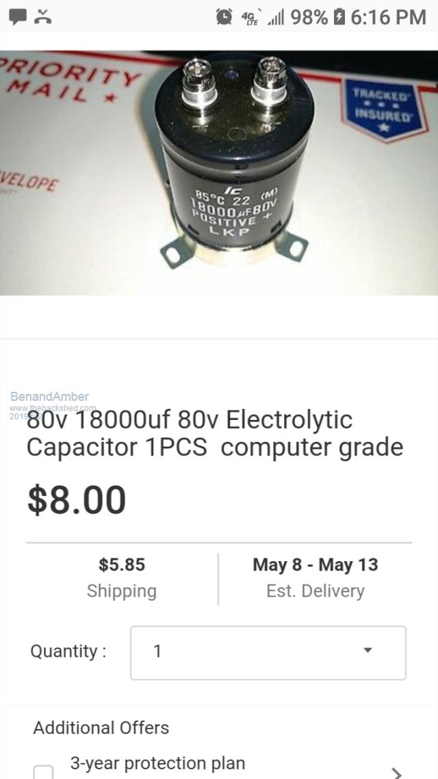

By the way, where did you get your big 18000uF/80V capacitors ?
Sourcing part is really part of the learning too, indeed !

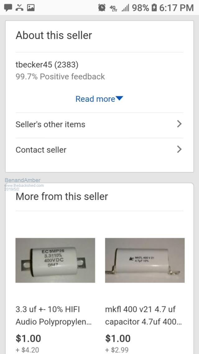

This guy bought out a inverter company that went bankrupt
these capacitors was originally to be used in inverters
He sells them by the case also
and yes 247 that is the size that originally came in my little inverter board like yours
But you may want to make sure that's the size in yours
You can find cheaper capacitors
but I don't know how how to tell the difference between the ones that are good for inverters and the ones that are not
so I bought these knowing that a company chose them for the inverters they were buildingEdited by BenandAmber 2019-05-03
I THINK:
1. ESR at the expected nominal temperatures
2. Ripple rating at the nominal frequency
.. are good heuristics
