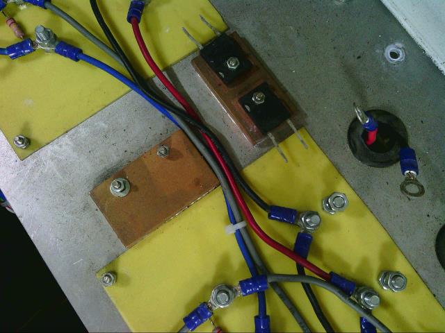

Getting back to thermal design.
One idea I have used successfully, is to first bolt mosfets onto a copper block, then bolt the copper block onto the heatsink.
That is probably of very limited value if the back of the heatsink is really thick, say 10mm thick or more.
But if the heatsink is something like a very large flat sheet of 3mm aluminium, the thermal gradient right around the mosfet can be rather high. Something like a 50mm x 25mm x 3mm block of copper under the mosfet tab can make a significant difference to the heat flow path.

Instead of bolting directly to aluminum, using copper intermediary is to help dissipate heat better?
(Copper has a higher thermal conductivity)
How much of a change does this have on the life/performance of the MOSFET?
Posted: 02:10am 17 May 2019
Without the copper, all the heat concentrates into a very small area of some fairly thin aluminium. With a copper plate, the heat is spread over a far wider area into the aluminium.
[quote]How much of a change does this have on the life/performance of the MOSFET? [/quote]
Probably not much, unless you are really pushing the absolute limits of junction temperature. I suppose it depends on your appetite for risk.
