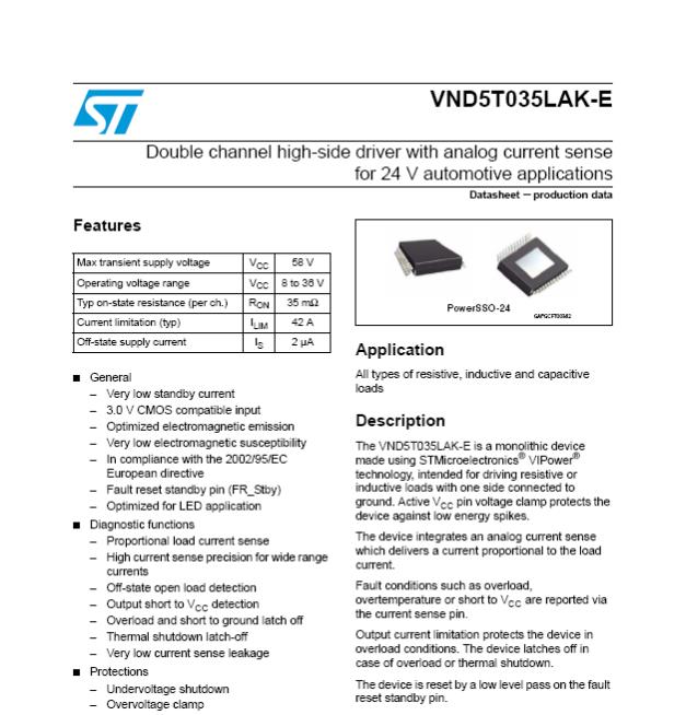

For the High Side Drivers, might I suggest these...
I have used them a a couple of MicroMite projects now...
Work like a champ... Include everything to drive inductive loads..
Interface directly to the MM pins...
You can measure current without a shunt or resistor..
Works with PWM and motors...
They are bullet proof...

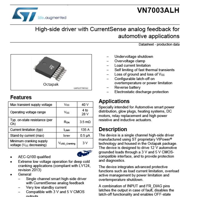

Very cool indeed....need to grab some...appear to be a long lead item from what I see, though.
CaptainBoing
Joined: 07/09/2016
Posts: 2171
Posted: 10:34am 19 Jun 2019
What is the best source anyone has found for these? I have about $30 from mouser at 10 off.
These could be the answer to a current problem for me. Doesn't look like I'd be getting them soon anyway (26 weeks!)Edited by CaptainBoing 2019-06-20

VN7003ALH - A very interesting device. They seem to be sold-out pretty much anywhere though. I would use these, if I could get hold of some. They seem ideal.
element14 also have them, but they too say you can only pre-order them, and estimated stock availability is December.....

How about BTT6100_2EKA. With a name that long it must be good.
Peter
Tinine
Joined: 30/03/2016
Posts: 1646
Posted: 09:46am 20 Jun 2019
  PeterB said   How about BTT6100_2EKA. With a name that long it must be good.
Peter
No kidding....and they actually exist...many thanks!
Looks like they're fast enough for PWM-ing a solenoid

Sorry gents about the availability problems... I checked on Digikey and found this device... Much the same type of thing, only you can get These ...
