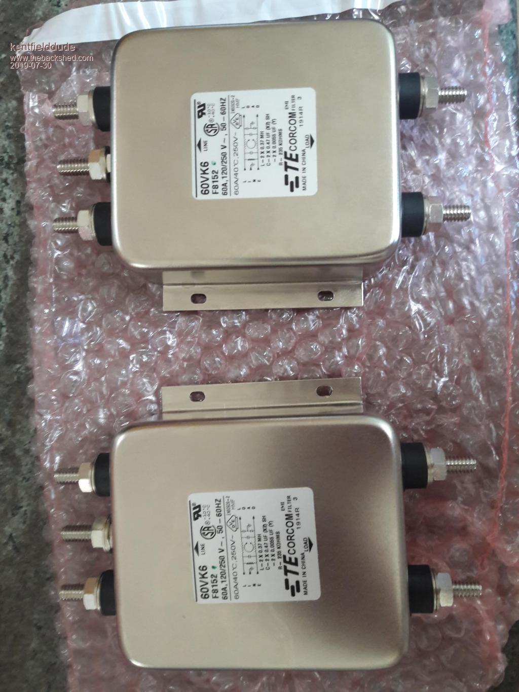

Got these in the mail today.
BenandAmber
Joined: 16/02/2019
Posts: 961
Posted: 12:46am 30 Jul 2019
Them are nice

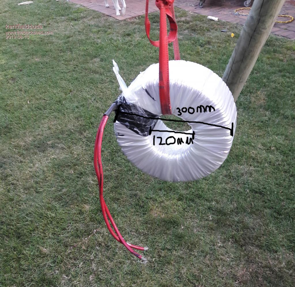

I removed the 90V winding on the outside. Do I need to mess with the 240v winding to get 120v split phase?
BenandAmber
Joined: 16/02/2019
Posts: 961
Posted: 03:15am 13 Aug 2019
Does the 240 volt winding have a Center tap
BenandAmber
Joined: 16/02/2019
Posts: 961
Posted: 03:16am 13 Aug 2019
If not then probably not
Warp speed is awesome when it comes to Transformers (or anything else) if that Transformer ain't exactly what you want
I would get with him and Rewind it the way you want it
This may be something you're using for the next 20 years
make it right exactly the way you want it the first time but that's my opinion anyway
It's a lot of work to wind a Transformer but I do it and have done a bunch of them and your skill level is quite a bit beyond mine
Edited 2019-08-13 13:20 by BenandAmber
BenandAmber
Joined: 16/02/2019
Posts: 961
Posted: 03:21am 13 Aug 2019
Or I'll just trade you a 52-pound 5000 watt 1 that's a factory Transformer LOL
Amber winds most of our Transformers
That thing should be really easy to totally rewind there shouldn't be very many terms at all like there would be on a small one it should be cake besides it just been so heavy
Edited 2019-08-13 13:24 by BenandAmber
Posted: 08:44pm 13 Aug 2019
It looks like you will have to strip off the secondary and start from scratch with a bare core.
Then you can rewind it to have a far lower idling current, and fit two 110v secondaries.
kentfielddude
Joined: 09/05/2019
Posts: 121
Posted: 12:36am 14 Aug 2019
Here is the 240v winding
