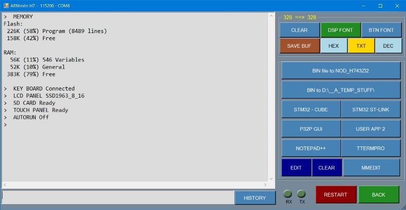

First, an apology for anyone trying the program as I've rearranged a couple of Buttons.
I added an option to Download the Device Program memory to the Screen Buffer, from there it's simply a matter of cutting the first few lines of device responses from the start of the buffer and saving the buffer.
It has been a perfect copy of the file loaded into memory, so far! I tried the M100+ and the ArmH7. I can download a 230K file in Program memory from the ArmH7 to the buffer window and save it to disk in 10 seconds. Obviously there is no handshaking and the result is somewhat dependant on the PC at very high baud rates like 230400. It's something I often want to do quickly and may be of little benefit to others, but it's there anyway. I'm reasonably sure this is the last addition to the program.

Added History to the manual command line input field that sits below the Main buffer display window.
KeepIS
Joined: 13/10/2014
Posts: 2289
Posted: 11:48pm 29 Jul 2019
A: Stopped History button opening if other send lists are open.
B: History will open and close via the History button.
C: History wraps after 20 commands removing the oldest cmds as new ones are added.
BTW If the history list is open, new manual commands won't be saved to history. Clicking on an history entry places it in the command field, pressing enter sends the command, obviously this allows editing of any history command in the command field as often as needed before sending it again.

For anyone interested, I found another option I wanted and added.
With some of the ARM boards, the MMBasic BIN file is simply copied to a virtual drive. I use this all the time on the ArmH7 and as I want to do as much of the setup as I can from within the program it's now included.
Added COPY BIN button that also looks for an ARM drive and gives you the option of copying the selected BIN file to that location, with the option of selecting another location if needed.
Clicking on a PORT in the COM window now gives you information about the port.
Changed the PIN INFO and layout in the MM.INFO list.
So Basically I can setup a device from scratch, including the BIN file, all options, GUI calibration and program loading.
FYI: When using the old INI file with the new program, some File Save / Open names may have numbers in them, once an entry is changed and saved everything will be back to normal, or just delete the existing Port.INI file.

The program idea of initially sending options to setup a device has grown as I found it becoming more useful with each addition. This latest incarnation brings together an external program plane. I can set and launch my favourite Editor, Terminal program and more. For the ARM, it brings ST-Link and ST-CUBE programmers together and there are two user PGM defined buttons, one I use to launch PIC32 GUI for my M100.
Almost all are configurable. When opened, they free the COM port for the launched applications and reinitialise it when the external programming application close. The Editor, Terminal and USER APP 3 programs don't restart the port, these program will stay running independently of the my Program. The Programming apps (if open) will close when my program closes or the close button is pressed.
I know I really should make a simple info file for the program when I get a chance.
Lots or changes made to stop the different Devices causing problems as there response to some commands is different in subtle ways under certain conditions.
UPDATE: Added a warning in case someone is dumb enough (like me) to have TWO ARM devices connected and therefore two BIN load drives, not a problem except you could reset the baud-rate for wrong device if you're attached to the incorrect device com port. When your experimenting or comparing two similar devices it can happen, this is just a friendly reminder for (me) the next time I forget.

I've added Setup options to the program, and a dedicated Tera Term button under the Program button.
Why?
I've been using Tera Term PRO for a while as it allows me to set a terminal of 40 x 132, which means no line wrapping in the Editor on really long lines, like GUI entries.
One of the New Setup options allows you to select the Terminal window size that you want the MM device to be set to, to match the terminal program, obviously you have to set Tera Term to the same terminal size. But once set in tera term and saved, it reopens at that size.
When Tera Term is launched from my program, I send the MM device the console size and colour code settings, followed by sending the Current Device COM port and Baud rate to Tera Term and it opens at those settings.
