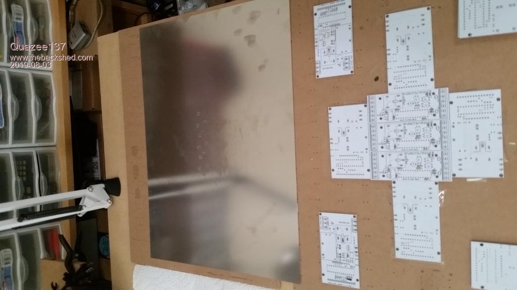

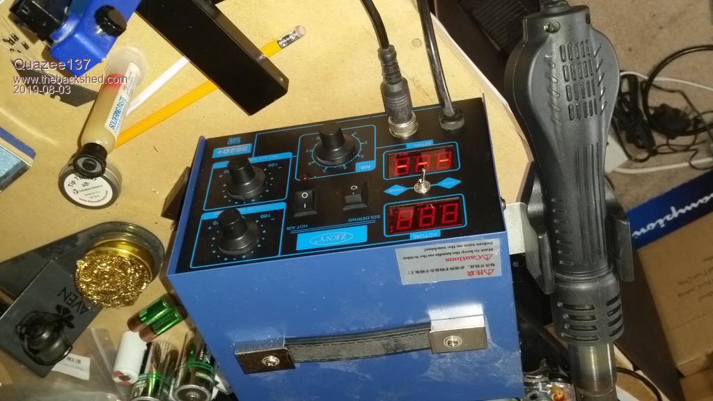

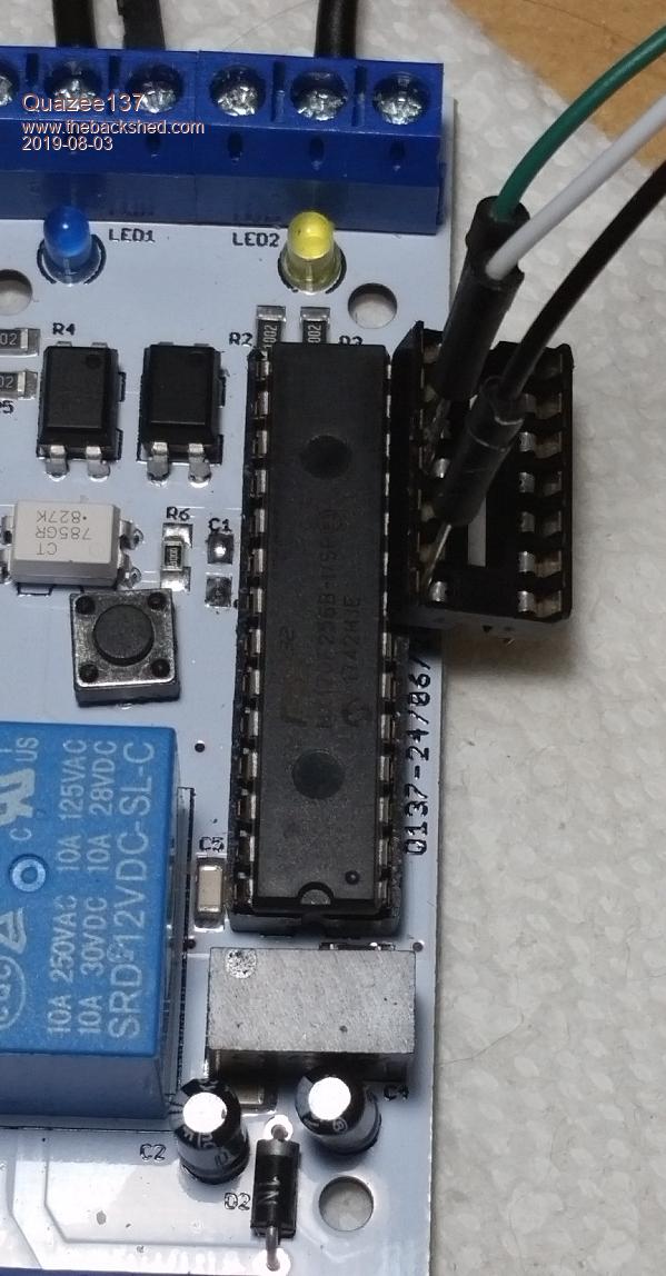

Posted: 04:55am 03 Aug 2019
Thanks Mick
It will be a few day before I can make use of them. The project that got
me looking into this is now in the assembly stage. Trying a new way to
solder the SMD parts and It's not bad at all.
My new best friend
and a few pic's of the work we did today.
there are two layers 20 sets of 3.
This my 2nd best friend.
And I needed to add a new test to the code with this cheat.
Pic's are from my phone and it has a mind of its own on orientation.
So glad I found this forum has make work FUN and a lot easier.
Well back to work
Thanks again Glenn is a GREAT job you've done and are doing.
