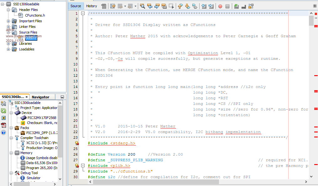

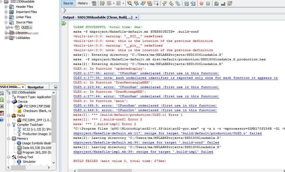

Sorry help needed.
When I clean and build I get these errors.
Any ideas please.
Please note,  I had to move Cfunctions.h up a folder level so it could be found otherwise there was a error for that as well.  Also in the code view there is a error that starg.h cannot be found.
Anthony.
Posts: 12084
Posted: 11:07am 03 Nov 2021
Replace cfunction.h with attached
CFunctions.zip
Can't help with srdarg.h as that should be standard C

stdarg.h was not a problem in the end.
Thanks for the updated cfunction.h, all has compiled fine.

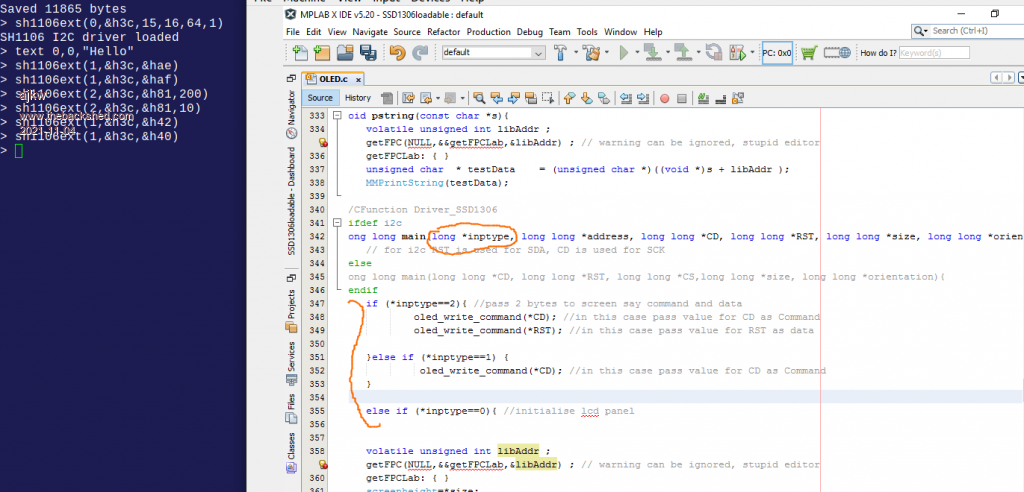

Step 2 is sending the contrast command and byte value.  With the all-Basic-driver you can access an internal routine of the driver (oled_write_command) to send it but am really not sure how you would get to an internal sub of a csub from MMbasic.  There are some other commands that can be sent that can scroll the screen vertically,  turn it on/off (saving the ram for when it comes back on) and inverse as well.  I'll keep looking but any help appreciated.
Anthony.
Posts: 12084
Posted: 01:02pm 03 Nov 2021
  Quote  but am really not sure how you would get to an internal sub of a csub from MMbasic.
Change the main function so it takes an extra parameter. Use this to decide the function you want to use. init, sendcommand, senddata

I can now send a command byte, and associated data byte where required, to my 1.3" 12C SH1106 from mmbasic via the loadable driver.
In this video mmbasic only draws the initial Hello World screen and then the rest is done via commands to the OLED.
You can change the
Contrast (0 - 256 but 0 is not black)
Turn screen off/on (preserving the ram memory for instant on)
Inverse the display
and
Scroll vertically up or down.  The screen wraps around.
Particularly with the contrast and on/off functions I will now be able to significantly reduce the burn-in that I have experienced with these screens.

I don't know if I have fully got to grips with cfunctions however I was able to make some changes and managed to compile them.  Works for me but I have had a couple of CPU exceptions from MMbasic particularly when first copying a new version of the driver.  Seems to settle.  Probably can be done better, hope it works for somebody else - no guarantee or warranty.
I have added a parameter that is passed to the driver to control its mode.
sh1106ext(x,i2c addr,pin,pin,height,rot)
0  intialise lcd, eg sh1106ext(0,&h3c,15,16,64,1)
1  write 1 byte to Oled  eg sh1106ext(1,&h3c,&hae) - turn off
2  write 2 bytes to Oled  eg sh1106ext(2,&h3c,&h81,&h7f) - set contrast
AE/AF Screen on / off
81 is contrast with data of 00 - FF or 0 -255
40-7F is screen offset
A6/A7 is Normal/Inverse
Previously to solve the 2 pixel offset I had I simply added 2 to x in this sub.
void OLED_setxy(int x,int y){
 x+=2 ; //move right 2 bytes
 oled_write_command(0xB0+y)        ; //set page address
 oled_write_command(0x10 | ((x>>4) & 0x0F))  ; //set high col address
 oled_write_command(x & 0x0f)     ; //set low col address
Library save it,  you can get CPU Exceptions if used in normal program memory.
