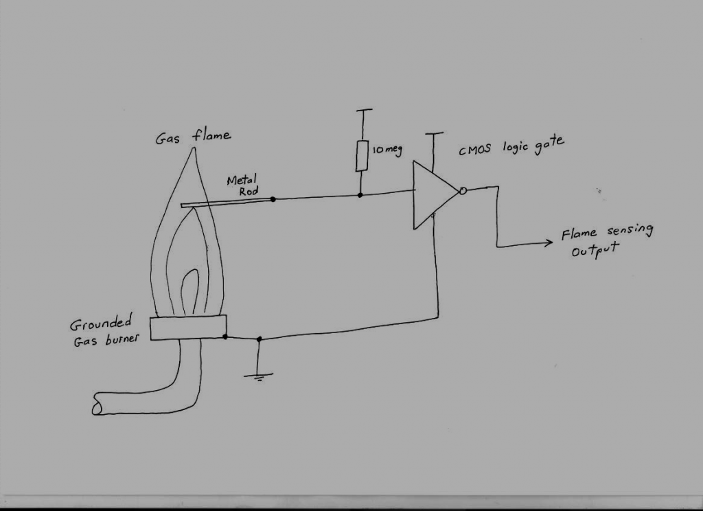

  Quote   have another possible option. Before embarking on this "project" I replaced the thermocouple (which I now suspect was OK). My DMM shows a change in resistance when I heat it (but I cannot trust the reading as it sometimes shows a negative value) - can I place that nearer the gas ring and get a more direct measure. How would the circuit look?
Thermocouples do not change in resistance, they generate a quite small dc voltage due to the "Seebeck effect". That is probably why your ohm meter went negative.
Try it again on the dc millivolts range.
The voltage generated is only going to be a very few millivolts at most, and much less convenient to use than a direct simple flame sensor using a stainless steel electrode which can much more usefully swing by several volts.
Thermocouples are used as flame sensors in some gas appliances that have no electronics or electrical power supply.
Although a thermocouple can only generate millivolts, it can source a few tens of milliams of current as the source impedance very low.
So the method used to initially light up the pilot flame is to manually hold down a lightly spring loaded button that opens the main gas valve. You then light the pilot flame either with a match or a high voltage piezoelectric igniter.
You wait a few seconds and release the button and the pilot light stays lit.
If the pilot is not lit or goes out, the main gas valve closes when you release the button.
The magic ingredient that controls all this is a thermocouple in the pilot flame, and a weak electromagnet that holds the main gas valve open. This electromagnet is energised by only the few tens of millamps coming from the thermocouple.
If the pilot light blows out (in a wind storm) the electromagnet releases and shuts off the gas supply.  Without that, the gas supplying the extinguished pilot light could build up inside the gas appliance and cause an explosion when someone tries to relight the pilot light.
The thermocouple involved is perfect for that application, but if you want to use it as just a flame sensor, you would need a very sensitive voltage detector that would detect the presence or absence of only a very few dc millivolts. Possible, but why do this the hard way ?
For gas appliances that do have a 230v electrical power supply, the flame sensor is much more likely to be a simple stainless steel spike in the pilot flame that often runs quite visibly red hot.

Posted: 01:56am 22 Sep 2019
A K type thrmocouple will certainly measure temperature, but it will quickly die in a direct flame above about 1250 Celsius.
Getting back to the thermocouple and relay idea, you can try it, but its a rather special and complicated problem.
The voltage is EXTREMELY low, so even measuring the current with a multimeter will be problematic because the current shunt and multimeter leads will probably have enough resistance to themselves reduce the current.
A relay needs far more grunt to operate than to keep it operated. You might find that a 12v relay requires 10v to pull in, but will stay operated until the voltage falls to perhaps only two or three volts.
These gas solenoids have few turns of amazingly thick wire (to keep the resistance down). And there is very little spring pressure of a hair thin spring in the solenoid to work against.
The valve is opened manually and the magnetic path closed with a push button.
The thermocouple only has to create minimal holding in power.
Here is a video:
https://www.youtube.com/watch?v=7m5ZDvOoVwU
I don't think any normal reed relay would be up to the job.
The thermocouple for it is pretty special too, usually uses platinum family metals that will not burn up or oxidise at continuous glowing red hot temperatures. They can be fairly expensive as well.
Its pretty simple yet also in a way exotic technology that has been around for a very long time.
Modern gas appliances usually now with a microcontroller just use a simple stainless steel electrode which is vastly cheaper and far less troublesome.
Edited 2019-09-22 12:17 by Warpspeed
