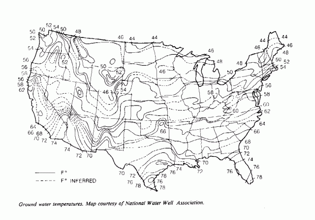

Uncle Sam sometimes can be a big help. This is a map showing thermoclines of the average deep ground temperature (in °F of course) everywhere. At a depth of 2 M the temperature will vary plus and minus 10°F from these average temperatures, +10° about September 15, -10° about March 15. I don't know if the Australian governemnt provides anything like this. (My house sits down there in that sharp corner of New York 4 miles from the giant IBM microprocessor fab, just about on top of the 52°F thermocline, so my annual deep ground variation is from 42°F to 62°F.)
I know very little about the annual seasonal air temperature variations or the annual seasonal variations of deep ground temperature you guys down under experience. Nor do I know how much cloud cover you have. (I seem to dimly remember that it was intensely sunny when I rode a train from Sydney to Perth back in 1949.) I therefore can't comment much about your attempts to collect solar energy.
I can stress that you should try to pick the lowest hill if you're going to try to pump heat up a hill. If anyone wants to really analyze heat flow in his house I'll be glad to assist if I can. Be forewarned that I will probably tell you a lot of Polack jokes at the same time.

The building is heated and cooled with a deep vertical well geothermal heat pump system, powered by the solar collectors, which can produce about 1,000,000 btu of heat during the coldest days of the year. There is a fairly well insulated concrete block cistern, 20' x 20' x 5' deep in the basement which holds about 15,000 gallons or 120,000 pounds of water. The geothermal system can raise the temperature of the 120,000 pounds of water about 8.33°F in one hour. In 6 hours of sunlight it will raise the temperature of the 120,000 pounds of water about 50°F sotring about 6,000,000 btu*hr of heat which is more than sufficient to heat the building for a 24 hour day. (1 btu*hour of heat will increase the temperature of 1 pound of water 1°F.)
The solar collector array was installed almost 20 years ago. The rows are aligned within a few degrees of north/south. The panels rotate 80° east at dawn and 80° west at sundown. If it snows enough to coat the panels they rotate 120°, upside down, and the snow falls to the ground.
This building purchases electric energy from the grid only for lighting and the police communication equipment. Heating and cooling has been completely derived from the solar panels for 20 years!

I can remember seeing an Aus ground temperature map, published by CSIRO. From memory it varied, with the range  decreasing down to about 2 meters down where it becomes pretty constant.
In Coober Pedy of course they solve the air-co problem by moving the whole residence underground - around a steady 23 deg C I think, summer and winter.
