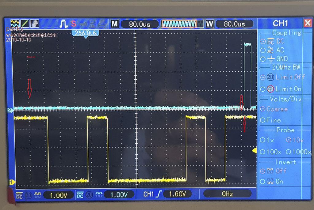

Regarding the interrupt timing, I ran the following code on a 170 and fed characters into it from a terminal.
The delay between the end of the stop bit and the Rx interrupt service routine activity starting was around 80uS - it varied a little by 5uS or so and this is because there is no way of determining EXACTLY where in the do/loop sequence the interrupt occurs.
This is exactly in line with what you would expect as each MMBasic line interpretted takes on average 30uS so the jump to the interrupt service routine then get the character with INPUT then pulse the pin ~ jump time + 30uS + 30us.
If you omit the INPUT statement, the lag is less than 10uS between the end of the stop bit in the received character and the leading edge of the pulse
This is absolutely repeatable so any delays in servicing an interrupt are solely due to what other activities the 170/MMBasic is trying to do at the time the interrupt occurs.
Looking at the interrupt priority order, only higher priorities will break into the processing of the COM interrupt service routine.
SETPIN 18,DOUT
PIN(18) = 0
OPEN "COM1:9600,512,COM_Int" AS #1
DO
LOOP
SUB COM_Int
 A$ = INPUT$(1,#1) ' with this statement in, lag is roughly 80uS
 PIN(18) = 1       '  - with it out, lag is less than 10uS
 PIN(18) = 0
END SUB

Hi Panky
very good job! thanks!
my problem is that I receive 470 to 500 bytes each second. And I must do something with this byte (not only read). Minimum to do is to store, and after that, background tasks can work with frames stored in asynchronuis time, they have time to do that. In industrial realtime process it work (very well) like that (see modbus protocol with 128 byte max for each frame)
my minmal subroutine

if time to execute 1 line basic, is 30us, I don't understand.
You can see that in recept, I have just to know where are begin and end of frame.
It mean that for first byte, I "use" 18 lines (18*30=540us) each millisec, for last byte i "use" 12 lines (13*30=360us) each millisec, and for all others byte I "use" 240us (8*30us) each millisec . It mean that during reception of all frames, I have 50% to 75% time free to continue my others tasks. In this case, why main loop is executed in 600ms??
remenber that in realtime, execution time of 2 tasks is not an simple time addition of each, but it depend of free time given by most priority task. If main loop task execute routine in 100ms and priority task use 50% of CPU time, that mean that main prog is executed in 200ms, if priority task use 10%, main task execut in 110ms. In my case com sub give (max) 50% free time. it mean that my main loop must be executed in 100ms when i receiv frames, and in 50ms when there is not frames.
tomoroow I connect my scope, and I put pin relay at "on" in begin of routine com, and at "off" on exit sub, to know how many time I spend in my sub
