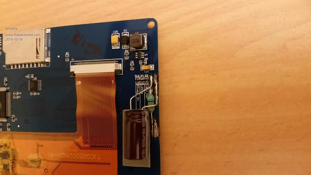

Probably better if the board design had the Analaogue Ref and Ground pins brought out seperately.
Boost converters are the hardest to filter as they draw very peaky currents on their input side which is probably what you are seeing on the scope. Doesn't matter what caps you put on the input side. Boost converters generally need LC networks comprising a couple of poles. This requires calculation.
I'm with Peter on this one. Ditch the converter on the display and feed with a cleaner 5V supply.

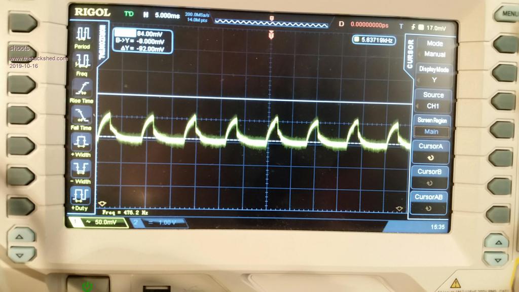

I don't have a problem with SMPS. I use them a lot. The switching does cause small, very sharp pulses due to stray C. The main current however should be reasonable i.e. a ramp up - down, in an ideal world that is.
The problem shoots has is his power supply is not able to provide sufficient current so it collapses. It is possible that his display is faulty and drawing too much current.
A nice big C will prove / disprove this idea.

So the state of play is...
I found the issue did not change regardless of power supply or battery size. It is definitely related to the backlight's boost circuit.
I ended up following Brian's suggestion and cut the track on the line supplying the backlight circuit and inserted a 15uH inductor in line with that supply and put a 1000uF electrolytic after the inductor to ground. This improved the noise situation considerably from around 700 mV p-p to approx 50mV. I think I can live with that. I have done this to two of the touchscreens in have and so far no problems. There is about a 0.2 V volt drop across the inductor which has not affected things at all. Trying to get the noise down lower resulted in too much volt drop and affected the screen's performance.
In case others have a similar issue I will post a shot of the resulting noise and the modification to the screen:
I also implemented a exponential smoothing of the analog input which made a significant difference. A few good notes on this are at:
https://www.megunolink.com/articles/coding/3-methods-filter-noisy-arduino-measurements/
BTW I have been using megunolink for plotting the data out of the MM using a spare serial port and it has made life easier for tuning.
I wonder if anyone has used a 5" touchscreen of a different brand to the one pictured which is from AliExpress? I have seen another brand but I have doubts that its pinouts will match the express 100 PCB.
Thank you for your advice guys. This has been another good learning experience.

I would not run any switching regulator (backlight supply) from the same bus as the processing circuitry - just asking for trouble especially with ground loops.
In other words, a separate supply for the backlight (a pain I know...)
