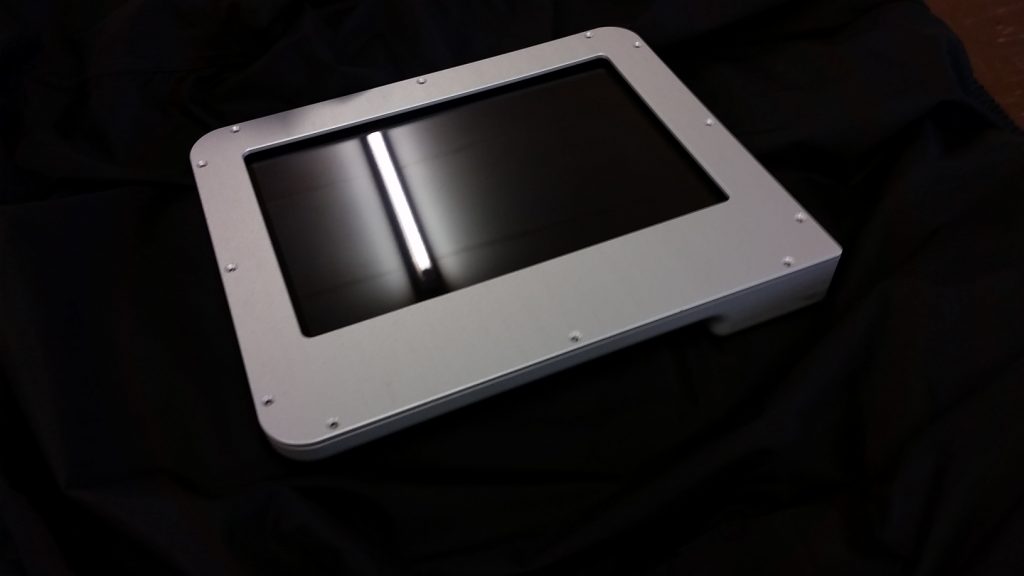

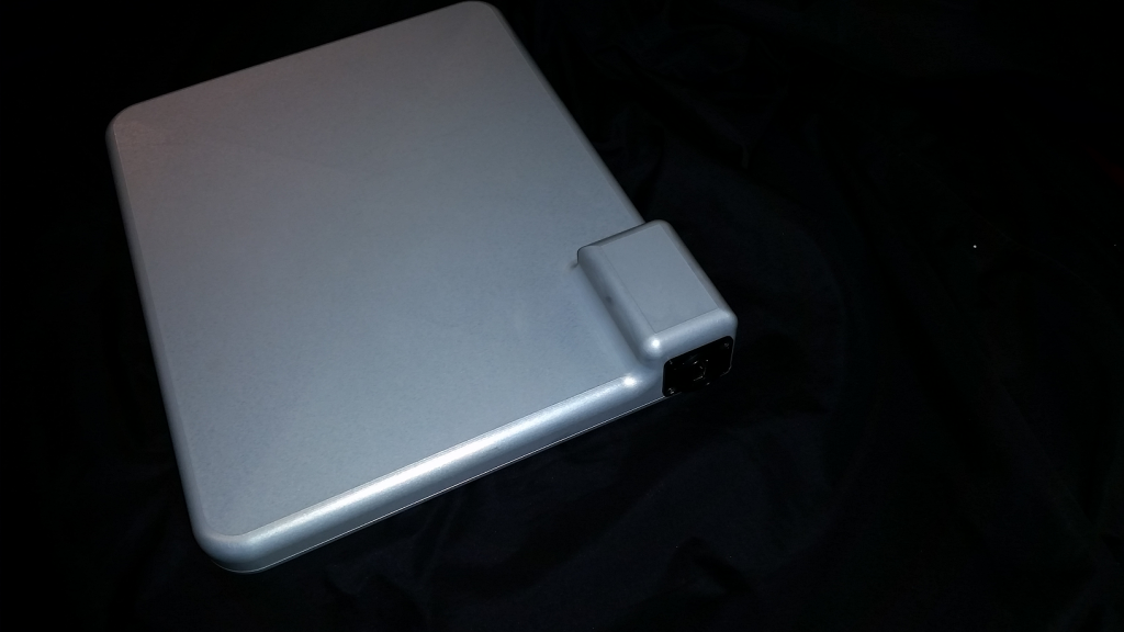

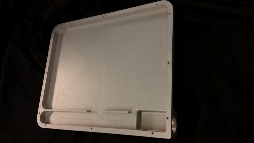

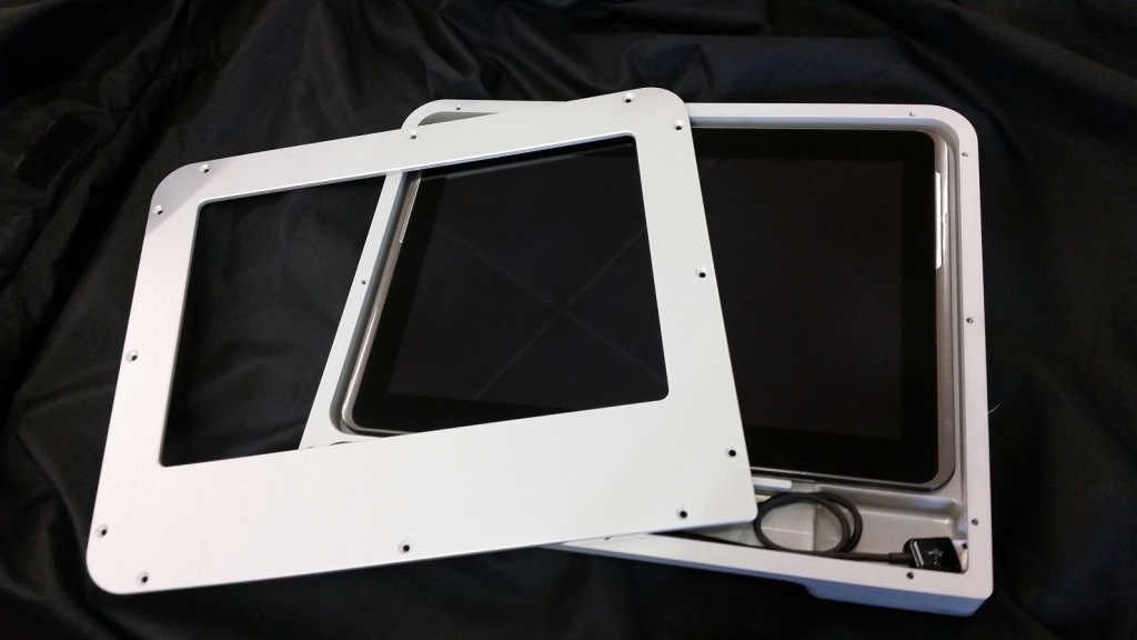

I had considered ToughPad (I have several ToughBooks) but just not tough enough for my liking:
A nice, beefy Neutrik locking USB connector....much more resilient.
I have another batch of these enclosures going through right now but these will be black anodized.
I don't touch Linux but I code for Android and it is just as easy as MM-Basic.
