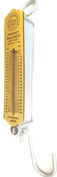

Was looking a cheaper way to detect a low cylinder. Cylinder scales looks a bit expensive from what i've seen.
Was looking to make a DIY cylinder scale, but don't know where to start.
Any suggestions on how to do this?
Also, good to know. Will write some lines on arduino so it will keep the engine turned on for 15 minutes for cool down.
Also, i will try to find the hottest spot on the generator chassis to find its temperature. If too high, arduino can low the RPM and low the amperage or sound any alarm, etc.
With the fantastic help of everyone, i think i will make the most reliable & cheap generator running ever seen.
Posted: 06:50am 19 Nov 2019
The real cheapy Mickey Mouse way, would be to use an ancient spring scale, and a slider potentiometer.  It should cost like nothing to make, and give 0v to 5v output.

  Warpspeed said  The real cheapy Mickey Mouse way, would be to use an ancient spring scale, and a slider potentiometer.  It should cost like nothing to make, and give 0v to 5v output.
This is a good idea.
Will try to find those locally. They look cheap.
Thanks, Warp.

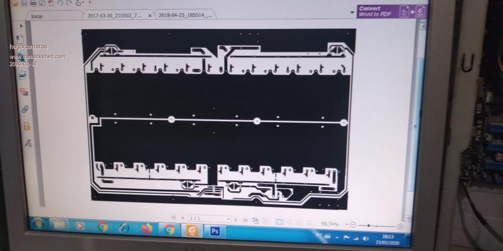

hugocamaras
Joined: 12/04/2019
Location: Brazil
Posts: 24
Posted: 09:09pm 23 Mar 2020
E ai? como está a montagem com a placa Mad?

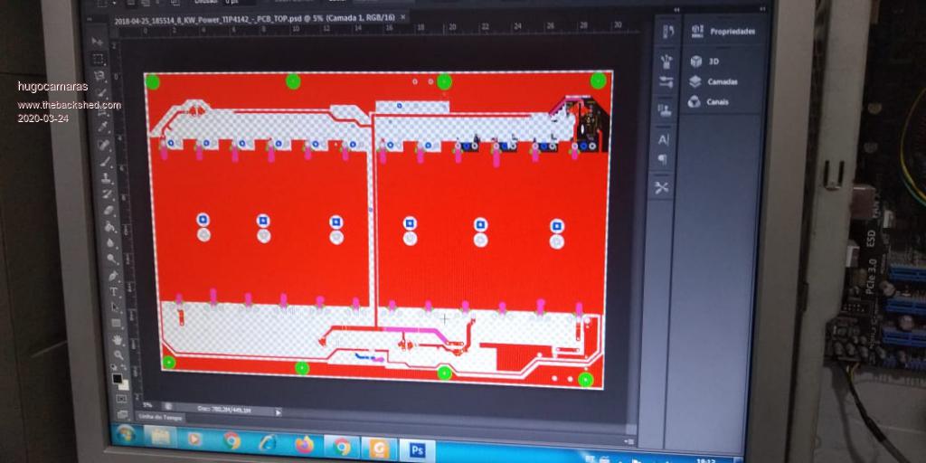

hugocamaras
Joined: 12/04/2019
Location: Brazil
Posts: 24
Posted: 09:23pm 23 Mar 2020
E ai Artur, estou tentando limpar uma imagem do layout da parte de cima da placa de potencia do Mad mas está dificil. kkkk Estou quase terminando de limpar com o Photoshop mas não sei se está correto essa imagem e as trilhas da parte de cima. a de baixo o Mad já tinha postado pdf pronto. só falta a de cima. tem como vc me dar uma ajudinha? (33)988161426 whats e telegran. desde já agradeço.

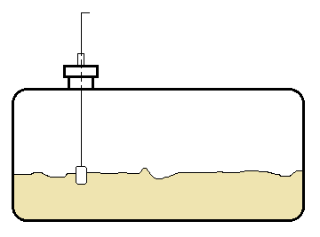

Pete Locke
Joined: 26/06/2013
Posts: 186
Posted: 03:59am 24 Mar 2020
A simple 'No Batteries Required' tank level indicator can be made with a wire and float. Used a lot on small home built aircraft.
Pete'.
