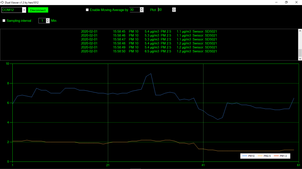

Posted: 10:57pm 01 Feb 2020
OK,
I've got the sensor running by using the supplied USB connector and some free Windows software from here.
This takes the binary data from the SDS011 and plots a graph of P10 and P2.5 readings over time (on the PC). (I've not mastered it by any means)
Now "all" I need to understand is how to dispense with the TTL to USB connector and communicate with a MM (I'll probably use another LCD Backpack).
Jim's pdf's above seem to explain it all - but are a little beyond me (particularly communicating via serial in hex (I'm used to ASCII strings)).
(any tips welcome . . .)
