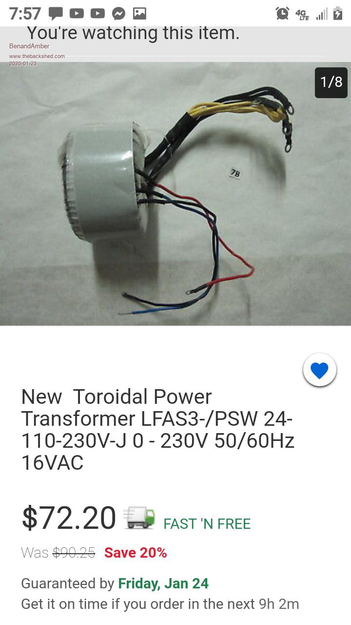

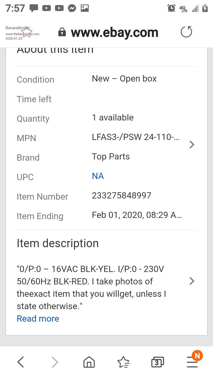

I keep an eye on eBay for Transformers
I seen this one down to $55 last time they List It
If you offered them 55 bucks I'm pretty sure they'll take it
I'm still not sure where you live so may be helpful maybe not

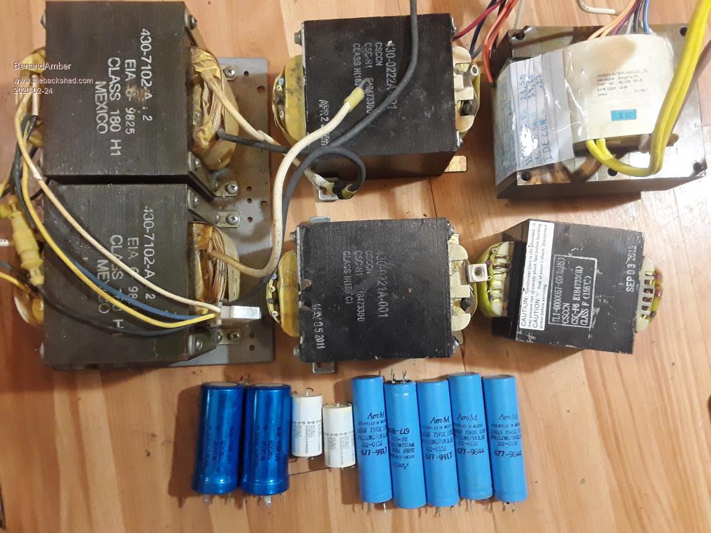

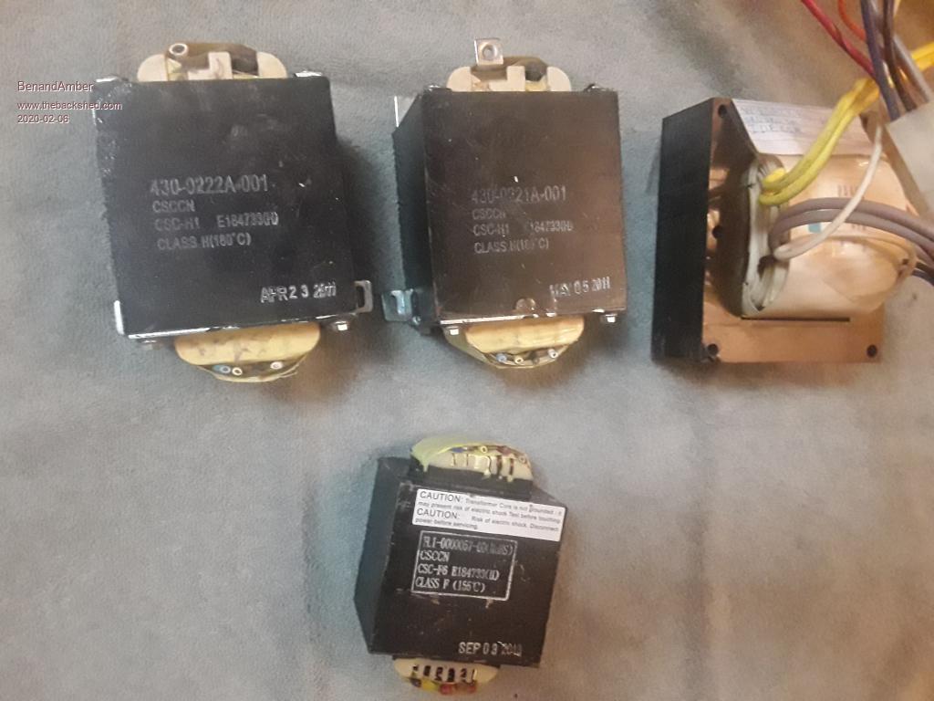

BenandAmber
Joined: 16/02/2019
Posts: 961
Posted: 12:35am 06 Feb 2020
If you need a Transformer I have a few square ones
I'm not sure how expensive shipping would be may not be worthwhile to you
But I would be glad to give you a Transformer
I may have a few other things you could use also

BenandAmber
Joined: 16/02/2019
Posts: 961
Posted: 09:28pm 23 Feb 2020
I sent you a private message
I have a few other ones also
The two that are bolted to the same plate on the left I would guess weight 50 lb
Edited 2020-02-24 07:33 by BenandAmber
