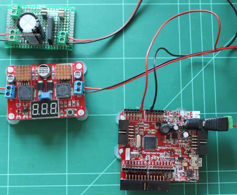

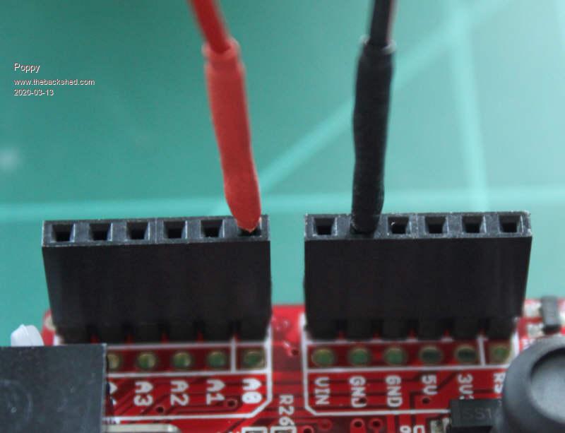

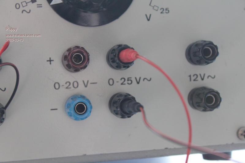

I made my setup for powering it and I have a question concerning the grounding, so not to fry it all up ... having not enough experience with MCīs on AC-issues ... actually none till  now
I will use a different transformer, to be able to power the Duinomite up parallelly (via a fixed 6V outlet, AC but rectified and regulated, see Pics).
Now I want to use the two wires from the 0-25VAC to measure, the red one to AIN and the black one to the Duinomiteīs GND.
Of course the V-Divider is missing, I am just talking generally!
Is the grounding correct?

Are you absolutely sure that your AC supply is fully isolated form the mains?
There's going to be enough funerals in the coming months without adding one more.

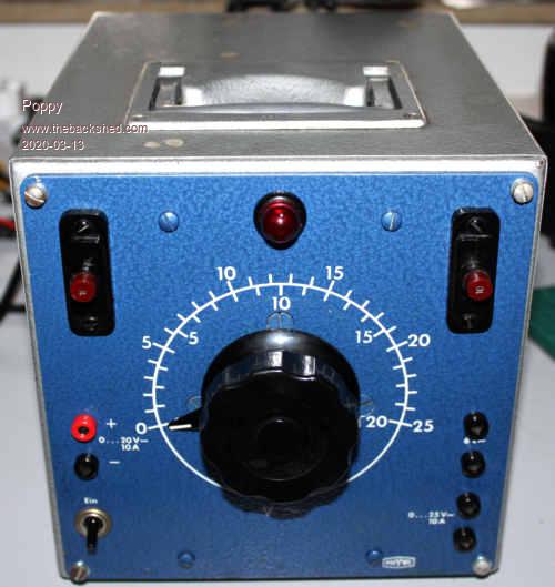

Posted: 07:31am 13 Mar 2020
I know. And thanks for caring!
It is a bit controversial, but as much as I interpret the old symbol on it independently ... on first sight it seems not to be, but technically it is (being checked!). It also is a former school-lab transformer (from the 80īs or 90īs, I guess) complying with certain practical standards (but apparently not following current labeling). Additionally I always have a 30mA-RCD set between in case mains could unexpectedly break through myself to ground. Generally I also do have some 230V-Isolating Transformers I could set between to separate from mains grounding, but I rather prefer RCDīs.
I also own some other older low voltage supplies being checked up for isolation as well, but not  having an old-standard and therefore confusing symbol on them.
The following first 2 ones are from old Western-Germany and the last one from old GDR, but all are in good shape and of great solid quality.

PS:
My question concerning grounding the DM was not about frying it (and myself) up with 230V mains but 25VAC.
Edited 2020-03-13 17:39 by Poppy

Hi Poppy,
Just make sure the AC input signal you apply to the Duinomite is not electrically connected to the voltage you use to power the duinomite (*).
Best is if you use 2 different boxes (you seem to have plenty of them), and make sure they isolate from the mains.
(*)= the AC voltage you measure is directly connected to the GND of the Duinomite. The power you use to power the Duinomite is rectified, then regulated to 5V. If both are connected in anyway, you bypass the rectifier -> smoke....
Therefore, use 2 different transformers for power and measurement signal.

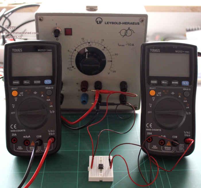

Joined: 25/07/2019
Posts: 486
Posted: 01:24pm 13 Mar 2020

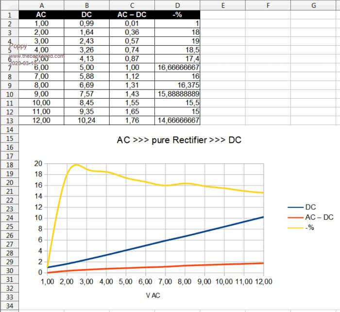

  Poppy said
Could it be as simple as measuring DC behind a rectifier and calibrating it down to the original AC value?
For the sake of some junior grade physics I just made a little setup, showing lacking accuracy and practicability ...
Simply measuring RMS before a single bridge rectifier and DC after it.
Andre ... such a GURU?
Posts: 6168
Posted: 03:15pm 13 Mar 2020
Hi Poppy,
Interesting measurement results, but question is ...
what are you trying to accomplish ?
In essence, the bridge rectifier will change the sine wave into a rectified sine wave.
But it has diode forward voltage drop (depending the current).
The multimeter presents a very high impedance load, so the current is almost 0.
Because of this the forward voltage drop of the rectifier will be completely unpredictable.
Secondly: the multimeter that supposed to measure DC, performs some kind of averaging. But since that is not documented, you are not sure what it exactly does. A fast multimeter will jitter a lot, a slow multimeter does ..???
Anyway... nice photo and graph of the experiment.
I am sure the duinomite will do a better job with accuray...
Volhout.
P.S. make sure the TOUGS M202 multimeter actually measures RMS. Some cheap multimeters measure peak, and divide by 1.4.
Poppy
Joined: 25/07/2019
Posts: 486
Posted: 03:44pm 13 Mar 2020
Simply comparing different approaches free of any prediction, just a philosophical matter ... simply having some short fun with it while preparing different issues.
The rest you constructively point on are clear, but that was not my task, sometimes I just want to actually see something in reality.
You are right, havenīt actually checked them, so relying on something being unquestioned goes against my maxim, but for my modest demand they have been doing a fair job so far.

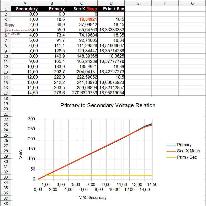

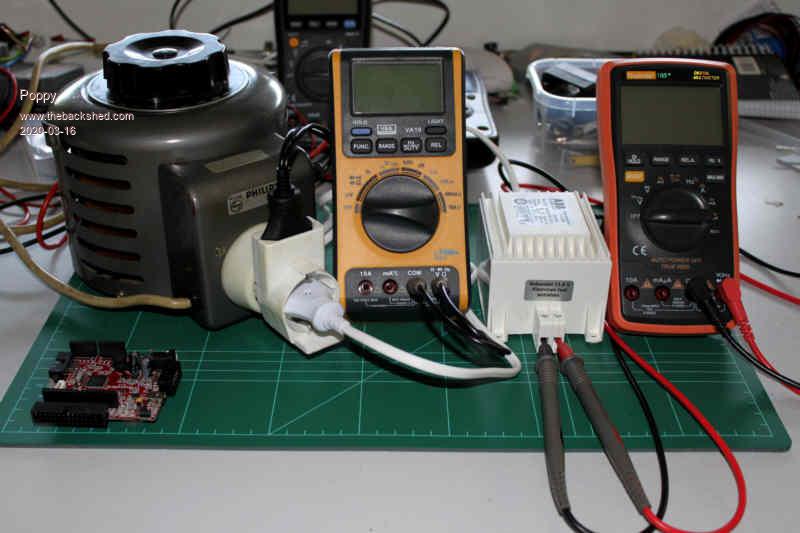

Posted: 03:16pm 15 Mar 2020
  Quote  For the sake of some junior grade physics ...
Yeah, still rocking!
Making another short stop on my way finally frying my Duinomite
Just for the sake of some more practical visualization concerning the linearity and therefore opportunity to conclude the primary voltage by exclusively measuring the secondary ...
My setup is a safety transformer (mains to "12VAC", the white block) being regulated on the primary side (by the Phillips) and being measured parallelly on both sides.
Disregarding some impreciseness it is quite obvious, probably using 2 "AC-Sensors" parallelly both could be calibrated against each other.
Posts: 6168
Posted: 07:53am 16 Mar 2020
Hi Poppy,
Thedifference between the orange line versus blue line is due to saturation of the iron core of the white transformer. Typically transformers are designed to handle 220/230V + 10%, but at +20% they start to show losses (they also get warmer).
P.S. the Philips transformer does not suffer these losses since it is connected to a solid 230V. You only vary the tap on the output winding.
