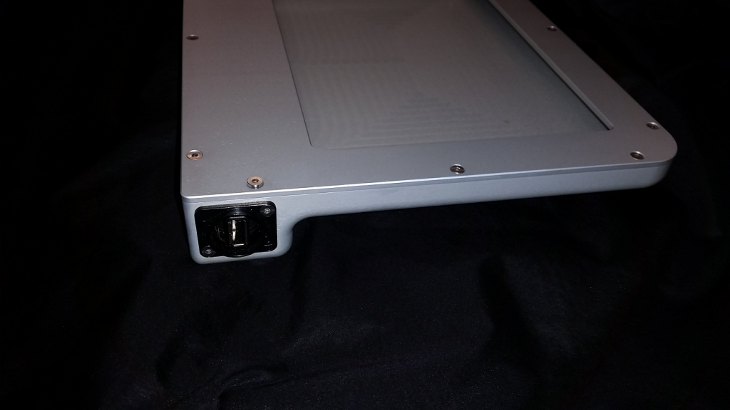

USB ain't balanced either.
I much prefer RS232 for the industrial environment because I get a D-sub connector with screw or clip retainers.
This is what I have to do with USB or it wouldn't last 5mins:

I like your housing. Can you provide more info please (using correct English of course).

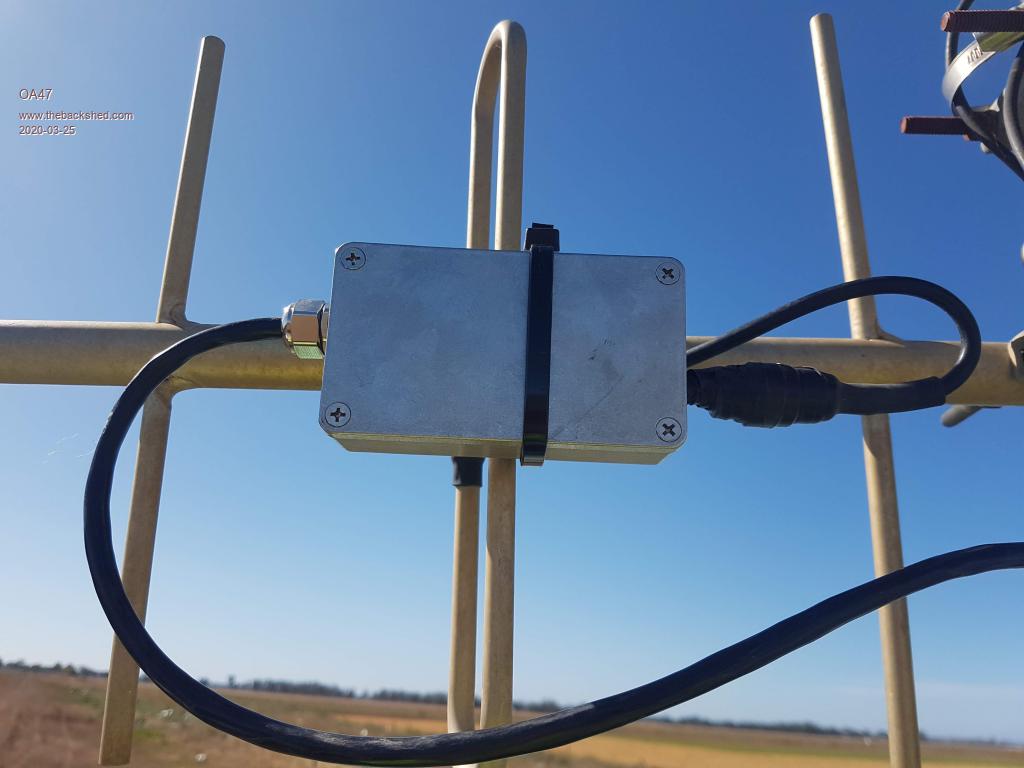

Been interesting seeing where this post has been going and the discussion it has provoked. I did mount the transceiver on the yagi although the bracket I intended to use was unsuitable for the mounting position ( I will modify it so I wont be relying on the cable tie)
I will monitor the records over the next week and see if I have cured the problem.

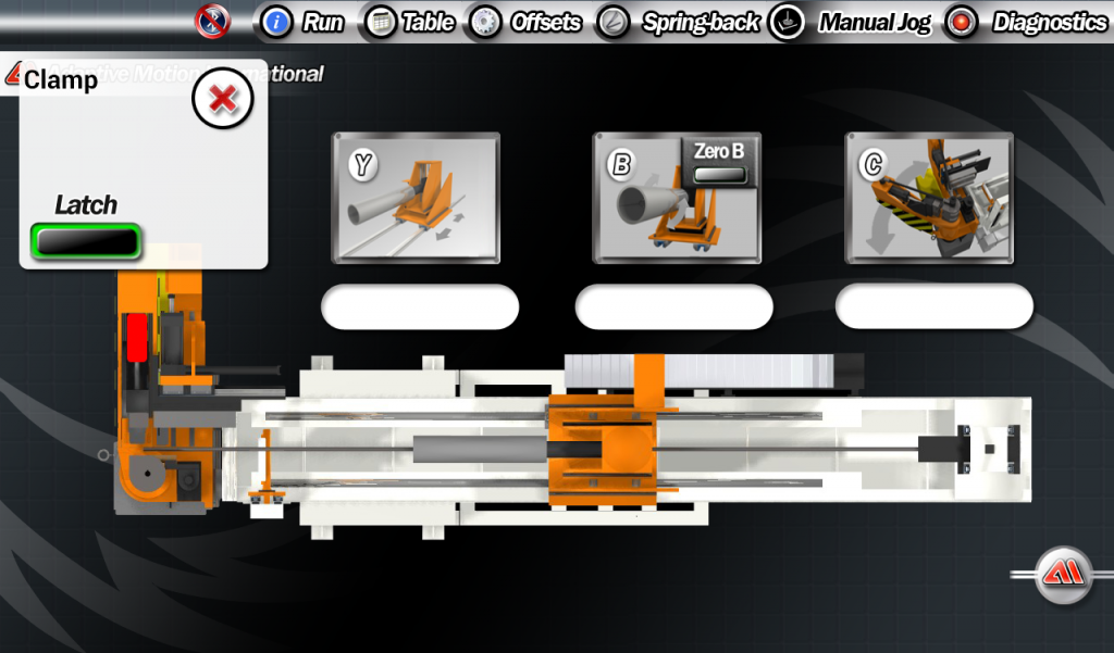

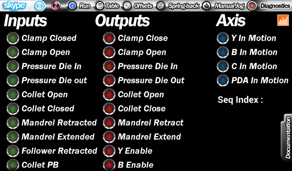

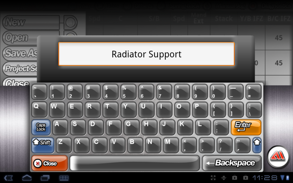

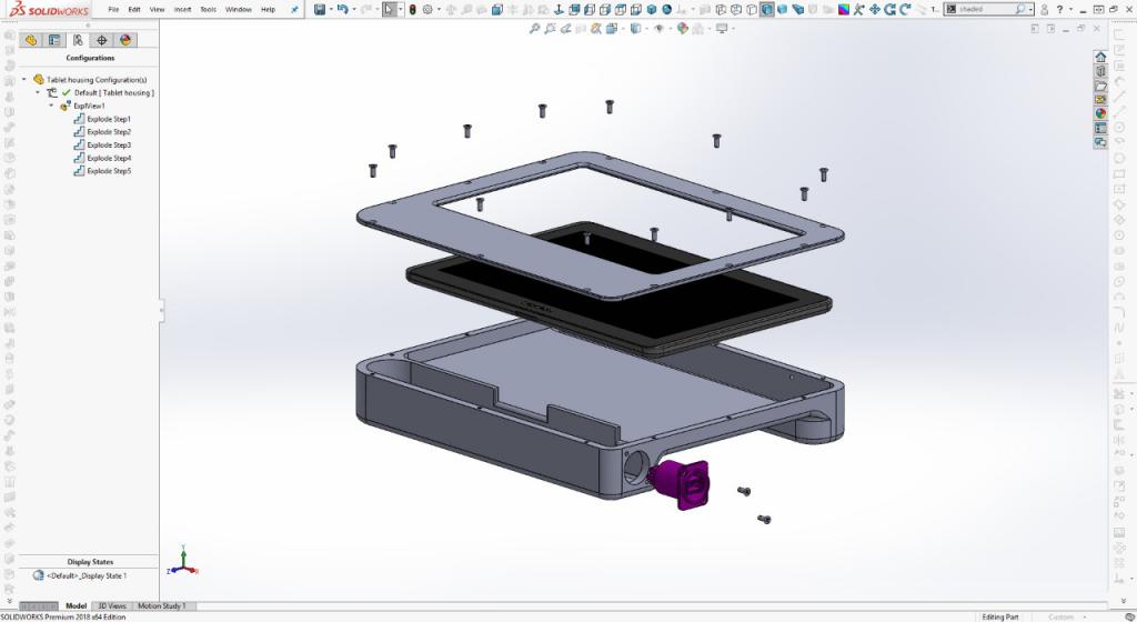

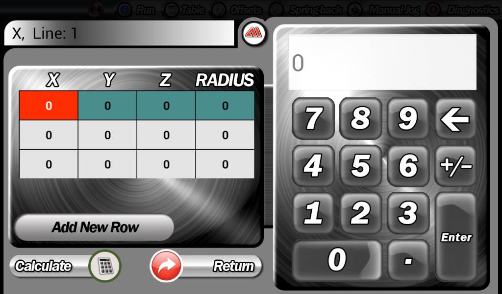

Enclosure:
The front-end for my control system is an Android tablet.
There are plenty of rugged tablets out there but they all have the hokey USB connector which is the first thing to fail.
I carve my enclosures out of solid aluminium/aluminum   and fit them with a panel-mount Neutrik USB connector.
The connector is only for power, no data.
The end result feels/looks like it was built for the military.
My controls end up in pretty rough/grimy environments. The most common failure, in my industry is the HMI and downtime is not an option.
I have clients who have had to wait weeks for a replacement panel PC from Siemens or Beckhoff.
My HMI is a simple download exercise followed by a Bluetooth pairing and the machine is back in production.
However, it's been 8 years with installations all over the place and zero reported failures.
As it happens, I'm in the middle of another installation in Oz. The client connects the hardware and I take care of debug, setup/calibration, usually from my bed, here in the UK.
Android devices are the ultimate HMI!

Thanks for that. It is not a $5 off the shelf item but it looks good.
