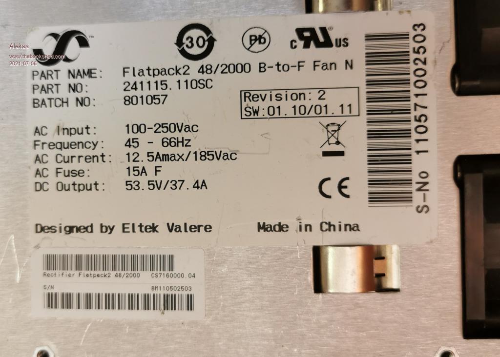

There has been some progress with code for the parallel of Elteks project.
I have two 2kW HE Eltek Power supplies.
I can run both as one.
The code needs you to put your Eltek 2kW HE serial numbers into the data at the start of the program. Read the label on the PS and copy that 6 byte hex string into the
array. Put it into the first 6 bytes of a row.
See the byte array named "login"
I have left the serials of my 2 PS's in place in the code.
Also you have to tell it how many PS are present.
look for the line where
#define NPS 2
change this to the number of your PS's you have.
Wiring is simple.
All PS's CAN HIGH are connected to the CAN HIGH input of the MCP2515 module
and all CAN LOW are connected to the CAN LOW of the module.
All CAN ground are connected together to the MCP2515 module ground.
Use the jumper to connect CAN HIGH to CAN LOW with 120 Ohm resistor.
It can run up to 4 PS's which means a device that can drive about 160A at 43V to 57V
with Constant current or constant voltage control.
You start in CV mode, so you rotate the encoder to choose an output voltage.
press the button and then choose an output current.
(the current will be spread between all available PS's. If you dial up 40 Amps
and have two PS's, then each PS will deliver 20 Amps. If you have 4 PS's then
each PS will deliver 10 Amps.)
The Eltek 2kW HE PS can only drop it's output voltage to about 43V when it is
attempting to reduce output current. Once it gets to 43V it does not drop further.
This limits how useful the CC mode can be.
Also it limits how useful the CV mode is.
But it is pretty good fit for Lead Acid battery charging.
here is a video:
https://youtu.be/Ril49CN12mw

Attached is a sticker from my power supply.
What is a serial number here, because there are more numbers that look like SN
disco4now
Joined: 18/12/2014
Posts: 1158
Posted: 12:02pm 06 Jul 2021
The serial no is next to the vertical barcode in you picture. Take the digits 2 at a time to give you the first 6 hex numbers, then add two 0x00 to make up the rest. So I think it should be:
unsigned char login[8] = {0x11, 0x05, 0x71, 0x00, 0x25, 0x03, 0x00, 0x00};
F4 H7FotSF4xGT
