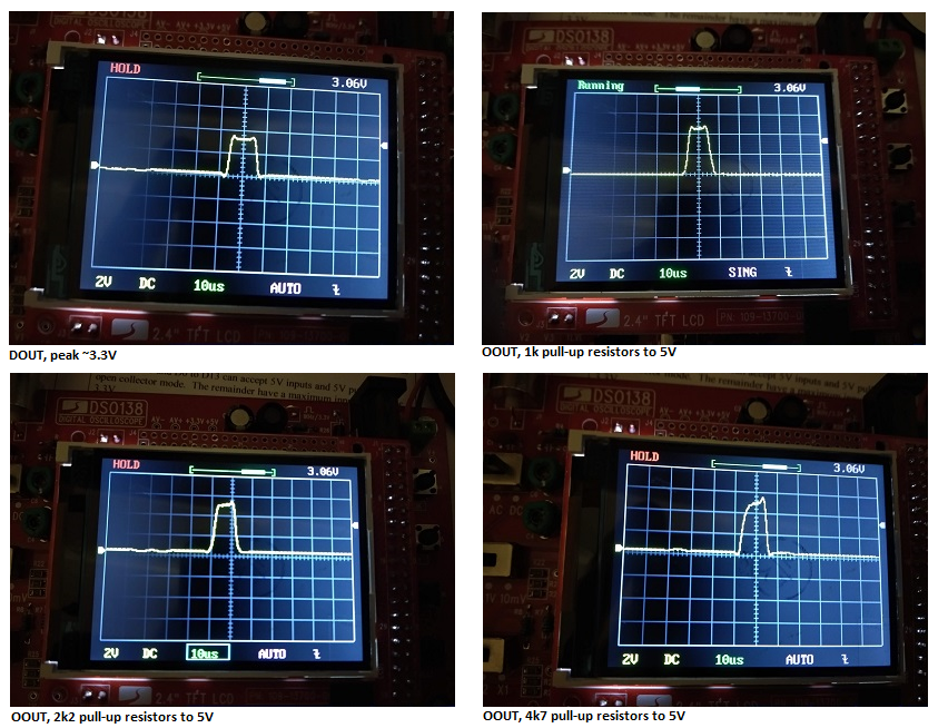

Posted: 09:01am 11 Apr 2020
Hey Bill,
I haven't been able to let this lie, perhaps I should?
Increasing the pulse length doesn't seem to have any effect, and
looking at the datasheet for a CD4021B (assuming I read it correctly)
the minimum clock pulse width at 5V is 180 ns, comfortably less
than the 12 us I am using.
Incidentally my DSO shows that the pulse width for:
Pin(CLOCK) = 1 : Pin(CLOCK) = 0
Is ~60 us on my Colour Maximite. This is however presumably
hardware dependent which might be a good reason to consider using
Pulse instead since that should presumably have hardware independent
behaviour.
In the absence of a better explanation I'm wondering whether the
problem is the pulse shape (presumably the gradient of the rising
edge). As the shots I've grabbed below (apologies for the quality
I only have a rudimentary DSO) the pulse definition becomes worse
as the resistor value increases. That said the difference in
gradient doesn't look significantly different and even at 4k7 the
clock rise time still looks less than the 15 us the datasheet
specifies ... again assuming I'm looking at the correct thing.
Turbo46
Joined: 24/12/2017
Posts: 1694
Posted: 10:38am 11 Apr 2020
Hi Tom,
It seems clear that it is not the pulse length that is the problem. I think you are right and the problem is the rise time of the pulse although all examples of your traces look well withing the 15us rise time and the required logic levels.
You don't say where your traces are taken from? They may not be much different at the Maximite end but could be different at the CD4021 end after the capacitance of the cable and that of the input gate has it's effect on the edge of the pulse.
I would be checking the cable resistance from the Maximite to the CD4021 including the connector and checking that there is no difference between the 0v at the Maximite and the controller. Or I might just say blow it, 1K works so I'll use 470R just to be sure and leave it at that.

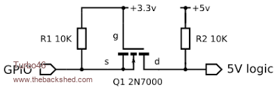

Posts: 10048
Posted: 02:50am 12 Apr 2020
  Bill.b said  Hi all
I have found these devices useful when interfacing to 5v  ws2812 LED strip lights
Here
Bill
I was waiting for someone to mention those things!
I have used those once or twice, and they work great for 3v3 pins.
Matherp's OC output on 5v pins is fine for 5v pins, but if you don't have any 5v rated pins left and still need to interface bidirectionally between 3v3 and 5v, these little things are just the ticket, and cheap at about $1 each little 4-channel board.

PeterB
Joined: 05/02/2015
Posts: 669
Posted: 04:03am 12 Apr 2020
Bill Grogster et al
Those level converters use a simple FET in a clever configuration. I will now try to remember the circuit.
Peter
edit. So I googled FET level converter and circuits popped up.
P
Edited 2020-04-12 14:07 by PeterB
Turbo46
Joined: 24/12/2017
Posts: 1694
Posted: 04:46am 12 Apr 2020
Ah, thanks Peter.
I Googled 'FET level shifter' and there are lots of them like this.
Bill
